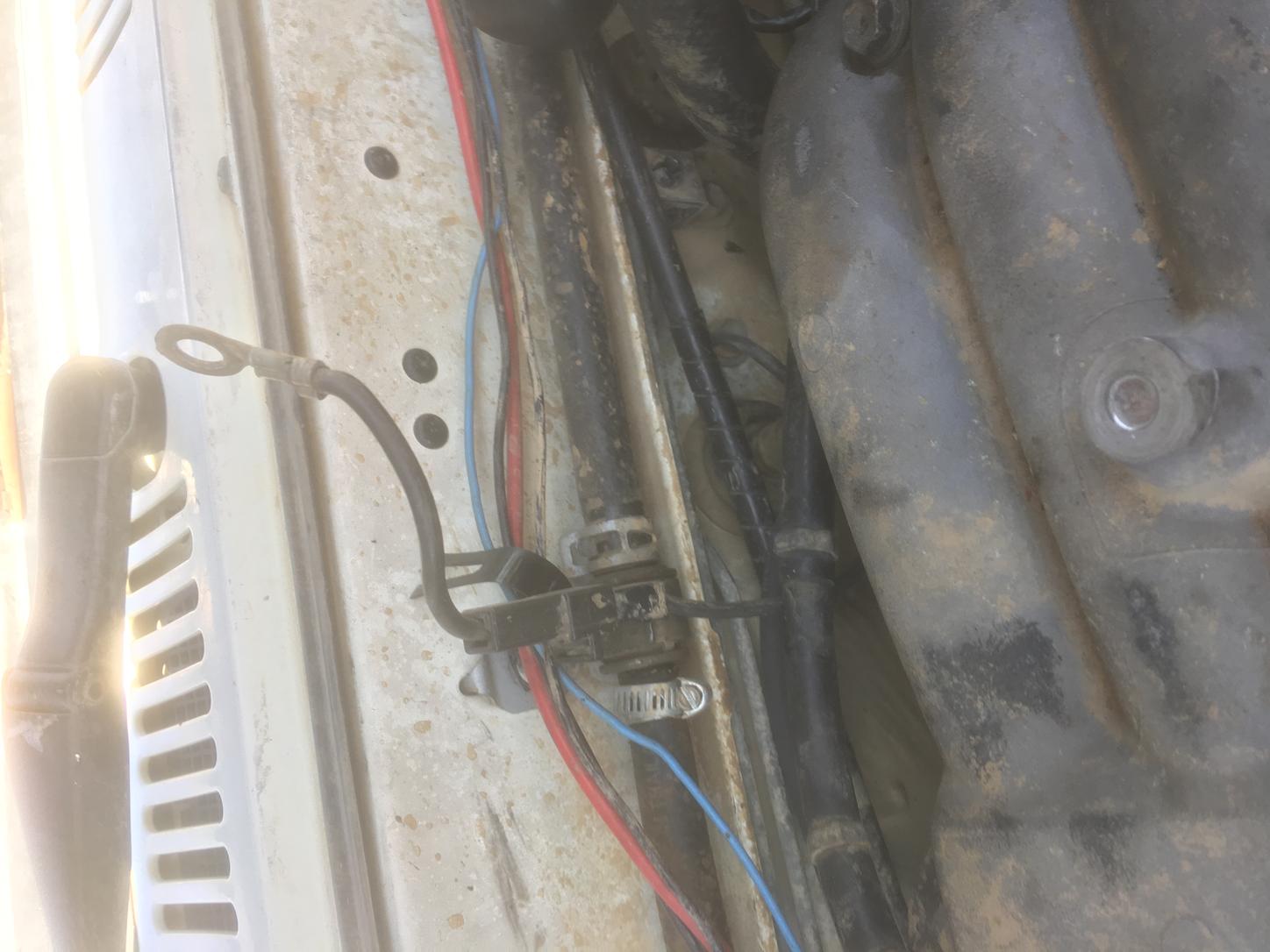

So I went down to my pops house this morning to work on the truck, and I notice this ground was off and the bolt was snapped off? So I reconnected it to the top of the motor, left the broken bolt in. And now I'm getting code 41. It is for the TPS, so I gotta re adjust that. And it should be running like a champ now

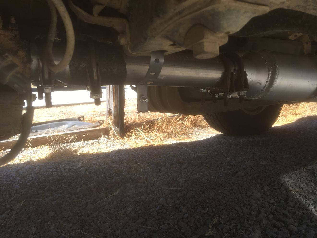

If you all where woundering what my shitty exhaust looks like. It was a little rusted so I had to kept adding peace by peace. Will be getting another whole exhaust built from the Y-Pipe to the tail pipe.

I swear that wasn't like that, last weekend But it seem to affect the way the motor cranked or worked in general.
