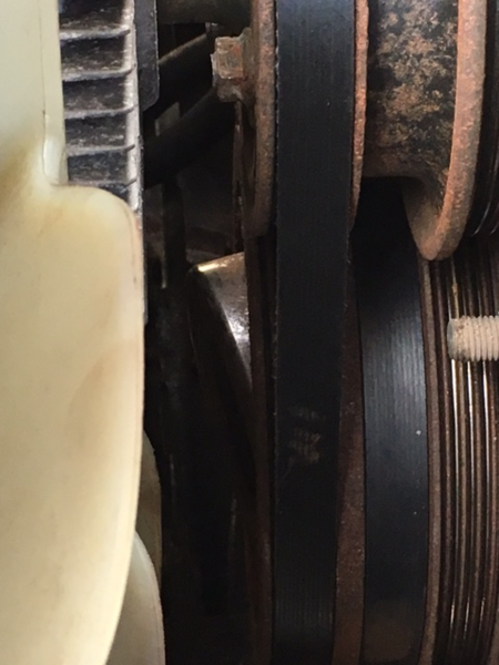

Happy Sunday all! I have a question on driving my broke 97 Limited back up to my local garage less than a mile away. Here's the story:
A few weeks ago I purchased a 97 Limited with 111k on the clock. Not knowing whether or not the timing/water pump had been changed I decided I would go ahead and do it. Made the appointment and the work was completed Friday, picked it up Saturday. Today I drove to the grocery store and back home and then up to fill her up. When I started it back up it made this gawd awful noise like the fan was hitting the shroud or something but more metal sounding. I babied her home (again less than a mile) to find that the fan was fine but the damper part of the crank pulley had separated/broke. I literally pulled it out with one finger. So now, obviously this needs replaced and I have to take it back up there, is it going to be ok to drive? What could happen? Thanks in advance!
It appears that the metal piece where you can hold down the crankshaft separated from the pulley, you are going to have source a new damper, i dont recommend getting a used one.

Hello All,
This is my first posting to the site and I was very excited to find this thread with the exact same issue I had yesterday with my 98 / 3.4 / 286K miles. Just like in the original posters message, I was moving my truck in the driveway when I suddenly heard a nasty sound like the fan was rubbing on something. I got under the hood and was looking at all of my pulleys and belts when I noticed the metal inner ring of the crankshaft pulley as seen in the original posters picture sitting half way out from the pulley haha. I attempted to pull it out with my finger and it dropped down onto the skid plate where I have yet to retrieve it from. After doing a bunch of reading and considering there is aftermarket light weight pulleys available, is it safe to assume that running the truck indefinitely without this heavy chuck of metal on the crankshaft pulley will have no I’ll effects on the engine? I don’t foresee any timing belt changes before the truck heads off to 4Runner heaven. Please help me out with any advice as I do not want to replace anything that I don’t need to as the frame is really starting to go.
Most people wouldn't notice if it fell off...run it and if you happen to notice any new noise or harshness replace it.
