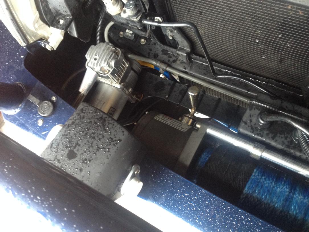

Engo 12000 synthetic winch with wireless remote

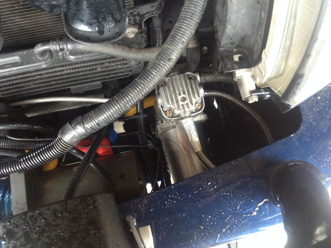

Viair Extreme duty double compressor in front bumper

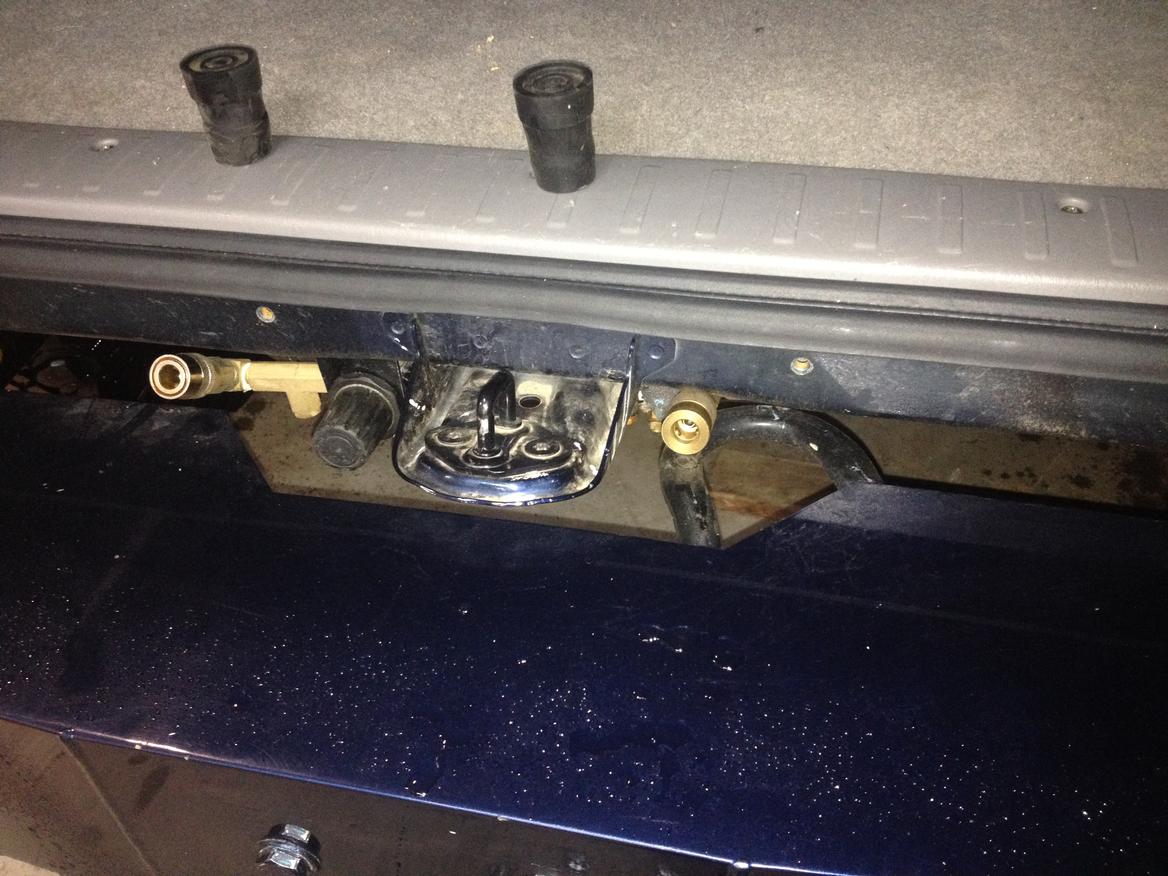

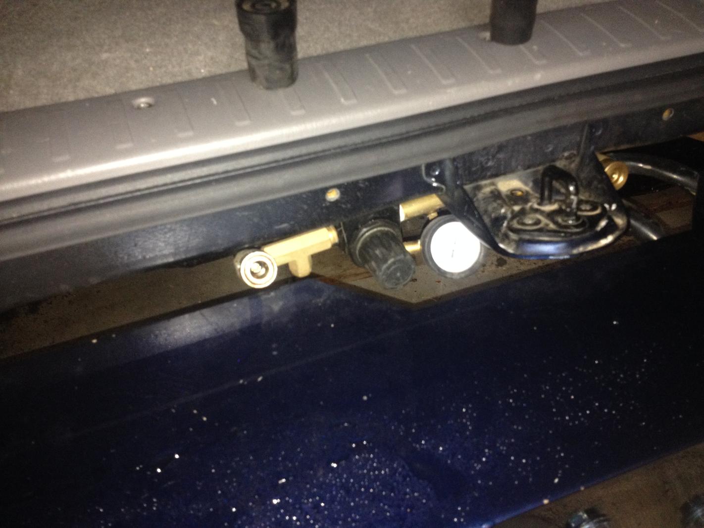

rear regulated air for power tools ect.. and unregulated air for airing up

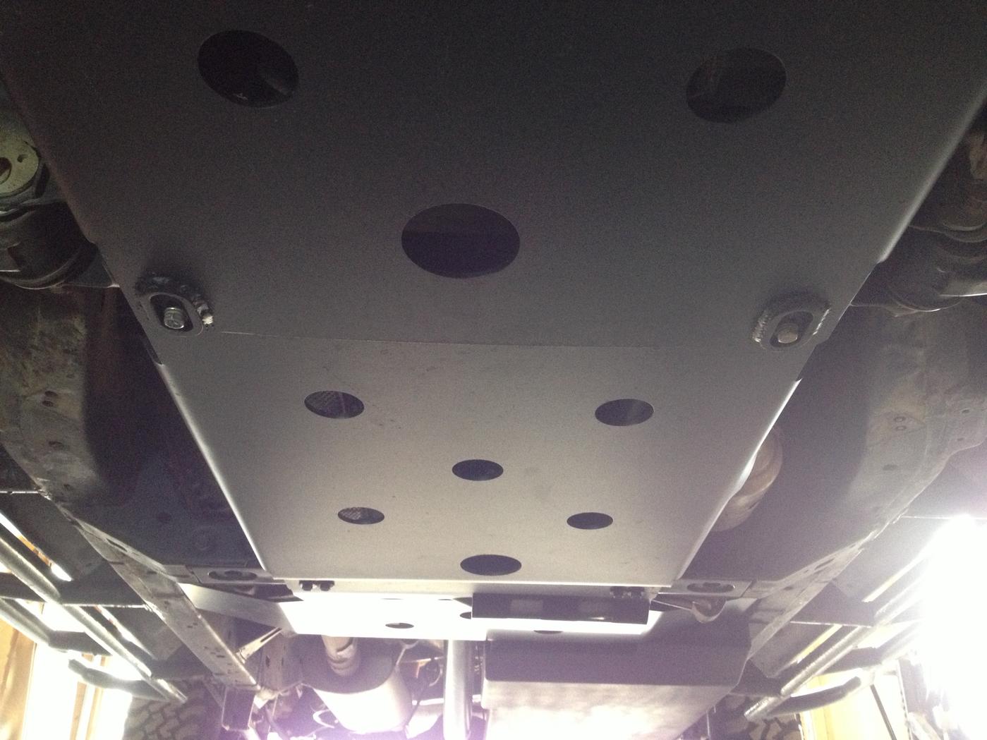

Budbuilt gas tank skid

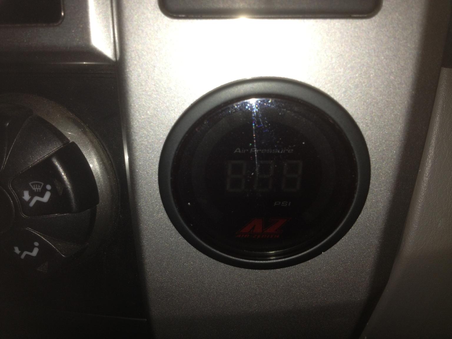

Air Zenith digital psi gauge

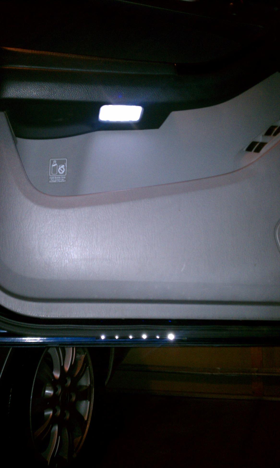

led mod under each door

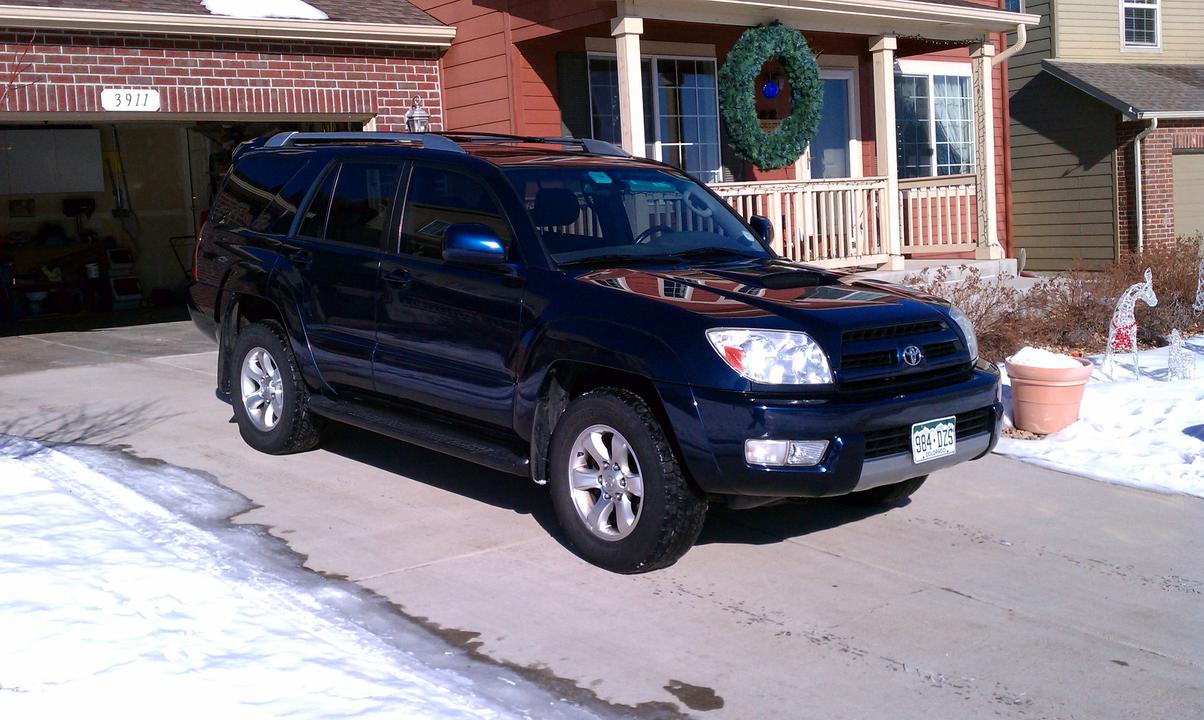

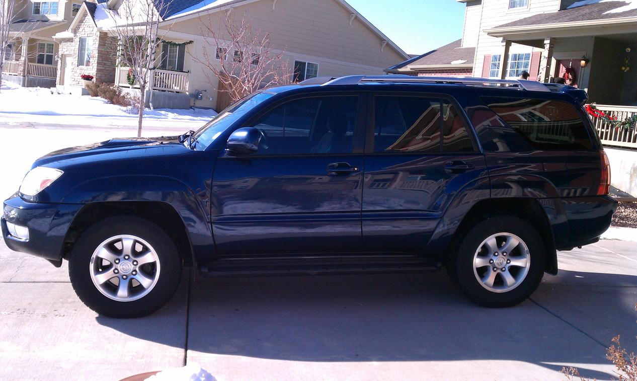

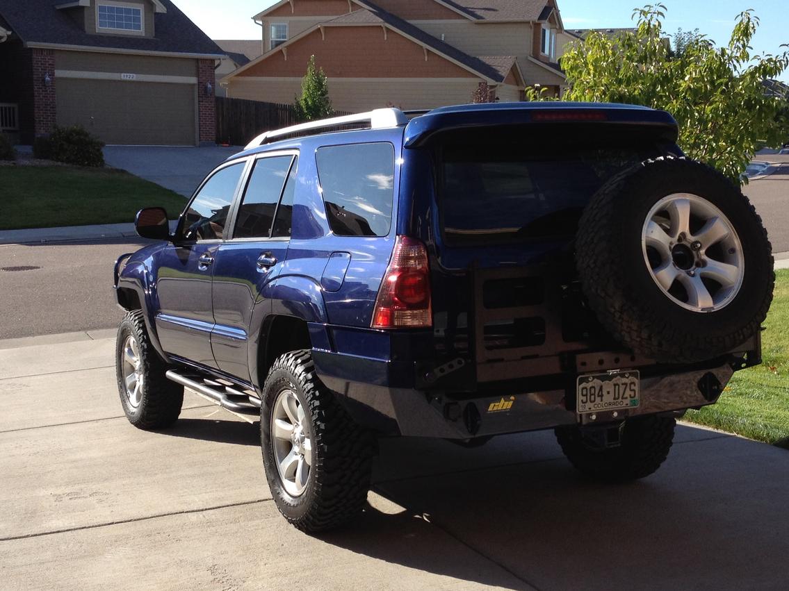

New bumpers

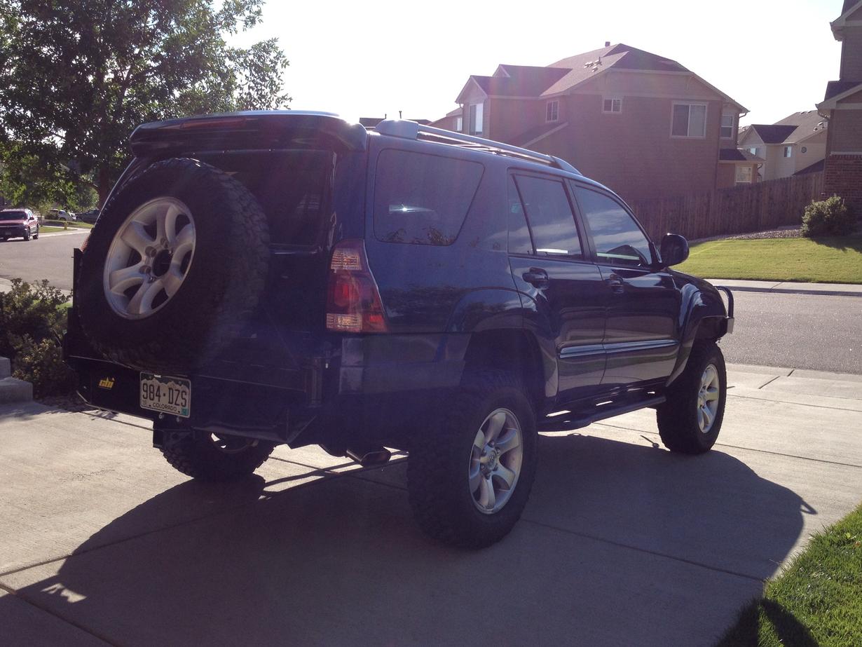

I found some original pictures
a better picture

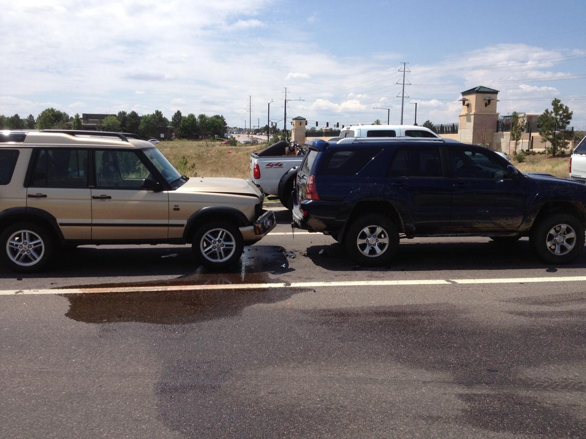

and here is the reason I used to convince my wife I need the rear bumper :thumb:
