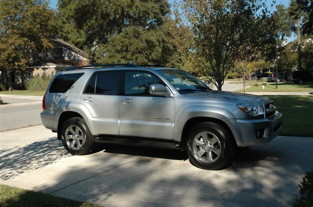

Attached is a pic of the car should anyone want to see her.
