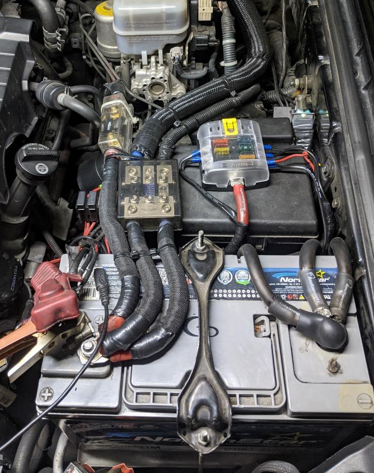

im using the marine version, basically it has dual terminals. remember not to slam the hood down, make sure the negative side dont hit the hood. i never had the issue with the older group 31, since the terminals are in the rear and not the front.
Nice. I've got the dual post marine version as well. I was worried about the hood height becoming an issue with the posts being so far forward. I may get creative and use one of the larger, flat terminals on the m8 bolt or the Knu Ultimate terminal to relocate the post closer on the main post with their side mount. I'll just have to see how far the factory stretches and what fits.
No fender crack issues from the extra weight? I'm hoping that's due to more offroad use so I should be safe.
