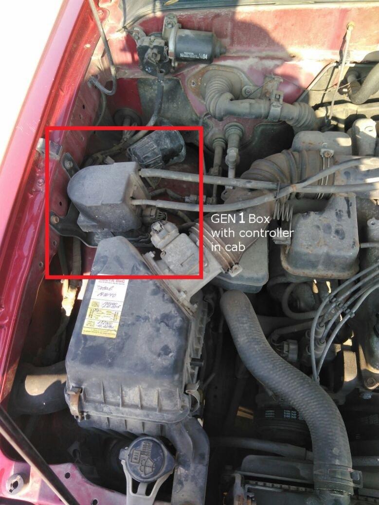

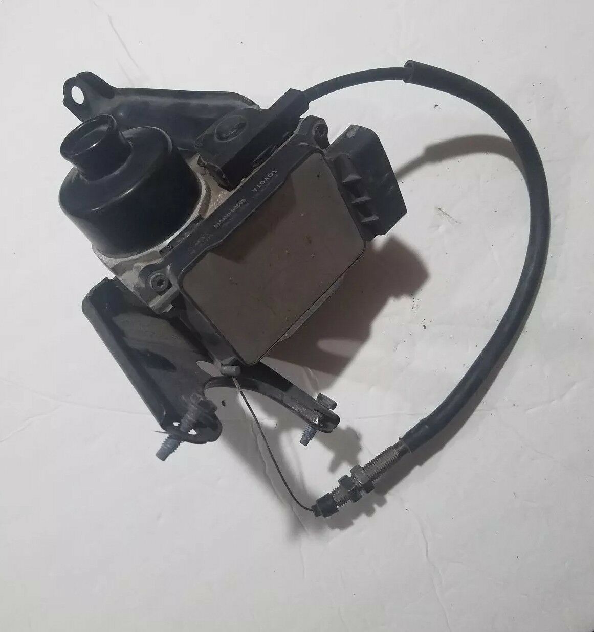

In the US, 4Runners are equipped with two gens of CC. 1st gen is made up of a controller and actuator as two separate components. One sits in the engine bay, the other is in the cab.
Gen 2 CC is made up a single box with everything in one place and is installed in the engine bay.

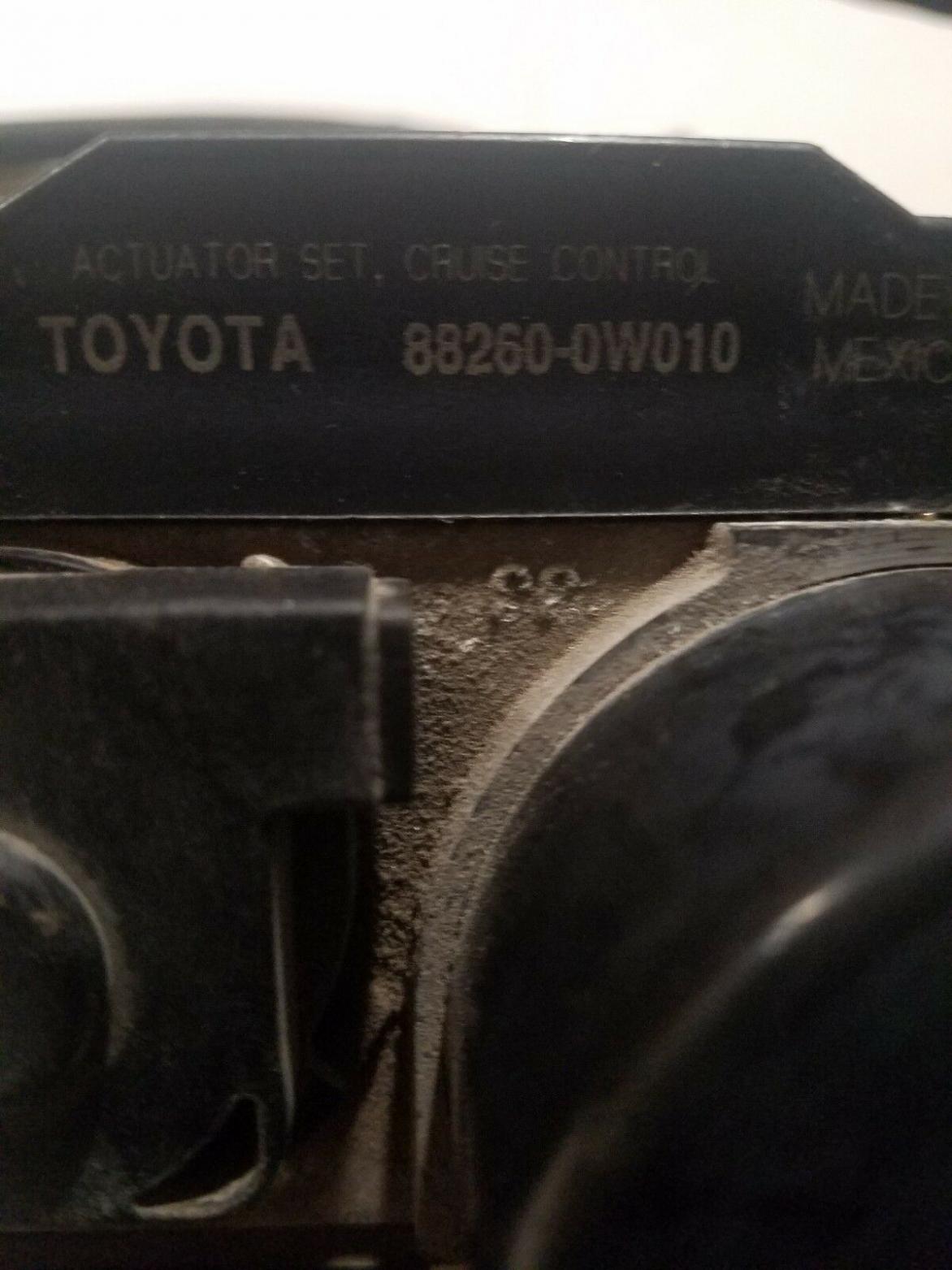

So, simply go to a junkyard and buy a gen2 CC from a 4Runner (after 2000 i think(just look at the pics)) with the cable link, and all connectors, CC control switch, the steering wheel's rear bezel cover with hole for the CC control switch(or cut a whole in your own) and brake switch and clutch pedal's switch, if it s manual. Make sure the brake pedal switch is with 4 contacts, as the switch for just a regular brakes with now CC option, has only 2. Also cut the loom a few inches away from all the connectors that you take with you, so you can see the colors of the wire later to install them in your car.

Ive attached pics of gen 2 CC to see what it looks like, and one of the gen1 which there is no point dealing with as the engine controller on older models is separate/is the engine ECU...

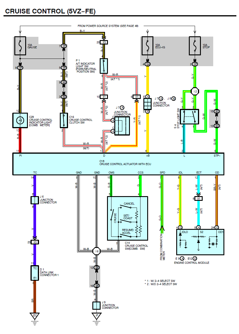

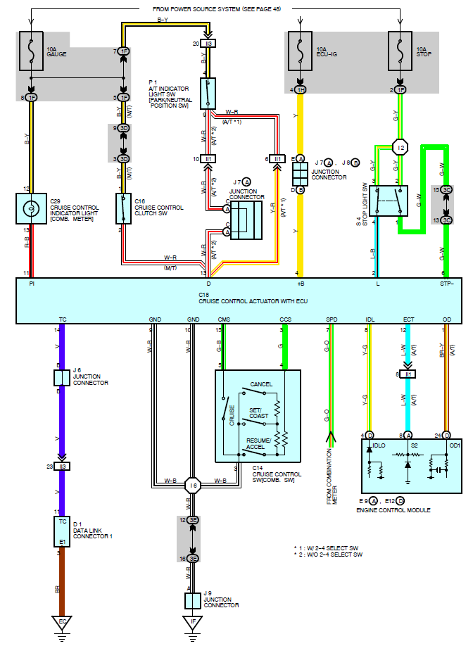

The wiring schematic is not too complex. It's only one page, but it's just the wiring that takes time to pass through all the firewall and other looms to reach the combination meter, pedals, and ignition power and steering wheel.
To know what CC you will be buying, bring the schematic with you at the junkyard to compare the wiring when you get the parts.

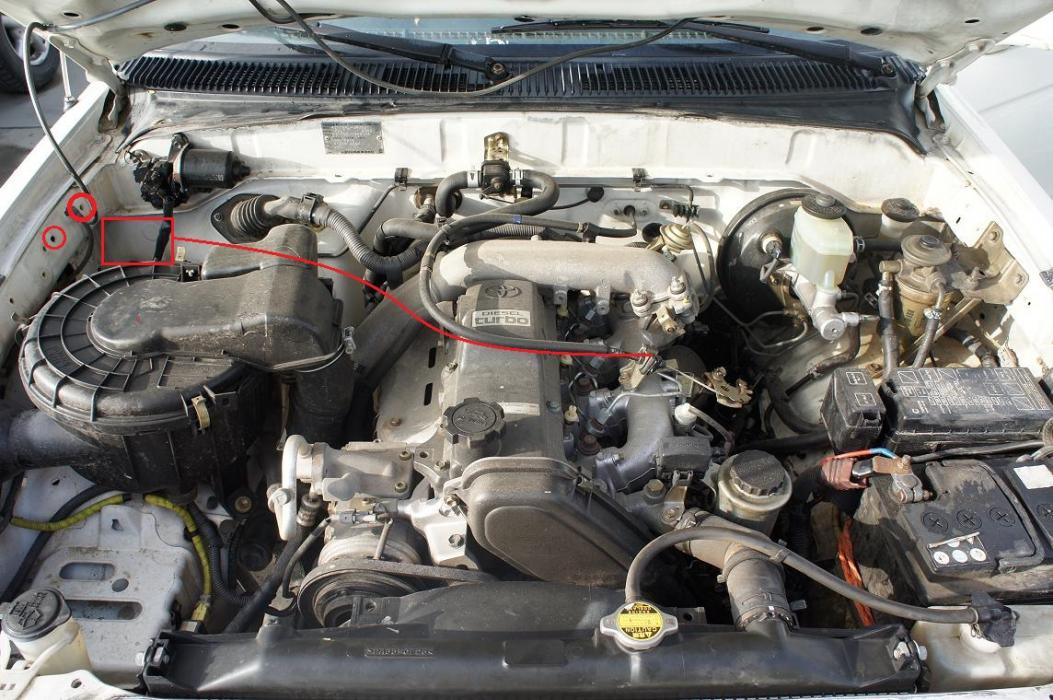

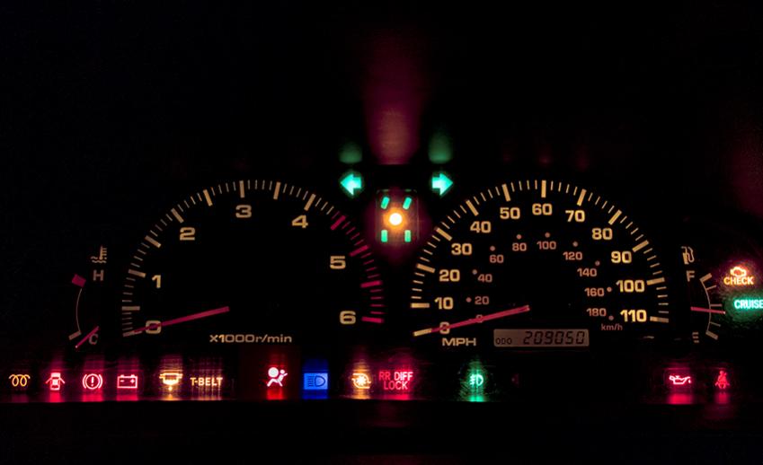

There are two types of CC dash lights. I've managed to take out the gas gauge plate that has the cruise control icon in the dash (with out removing the gas guage needle - you have to use scissors to cut it out) and install it in my dash. But it is easier to find one with the icon in the lower part of the combination meter, as it is rectangular and easier to install and there are plenty of spare bulbs to use on the Hilux Surf.

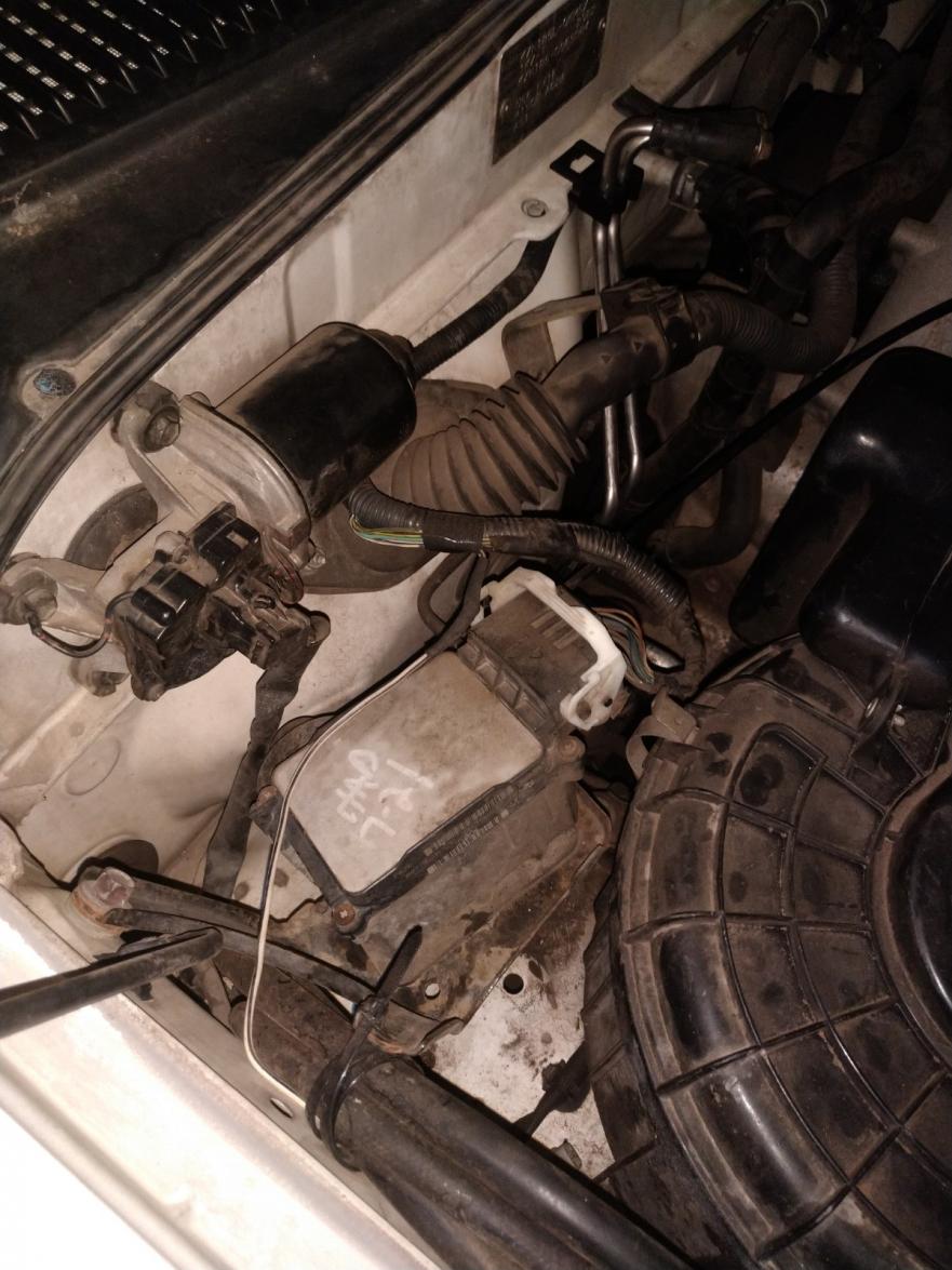

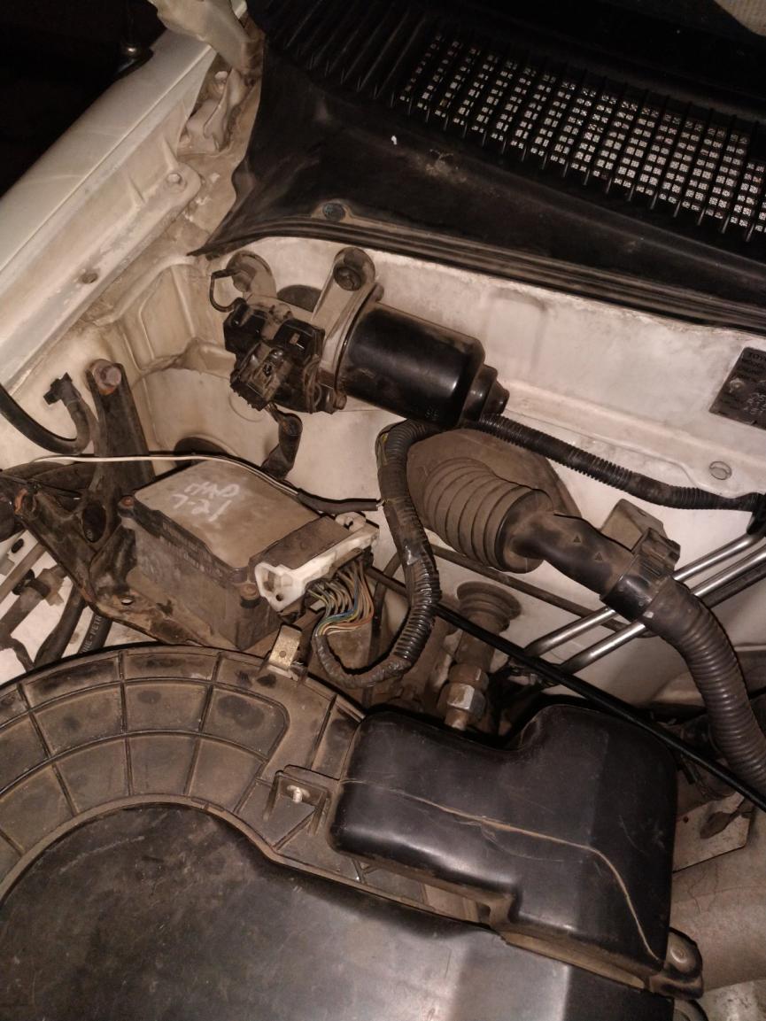

I used the original bracket to attach the module behind the air cleaner element on my 4R. But depending on your KZ configuration, you will have to science it out where it's best to mount the CC, as mine is not a Hilux Surf, but a LHD united nations 4Runner. I know that the ABS control stays in that location on the Surfs.
I had to replace the original cable link with a bicycle one, cuz the original was short for where I had mounted it behind the air filter.
The pic of the CC in the red 4runner bay, is of of my gas US Runner, it is a gen1 CC module. Dont look for this CC, as it's more work to install and you have to know what engine ECU you have...

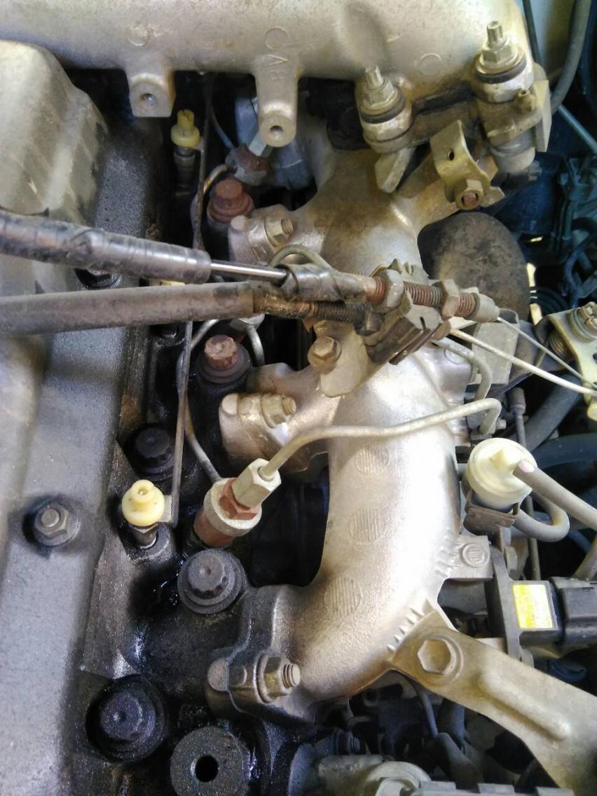

Ive installed it on a few KZ engines with the mechanical pump. Not knowing what throttle body you have, you'll have to find a way to make it pull on your TB link. I directly attached it to the link on the injector pump, as in the pic on the 1KZ-T (not 1KZ-TE).
You dont need all the wires, unless you want to be pedantic about it. Again- it can work independent of the other secondary systems.
I dont have a pic of the location of the CC installed in my car, just a pic before I did the mod, so I did some drawings to give you an idea where it stays and how it is attached to the accelerator link. I did managed to attach the original bracket by the lower bolt and one on the side but can remember if it was forward hole, or rear :D
I will try to take one today and add it. But here are pics of the general installation and what the gen 2 CC looks like - the wide connector.

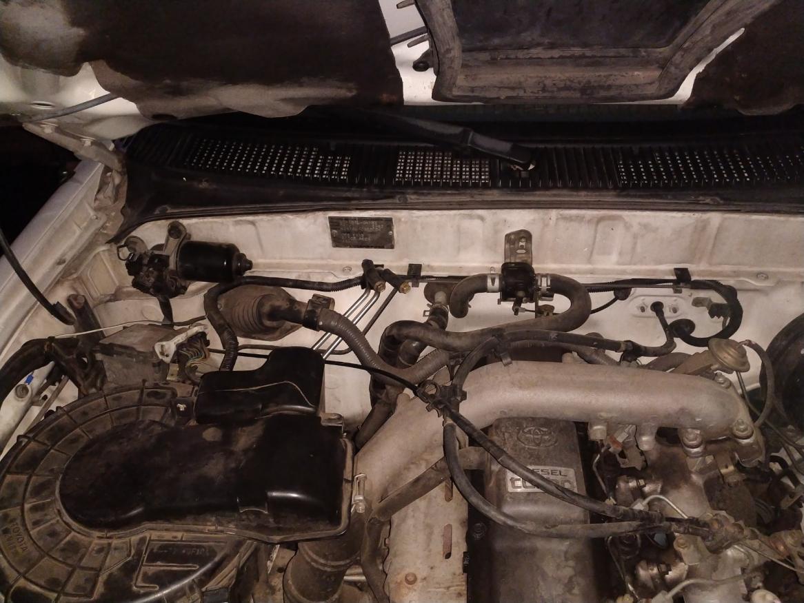

Guys, here are pics of how I installed the actual CC actuator behind the air filter box.
Hope this makes it more clear. If you exchange the accelerator cable with a different length, you can install the actuator in any available free space. I had space behind the filter box, so that's where I mounted it.
Also make sure when you attach the cable to the throttle, that is has no slack, otherwise when you set it at certain speed, it will jerk the car every time it pulls to accelerate or lets it go to decelerate.
You can see where I ran the electrical harness into the cab- thru a hole in the driver's side of the firewall.

Also, on your Surf, I dont think there is a lamp to turn on when you push the CC ON switch. Just install a light bulb in any of the empty slots for bulbs and see on the PCB to which connector the tracks lead to. One is always a 12v+.
If there is an icon for something else, you just have to remember that it's for the CC.

Here is the schematic I used.
Did I answer your questions?! :)

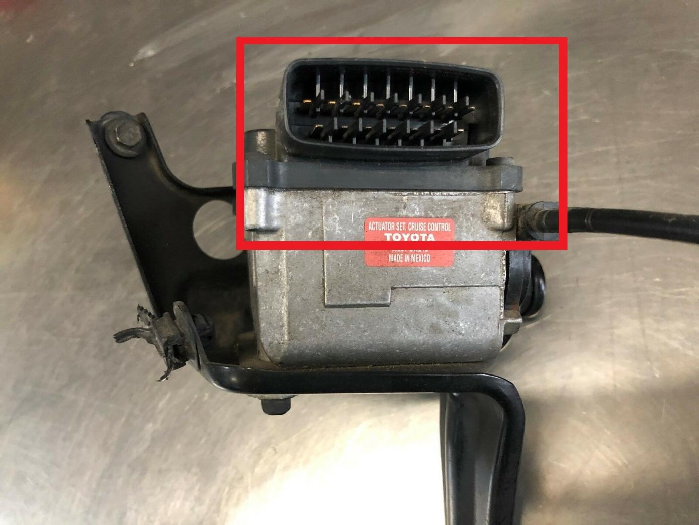

Mate, wonderful write up... looking forward to giving it a try on my old rig. Looks like we didn't get the 88260-0w010 actuator down here (Australia); what's the chance you've seen a similar part in anything else locally available to yourself? Hounding the parts EPC to try and find a similarity to something available this side of the screen (ie. ECU and actuator as a single unit). Worst case, ebay US & shipping isn't the end of the world.
Will be attempting to match it upto an LN130 with the 2L-TE
Lastly; that actuator is a 15 pin, however EWD is 14 pin; It's been that long since I've buggered around with EWD's - Can you confirm which is pin 1,2.. etc relative to the EWD you uploaded?
Many thanks, love your work !
sorry mate, just saw you posted this post from another post posted with a post about my post posted in the comments section :becky::becky::becky:
did you manage to get the CC going on your rig?
This numbers on the diagram's device (in this case the actuator) are always read looking at the connector from the pins side (not the wire side) with the locking clip on top. The top left pin is 1 and so on. You can also compare colors of the wires.
If you look at the wire side of the connector, you'll see small digits at the corners of the connectors to help you identify the rest on each row.
The diagram has 14 pins and the 15th pin is not used in this system, so ignore it.
Pin number 1 on your ABCDEF... pic should be letter H.
Hope this helps.

I'm finally going to get CC installed now... just wondering: with no power, should you be able to move the CC actuator cable? Or is there a brake? Just wondering if my unit is seized or if it's actually fine...
