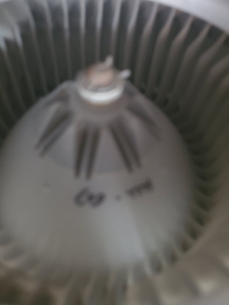

Did you look down into where the fan blades are for debris down around the blades?

Exactly. I've had debris get into the fan 'tunnel' area in many of my cars. It makes the sound I hear in your video. Stuff comes into the air vents below the windshield, under the hood, then they get stuck in the area around the fan blades and make a racket. Sometimes they rot and blow past but quite often they just sit there and make noise.
I've not had the problem yet. Whenever I open my hood I always check the vent grill area and clean it up. I'm not sure how much you can see/feel when you take the filter out but you need to reach the fan blade area. Wouldn't hurt to check that grill - vent air intake area either.

So I have now checked the fan blades and there was nothing there. I will check the vent grill tommorow. I couldn't get it to make the noise it was earlier and it was blowing air. But it was making it in the morning.
I did manage to wedge my phone in there and get a picture of the fan.
