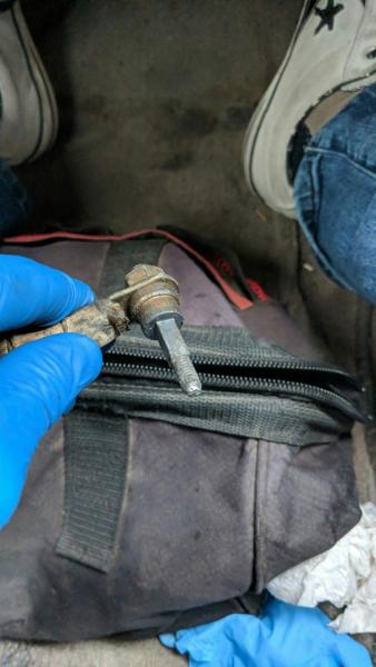

Next day I drove a mile down the street and alternator was not charging at all. Decided to check the battery posts. Sure enough some had worked themselves loose. Car seemed back to normal and working good.
next day I started my 13hr drive home and about 1hr into it the alternator stopped charging completely. So I pulled over in the rain to check again and was shocked to see the alternator charging bolt had worked itself loose and it fell out the back of the alternator.
luckily I was able to McGiver the thing and push the bolt back in and then pull tension on the wire locking the bolt in and zip tying it. This seemed to work fine and I only had to fix it a few times on my 13hr drive home but I made it back. Stock alternator is going back in today for now.

Its Fixed. Mine was a Denso so good quality. The nut just backed out. Its been at least 50k miles so Its been good so far.
It was a pretty easy fix all together. I just removed it and unscrewed 4 bolts. The whole alternator slides apart and I found the nut stuck to the magnets inside. I put some lock tight on it and snugged everything down.
Seems to be good as new :biggrin2:
