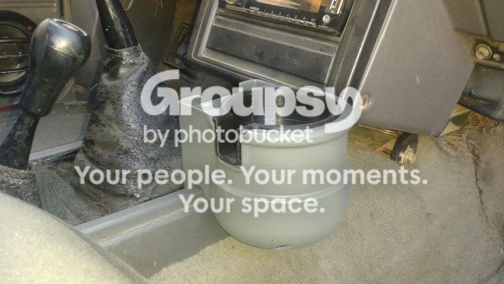

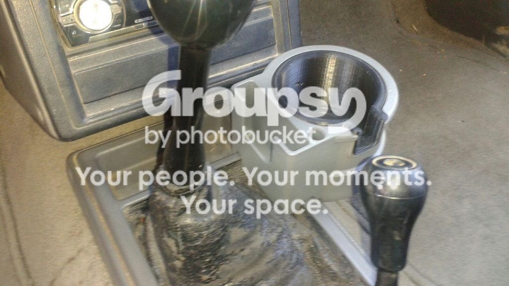

So I heard back from the guy that got the first prototype installed. It had zero interference issues with the 5 speed and 4WD shifter. In 5th gear and 4lo there was plenty of room. The seat lost about an 1" of forward movement but still easily accessable for passengers getting into and out of the back seat. The cup holder did come in contact with the dash but did not create any functional issues. I will move it back about 1/4" of an inch to have zero contact with the dash. I'm actually making that change right now. I will have the final design done by late tomorrow and will get these into production on Monday. I plan to make a decent size batch before I release these to my website. They should be up on my site by this coming Friday evening. I will also start working on the double cup holder for the center console storage compartment late next week or the week following. Here's the pics he sent me. I will have better pics tomorrow.
So I made some minor changes to the design to get fitment perfect. The cup holder now clears the dash, shifters, and leaves almost full range of motion of the seat for passengers climbing into the back. Here are a few mor pics. I have 6 machines printing these right now. I should have a good size batch done by late tomorrow night and will get them up on my website on Wednesday evening.

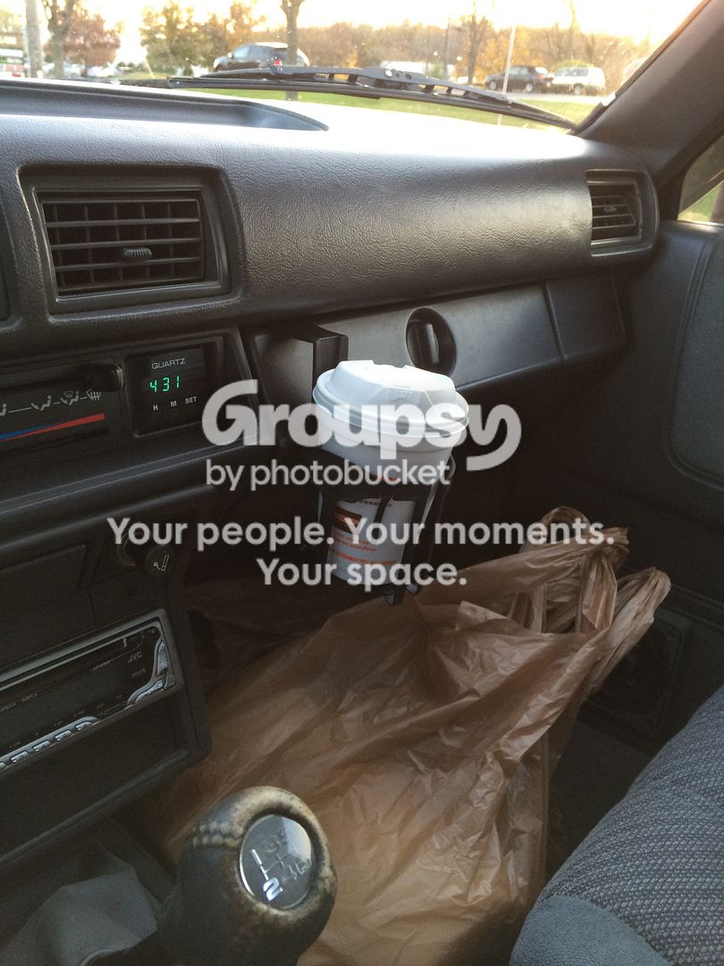

Edit: Just found this pic. I'm assuming this is a 4Runner? Is the auto the more common option or the manual? I can GUARANTEE my cup holder WILL NOT fit on the automatic console now that I have seen it. My offer still stands. I will still make a cup holder for the auto and whoever loans me the console first, gets a free cup holder out of it.
ACAC3B95-8ECC-4976-9B54-C6A8409338CE-24010-00000E0837647DB4_zps502e3964.jpg~original
After looking at that console some more; I'm not even sure there is enough space for a cup holder up there. The double cup holder for the storage part of the console might be the only option for the folks with the auto. What I need to see if a profile shot from the side so I can see the distance between the shifters (all the way forward) and the dash.

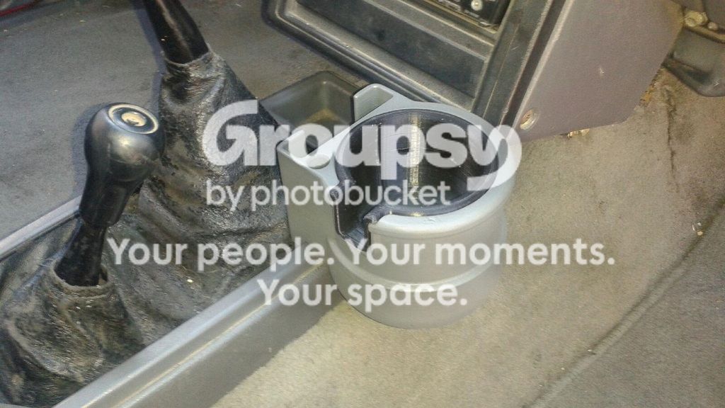

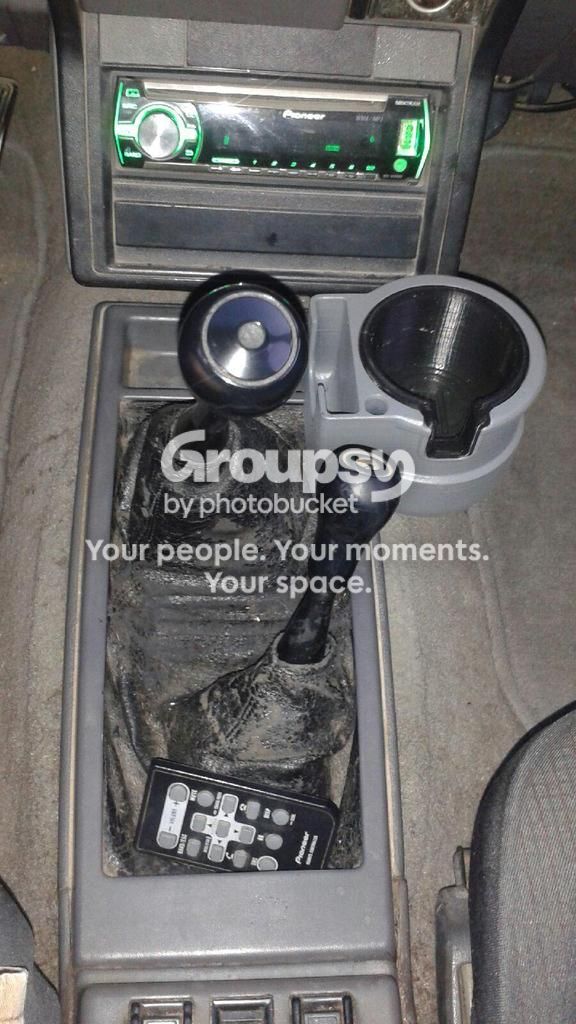

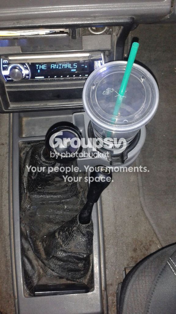

Alright, well I don't want to wait for the auto console to release the manual console cup holders. So I went ahead and got the first batch up on my site. I'm still interested in developing one for the automatic if someone is willing to loan me their console for about a week. I will also start working on the double cup holder that will mount in the storage section of the center console. Shipping is free so if you buy a single now and a double down the road when I release it; your not going to pay twice for shipping. Here is the final version installed. It sits right up against the dash to allow for the most amount of movement for the seat BUT does not get pushed forward by the dash. It will sit nice and flush/level and but tight to the dash. I had VERY little space to work with and felt this was about as good as a spot as I can place it and still allow full function of the shifters, full movement of the seat (minus a little over an inch), and clearing the dash. I will get some pics of the black one installed within a few days. I basically am waiting for someone to order a black one, install it, and then send me pics. The first few orders that came in today were all gray. 1st Gen (84-89) 4runner Single Cup Holder | BH3D Printing
