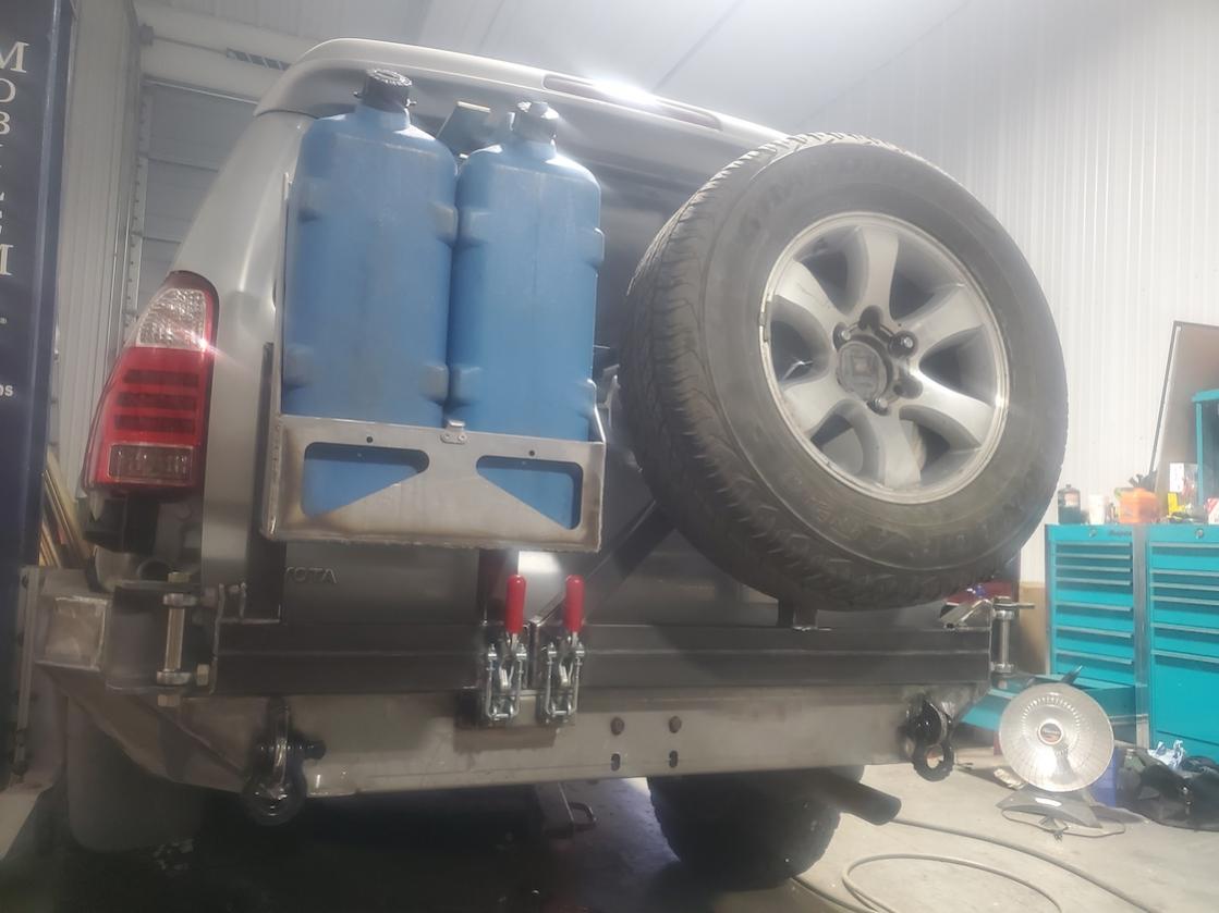

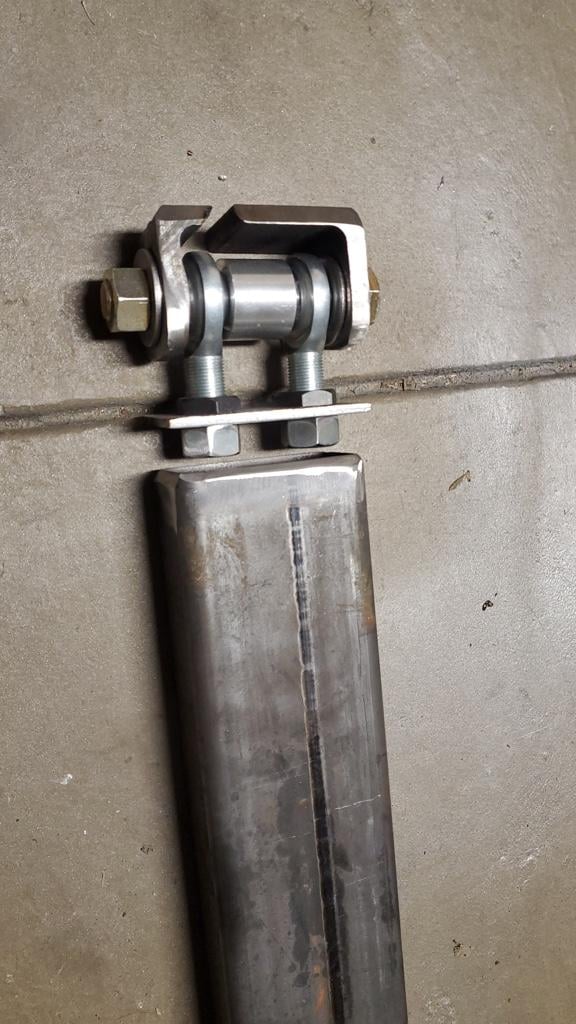

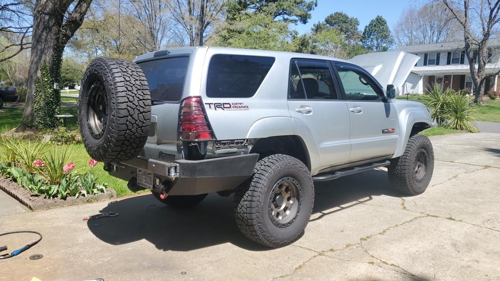

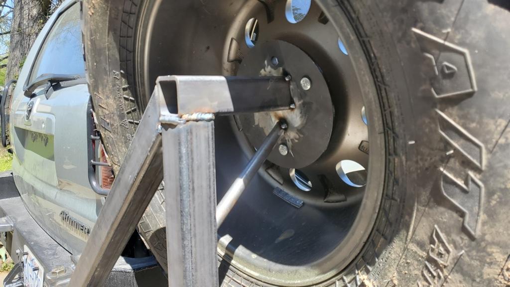

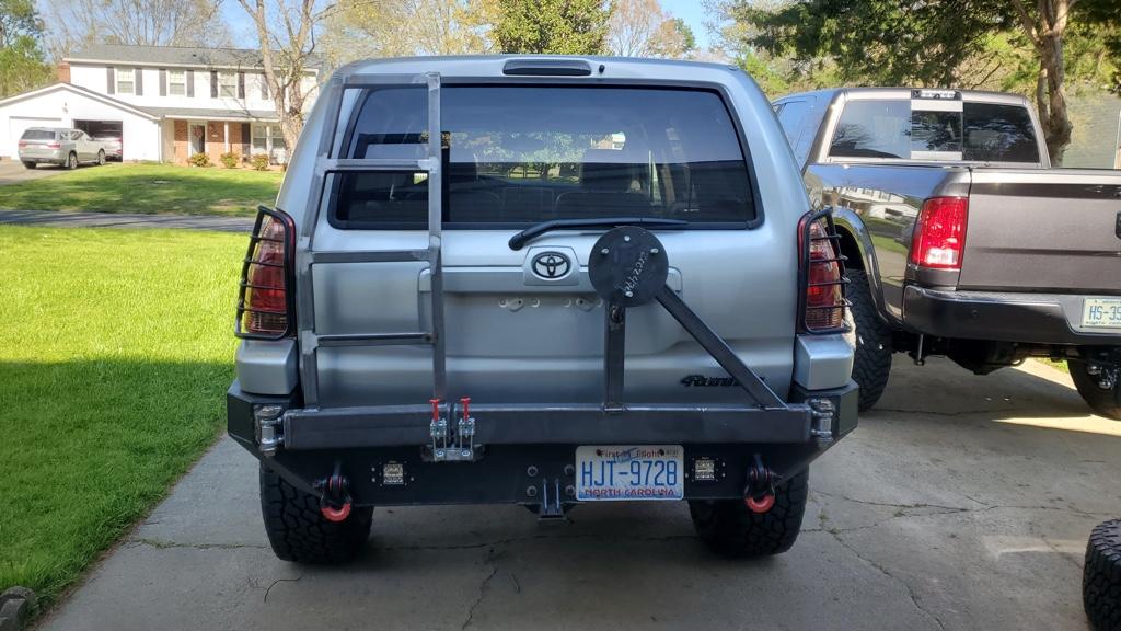

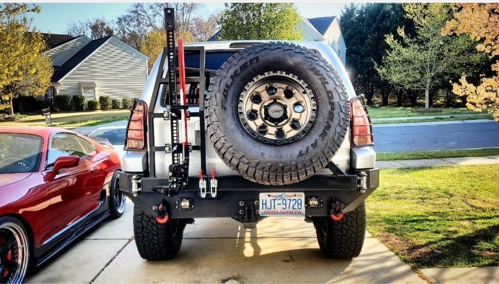

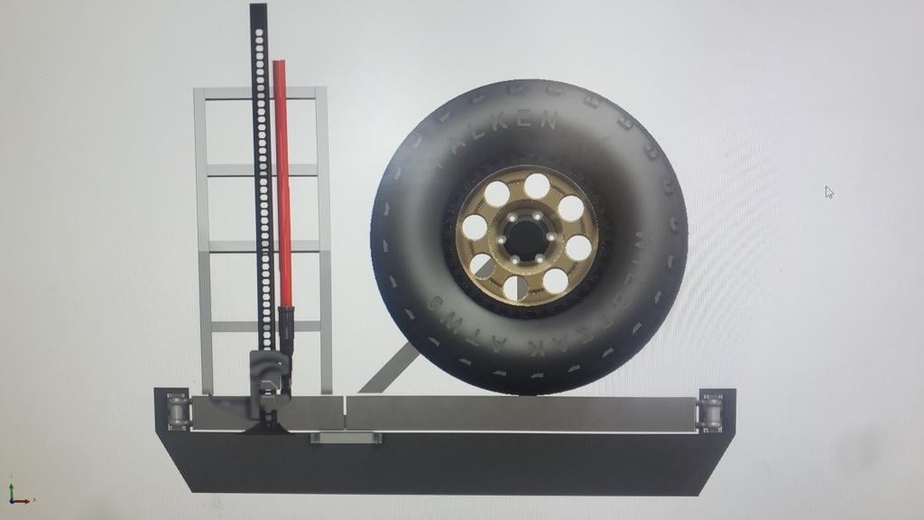

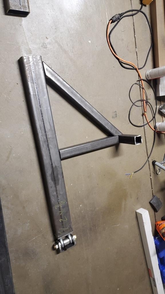

material cost wise swing outs are ridiculously cheap... I think the price is all in the marketing of a bare bumper vs a fully decked out, dual swing bumper. I can tell you the material cost to build my dual swing outs did not even come close to what i would have paid through coastal for their kit.. where as the flat cut steel for the bumper itself, I couldn't touch their cost even if I wanted to design it myself and have a local vendor cut it.
all you need for swing outs is a bit of thick angle steel, some square tube, a few heim joints, large nut/bolt hardware and a couple of latches. My tire carrier is made up of 3 pieces of square tube with a round disk that has studs welded to it. The other size I custom-fabricated a ladder out of some 1.5 (maybe 2"?) square tube and all was cut with an angle grinder lol. Ok.. fine, it was a bit more involved than just some angle grinding here and there, and obviously took some laying out to get it right. I traded my time and effort for cost savings. At the end of the day to have a complete weld-it-yourself swing out kit isn't all that terrible if you consider the time that goes into the design I guess.. but I liked the challenge and really enjoyed building these swingouts. I'm using them to carry my hi-lift, shovel, and axe when on trails as well as having easy access to get up on the roof rack via the ladder.

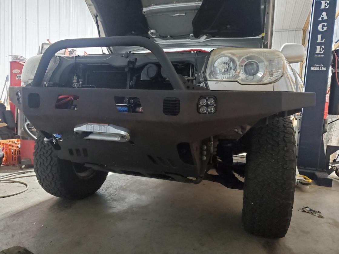

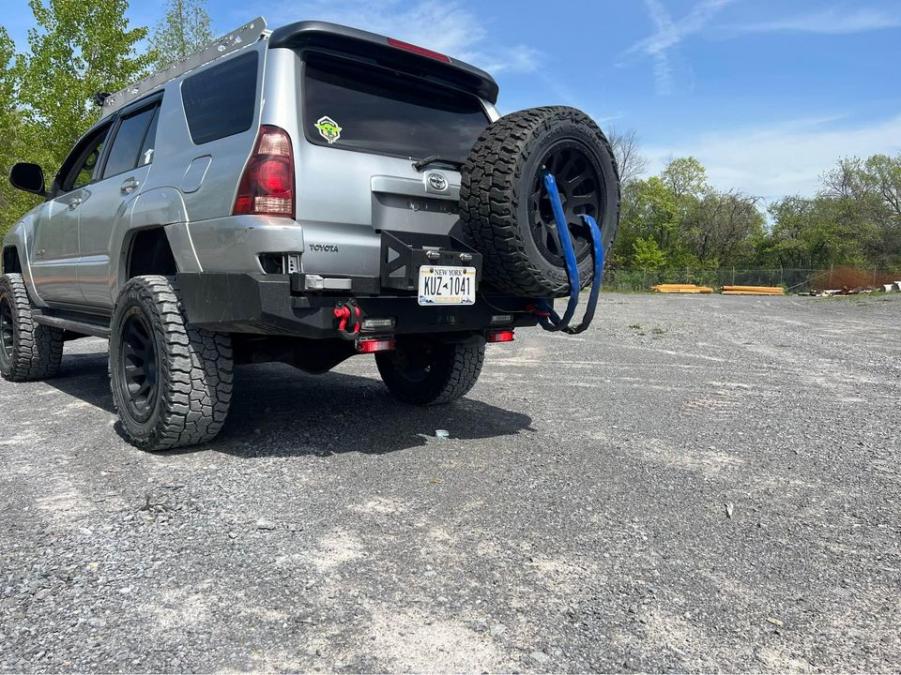

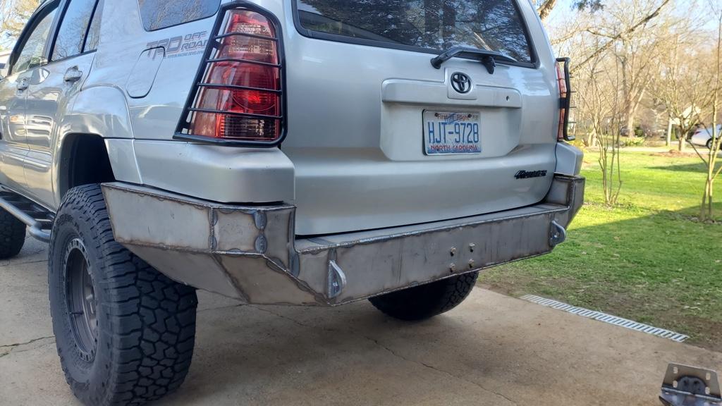

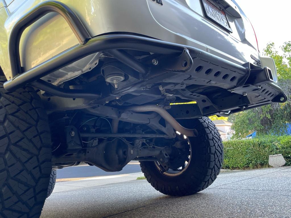

I also went with the Coastal front and rear bumpers (with dual swing outs). I already had a welder but it's not impossible to buy one, use it to weld your bumpers and then sell it. Add the loss (of the used price) to the total bumper cost and you will still be ahead. I built these both for about the same as one prebuilt and shipped. Don't forget about the shipping costs for a pre-welded unit. As stated above the kits are very well put together and the fit is really nice when welding. Nothing too difficult. I would recommend that you use a 240VAC welder as there are a couple sections in the instructions that require really good penetration. Coastal does have a rear hitch but it's weight capacity is not rated. I don't recommend getting that option (I did order it but will not use it).
