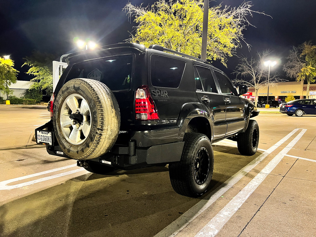

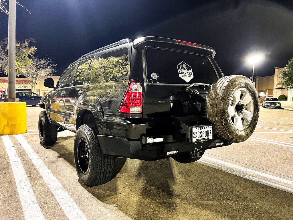

So the 5th Gen 4Runner bumper WORKS with minor modification! You have to remove a few things from the frame and obviously cut the OEM plastic- but if I could make it this clean with a 1" body lift, I bet y'all could do much better!
For $700 shipped and at my front door in 4 days- I am pretty darned happy!

So, I had to chop off the original tire carrier stops, two metal pieces that the original tire butts up against when its raised.. I do wish the sides of the bumper came up higher, but its nice how much realestate you have to play with when trimming your plastic bumper to match up.
I even kept my OEM trailer hitch for this one, its not the HD one that bolts in 3 locations, but still. Im impressed that it worked.

Hey, sorry for the late reply! I measured from the metal part of the car to the top of the bumperat points of the fender flare, where the plastic fender clips are, the outer edge of tail light and inner edge of tail light.
I then put painters tape on plastic bumper, flipped it upside down and measured from the ground up and making corresponding marks of the measurements I made earlier.
As a note, subtracted 1/8" from each measurement to give some room for the included weather strip deal that cleans up the cut edges.

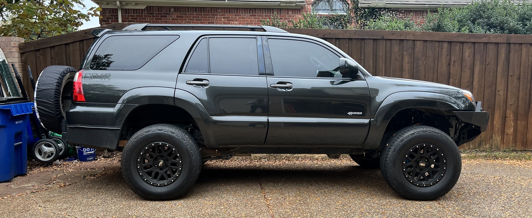

The only thing I'm seeing that might not like is how low it hangs. Could you take a side profile shot if you can?
It does kinda hand down a little low, it does follow the 5th gen body lines, but looks like a "long face" on the 4th gen lines. I do plan on doing a little "massaging" on the rear bumper before 35's that may also aid in the look of it.
Thanks for the pics.. It definitely does hang down pretty low. How thick is the metal?
