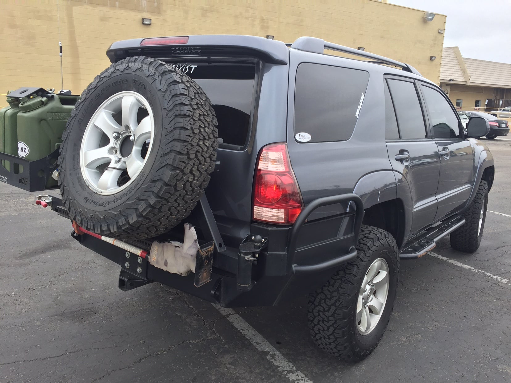

CBI Offroad. These guys make a quality bumper
I see you've got the receiver on the bumper. If I understand correctly, this bumper goes over the ladder frame the same way the stock plastic one does, right? So how does the departure angle and ground clearance compare?
Yes it does. Those four bolts around the receiver hold the bumper to the truck. I've had no issues with any angles. There is more clearance than the stock bumper. You don't have to use the receiver if your concerned about clearance.
That's good. Also, what are the bars around the side of the bumper for? Tie down points people to help when you're on three wheels and about to roll over?
I had them add the bars. After doing a google search of their bumper to see different angles of it and seeing those bars on another T4R. You have to call and ask for them. It's not an option on their website. They can be used for just about anything. I was mostly concerned with protecting that quarter panel

I see the CB has an option to account for a BL, so I assume it must be something that can be compensated for.
The more I look around and see this option, the more I think I like it. I'll keep it in mind as an add-on.
