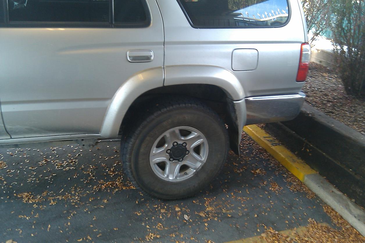

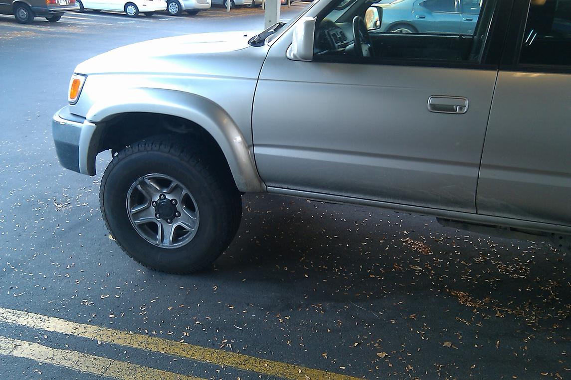

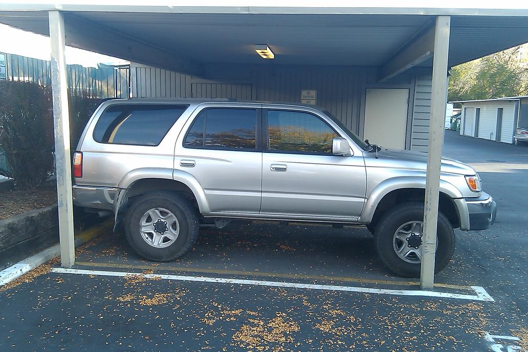

here are the pictures, hopefully they help. its a 2001 sr5 with 4 wheel drive.

look like its stock height... they may have just added the slightly larger tires and removed the running boards to make it look taller.

well urs might be a little taller bc the original owner might have changed out ur stock coils for some taller ones such as the '99 coils and got a slightly larger tire size.
