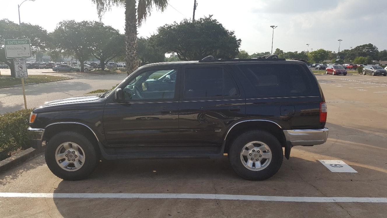

Finally decided to make my own thread to somewhat document my journey with my newly acquired SR5 T4R.
Started off with a bone stock 1999 2WD SR5. Engine runs perfect, transmission shifts smooth. Has some leaks and probably needs some basic maintenance.

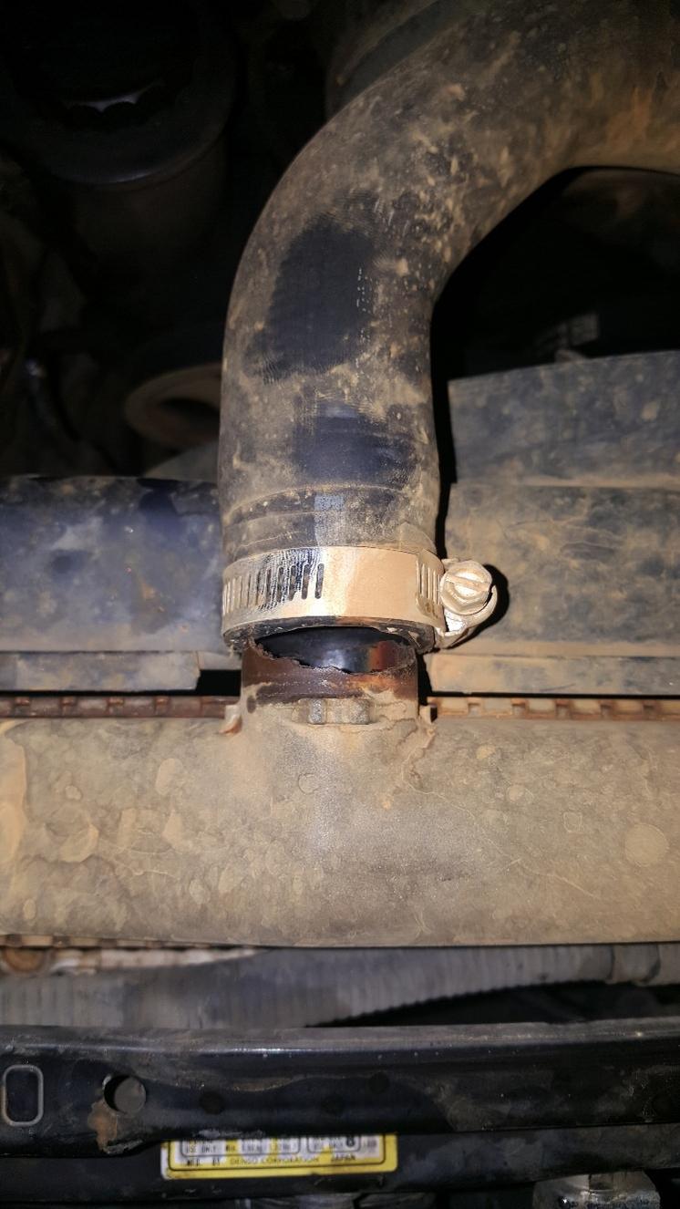

I was driving home from work and I noticed steam coming from the engine bay. Temp gauge didn't move so I hadn't noticed it. Car died while driving so i pulled over. Looked underneath and saw coolant and then as you can see in the pictures the top radiator neck snapped off and so a lot of coolant poured out which is probably why the coolant temp sensor couldn't read anything.

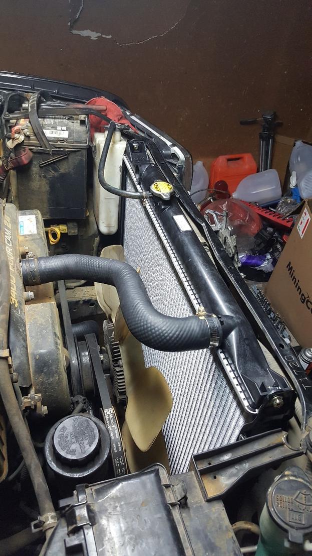

No worries, got a new OEM radiator, thermostat, hoses and fan shroud (not installed yet, it was on backorder).

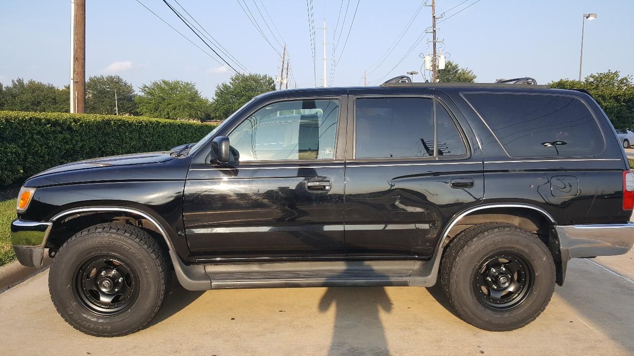

Next thing was replace the dry rotted tires and get some new wheels to go with it. Went with 16" American Racing AR23 wheels with 265/70R16 Cooper Discoverer ATP tires. Decent price for some mild all terrain tires.

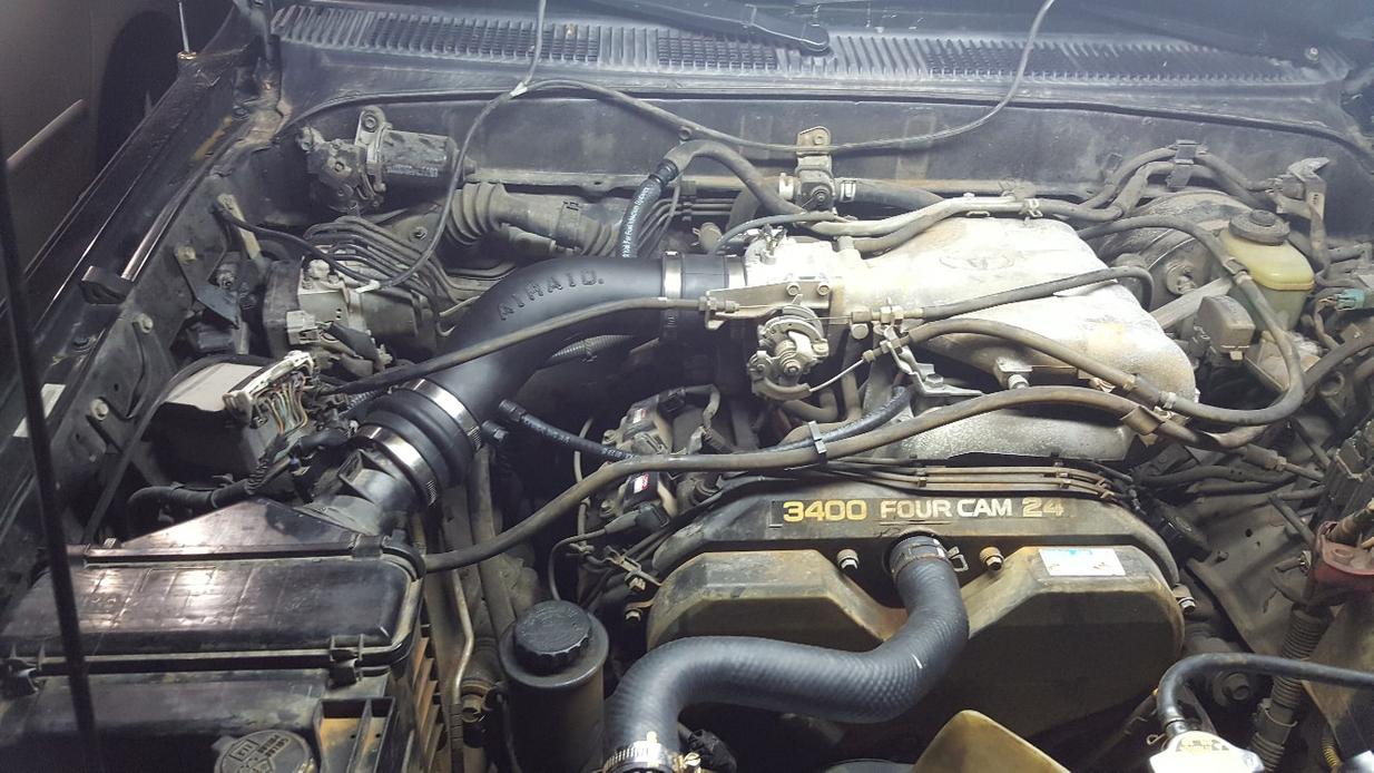

I also noticed that the stock intake tube by the throttle body had some stress marks and looked like it could tear at any moment so I replaced it with an Airraid intake tube.

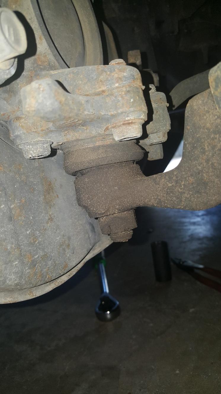

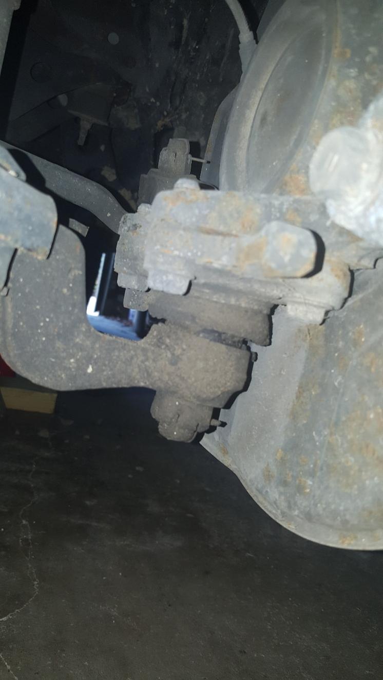

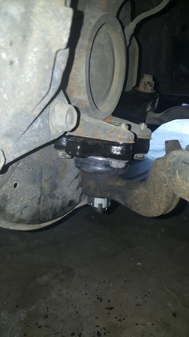

And just yesterday I replaced the lower ball joints as I've heard horror stories of them breaking while driving and I did not want that happening when my wife drives the car with the baby.
Pictures show the before and after ball joints, plus small and larger pitman arm tools i used to remove OTRE and LBJ. The old LBJ were definitely cracked and missing lots of grease. They were super loose and easy to move by hands also.
