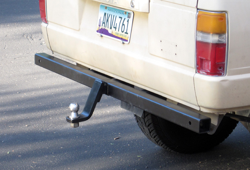

Where is a good place I can find custom front/rear bumpers for my 86'. been looking at the welded tube kind. any suggestions?
There are a few companies out there that make tube bumpers for the runners. My rear bumper is trail-gear, bought through Lowrange off-road. (can't afford the front yet). But they're good, I bumper checked a few times on the trail and had no damage.

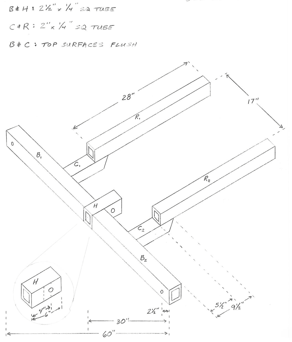

I designed my own to overcome the rear springs being mounted at the end of the frame rails (typical units wouldn't fit).
