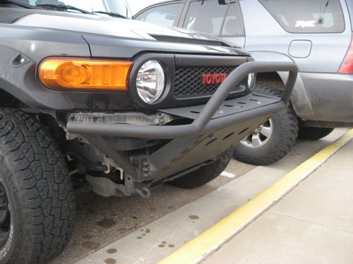

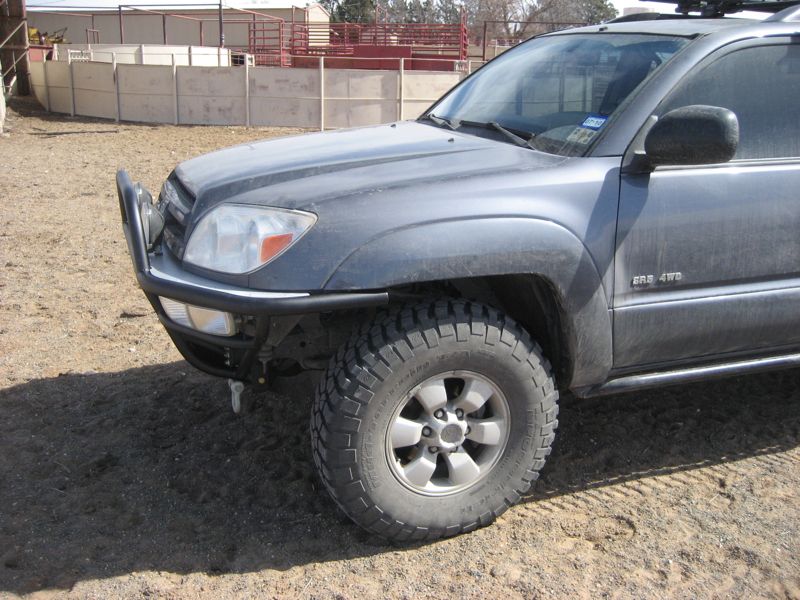

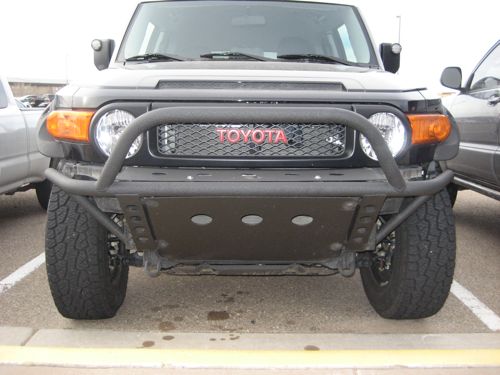

This is the look I am going for. Waiting for a quote from the fab shop now.

Adam up at 4xinnovations built it. I think he said had an issue with jig after we built mine, so I am not sure if he is still making them. Come to think of it, I haven't seen anybody else with one?
It was built with a winch mount, just haven't saved up for a Warn yet.

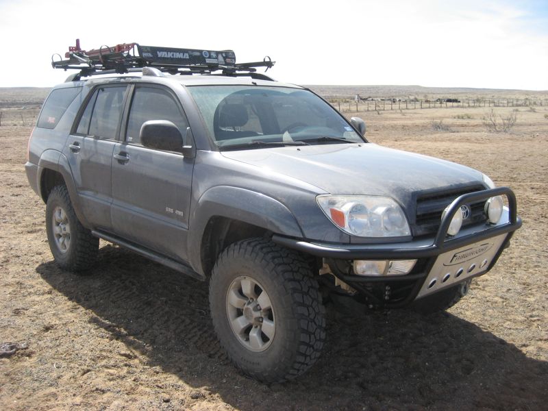

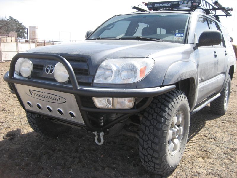

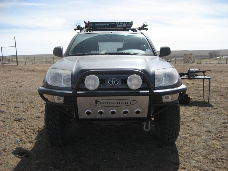

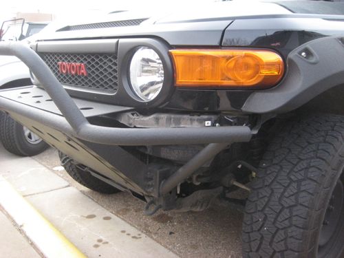

I picked up the bumper from Jackie at FabWright yesterday. I couldn't be more impressed. He was able to incorporate my stock fog lamps and turn signals, give me a 1/8" steel skid just under my radiator and I couldn't be more happy with the design. The only thing I need for it are 2 x 3/4" clevis shackles. Here are the pictures. Enjoy!

that looks fantastic!! do you know if he made a jig to build others or is this a 1-off? that's the exact look i want for mine. awesome bumper!
It is a custom bumper. I am sure Jackie could work up something that would look very similar however. Thanks for the compliments!
Looks great!
Mind if i I ask how much it ran you? Also, it looks to be bolt on, is that correct? Any idea of its total weight? And finally, did you guys ever talk about incorporating a winch into it?
