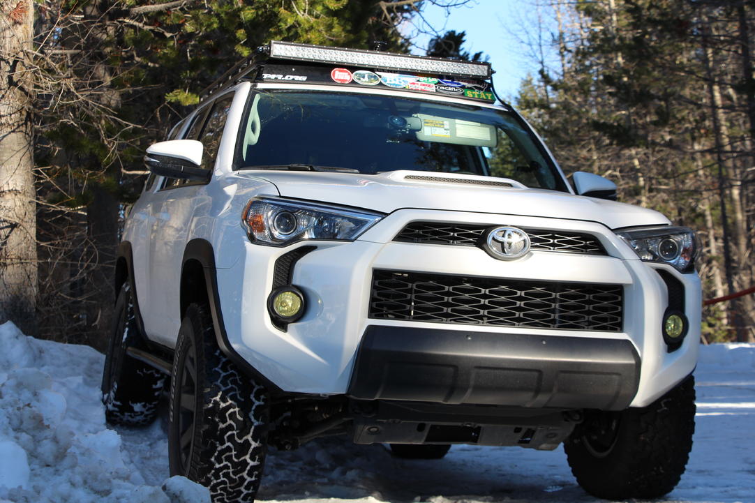

Here's mine on a Gobi Stealth Rack. w/ 40" straight bar
