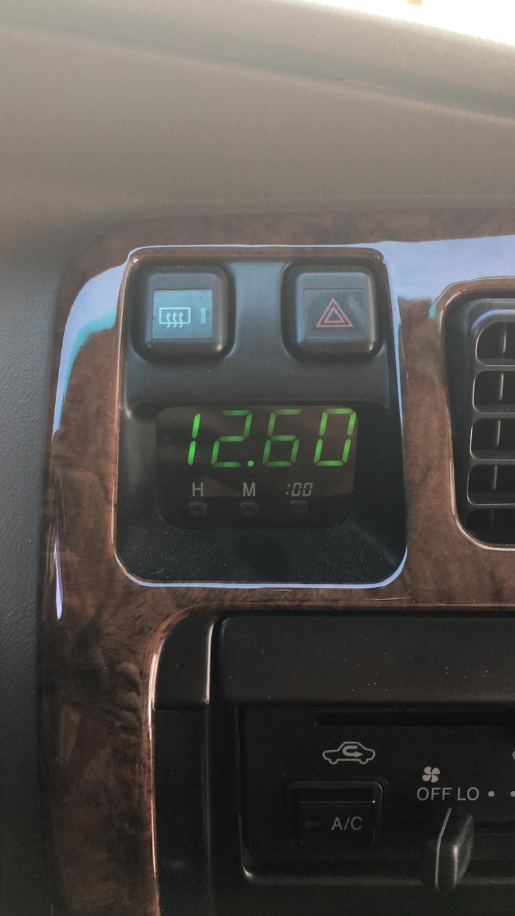

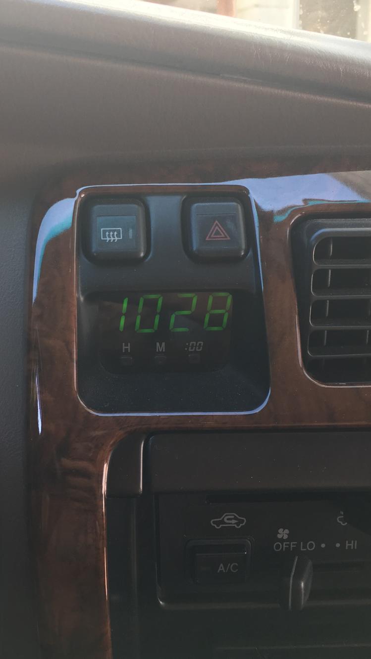

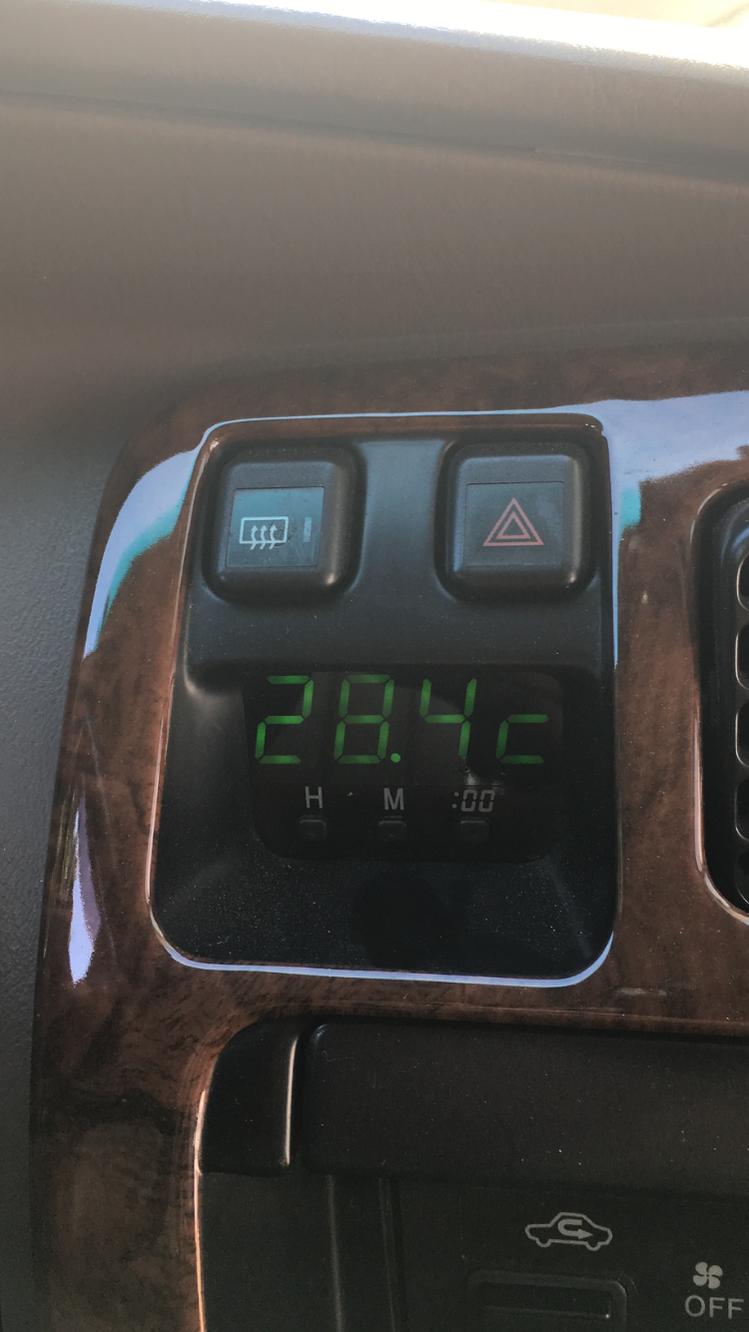

Looks good man! Here’s my take, Clock, Voltage, and EXT temp, all in one:)

Any info on this? I'm jelly!
Mine was made by scratch as a electronics project a while back, but these days you can find 'lcd panel displays' that have all 3 features mine has off of amazon for cheap, but keep in mind the temp probes that those kits usually come with aren't accurate at all and will need to be upgraded

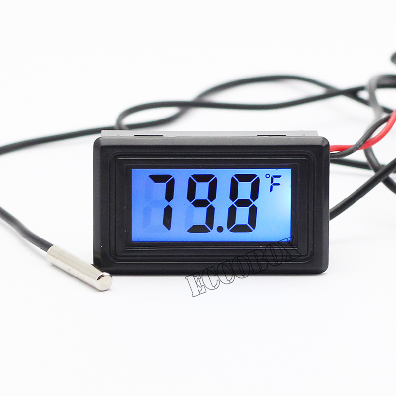

Looks like someone copied your idea!
https://www.amazon.com/DROK-Fahrenh...eter-Electronic/dp/B00E7OHM2O#customerReviews - look at the customer pics here on amazon. Might be easier for others to do if they wanna replace the clock....
