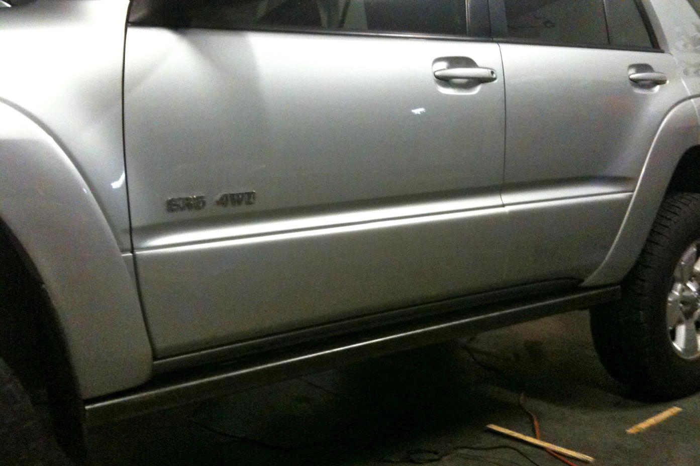

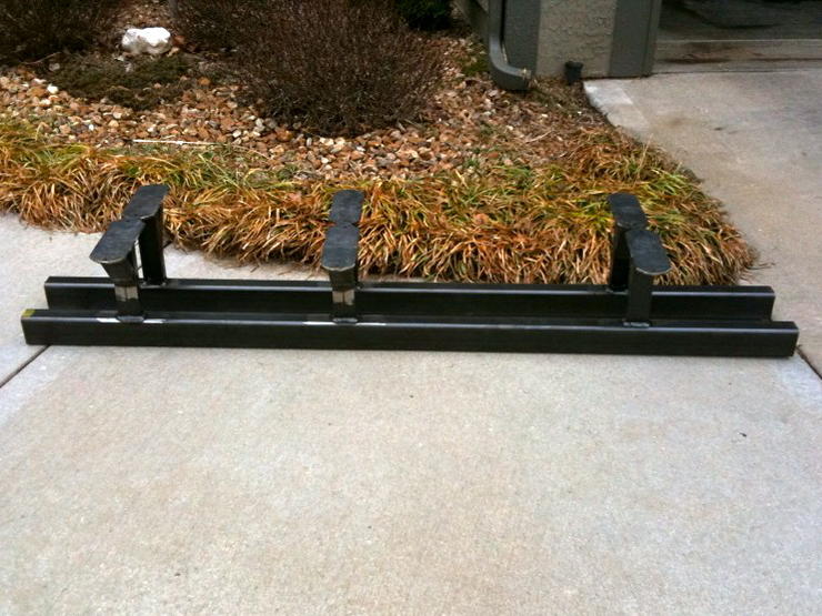

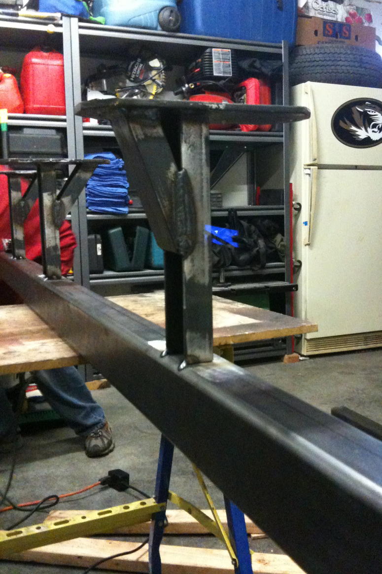

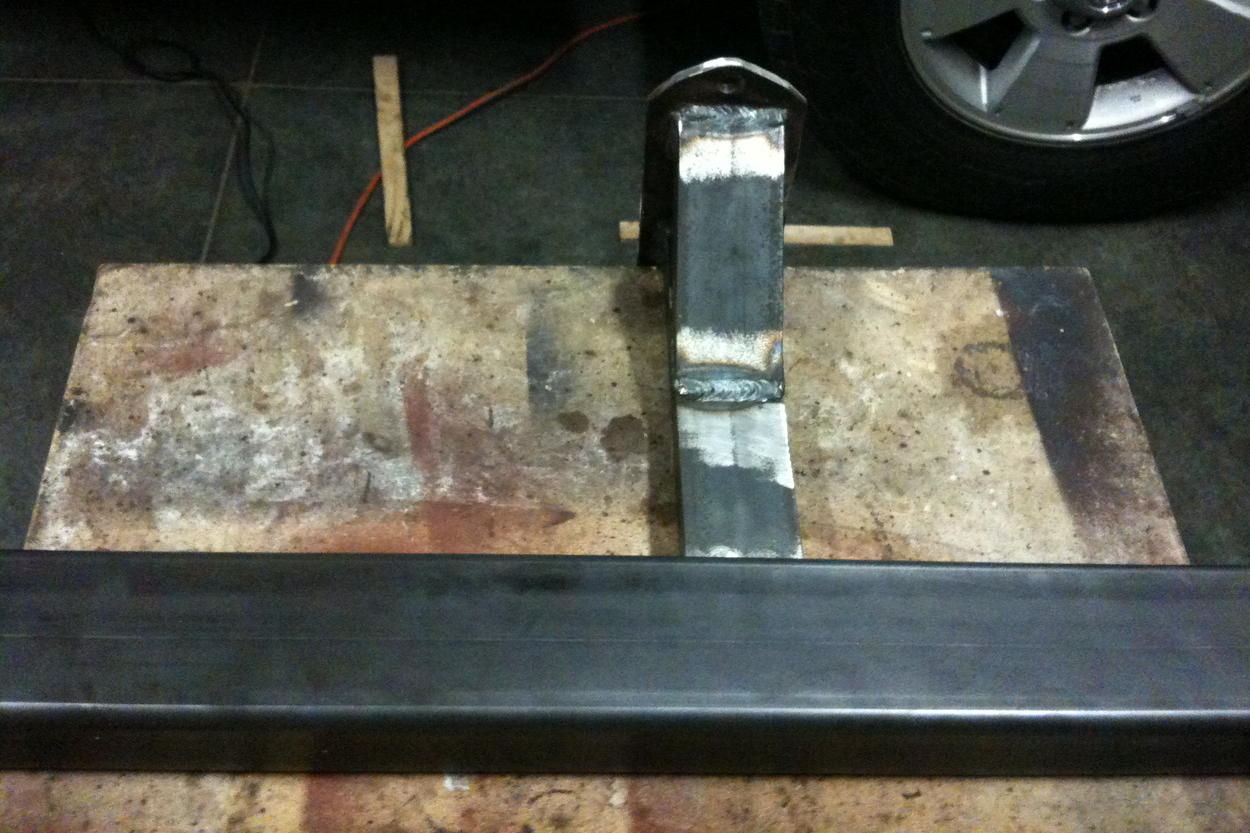

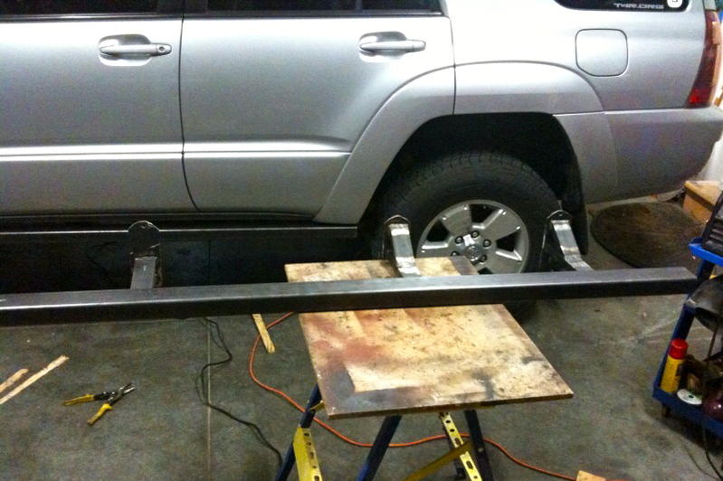

Just posting some pics of a set of sliders my friend is helping me build. He has built custom sliders on 3 different LC's and now my 4runner. Have the brackets cut and welded them to the tube today. Picking up some 1 and 3/4 tube to bend and weld into place this week or next. After that, paint and ready to go. Next mod will be an ARB bumper in the next month.

:bigok: Those look great. I like that they are truly "full length". It looks like your buddy does nice work.
Are you going to powder coat, paint, Rhinoline or what?
We are going to use a base coat primer and shoot it with semi gloss black.

So I figured I would post a quick question for you guys. Has anyone made sliders that the outrigger tubing is angled upward or do most guys bring the tubing out straight from the main square tubing? We have found that the rear flare that is attached to the door sits much lower and seems to rule out that option. With our goal of keeping as much ground clearance as possible I would hate to move the main slider down just to accommodate the tubing to be angled up. Figured I would see if anyone has a link to a post of 4th gen 4-runner sliders that have the tubing angled upward for my own curiosity as we have already welded the brackets into place and its placement is now decided.

I don't have sliders but I have paid attention to them. They seem to go either way on the 4th gens, angled up or straight out to protect and aid as an entry step. These are pretty cool to me and may give you some ideas. RockSliders

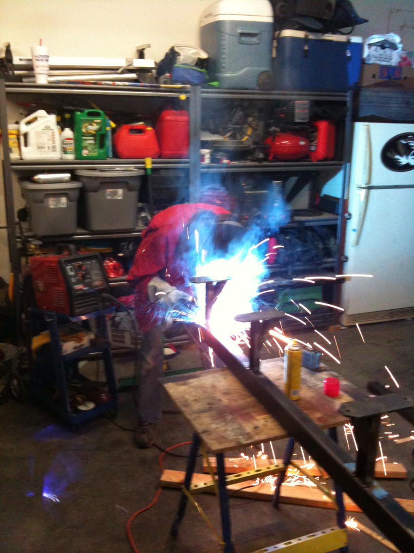

Welcome aboard Zane! So far looking so good on those custom sliders. :hatsoff: Hope there's nothing flammable (gas, thinner, etc.) behind you while you're welding.
Too funny! NO NO those cans are empty. Would be a hell of a issue if they had gas in them. I was wondering how quick someone would jump on that.
With cfairbank being a fireman as well as my best friend, I think I would get a beating if any flammable liquids had been that close to me when welding!!!
LOL, Jim carrey's Fire Marshal Bob from in living color comes to mind. I have a lot of faith in you Zane. You keep welding and I will make sure you don't set yourself on fire.

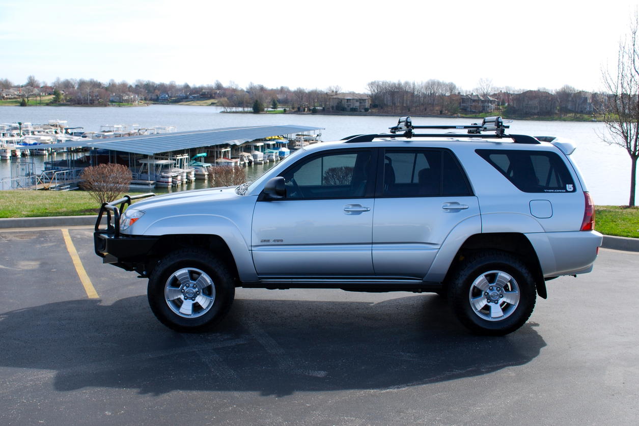

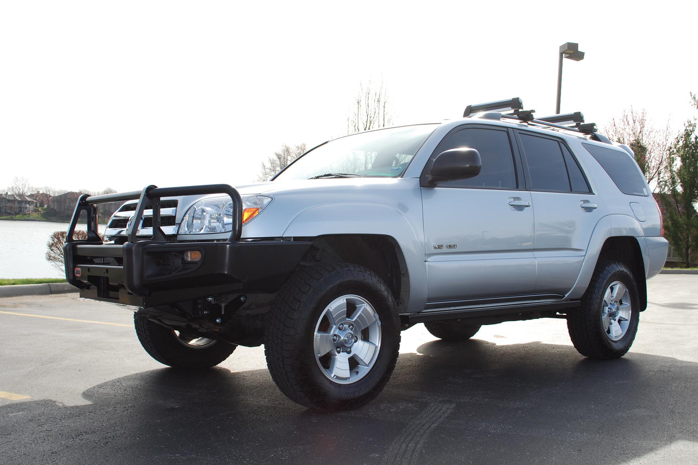

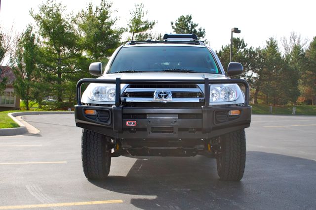

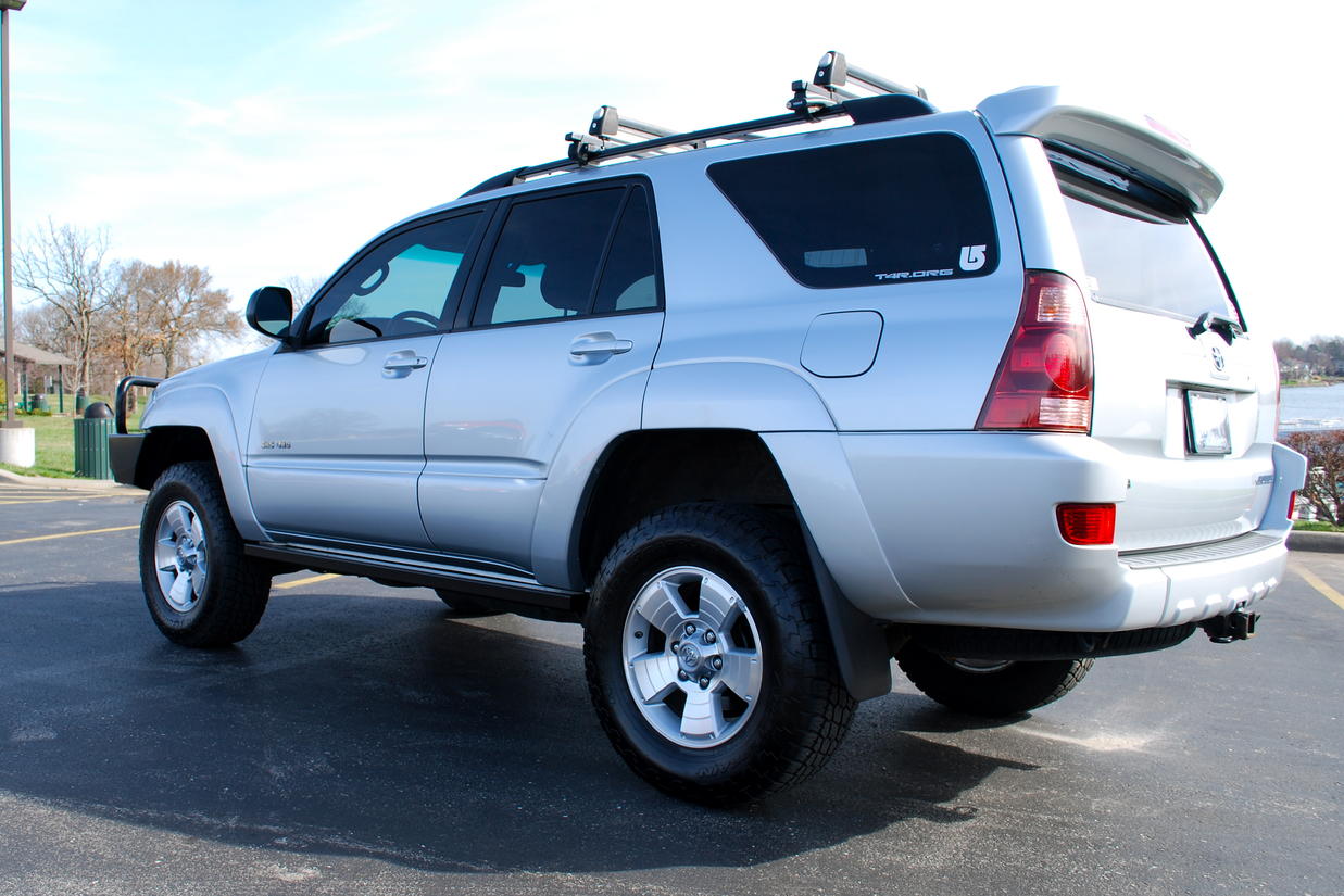

We finally put the sliders on last night. Still have to put the weld the tubes but will have to wait till next month. Leave for cruise moab at the end of the month and wont have a lot of time to get the tubes on before then. On another note my arb bumper came in and we installed that last night as well. Everything went pretty smooth just happy its done and dig the results. Hope you like.

Nice to see it in the daylight! It was a late night last night, but well worth the work. Installation of the sliders as well as the bull bar took us roughly 5 1/2 hours. Not bad considering we started at 6:30 PM!
