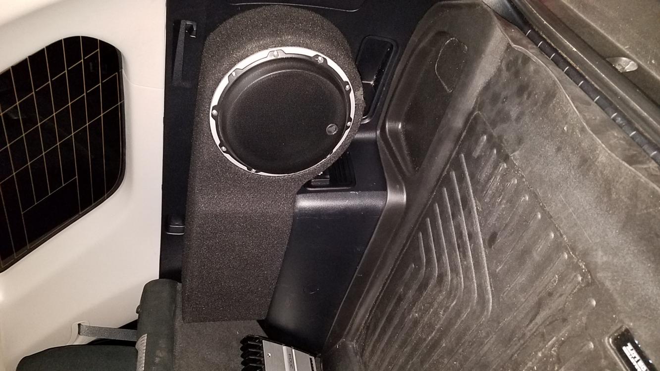

Custom fiberglass and mdf with jl audio 10w6

Do you remember some of the specs? (eg, depth, width at the bottom, volume in cubft)?
Which shop you went to? I'm in Orange County.
This was a DIY project. Can't remember the exact measurements but i did achieve the volume per JL Audio requirements for the specefic sub. Sorry not much of a help there.
