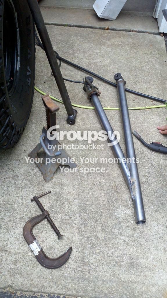

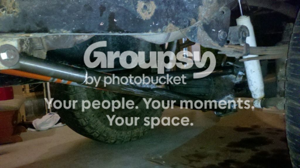

So for some odd reason, I decided to build myself a trac bar with my friend justin, and it's perfect!
We decided to make a single bar design because of the gas tank on the other side. We measured everything out and decided to do a slip-in design where a 1/4" thick steel tube would slide into a 1/8" thick tubing that was a little bit bigger for the perfect fit. This design would allow the axle to move a smidgen forward, up and down at the same time, and individually up and down (Flexing/articulating). But it did not allow it to twist underneath itself and cause wrap. We used rubber bushings I got from Summit Racing and slipped those into the custom 1/4" steel plated mounts that we put on the top and bottom of the axle, and also on the crossmember. The only issue we had (which sucked) was when we welded the top bar to the bottom one, we accidentally warped the inside of the tube, and the other one didn't slide in and got stuck! So we had to take it to a machine shop and shave the inside of the big tube and shave a couple thousandths off of the little one. 5 hours later, and success. Oh, and of course it's orange.

Looks good! The only thing that I would have done differently (based off several I have seen on pirate) would have to not have a slip type traction bar. Make the traction bar one piece with a 4-6" shackle coming off of the frame to hold the front end of the traction bar. That would allow the traction bar to move forward and backwards as needed without putting extra stress on the bar itself when it needs to move.
Good job, I like how clean it came out!
Do you have any plans on boxing the mounts you put on the axle?
I did consider the shackle but I liked the slip design more, it's extremely strong, and I wanted the mounts to be small and simple.
And I was definitely thinking about boxing in the mounts on the axle. I'd make a shield like design under the bottom one so it pushes off instead of grabbing my mount. But believe me, that mount isn't going anywhere soon, It's on there pretty good. And once I go down to college in TN next friday I won't have anywhere to fix it so I won't be wheelin too much.
