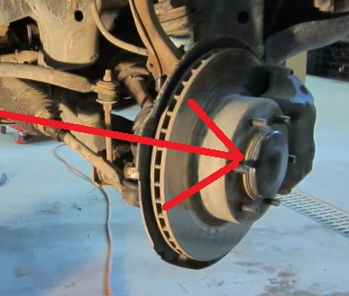

DOes any one know how to do it???
Already tried prying and using a rubber mallet, no success...
I have, and my wheeling friends, have ground down a small chisel or screwdriver into a very sharp edge. Tap this edge into the seam with a hammer. work your way around the cap. Eventually you will be able to pry it off. If you have rust, spray on some penetrant oil first.
