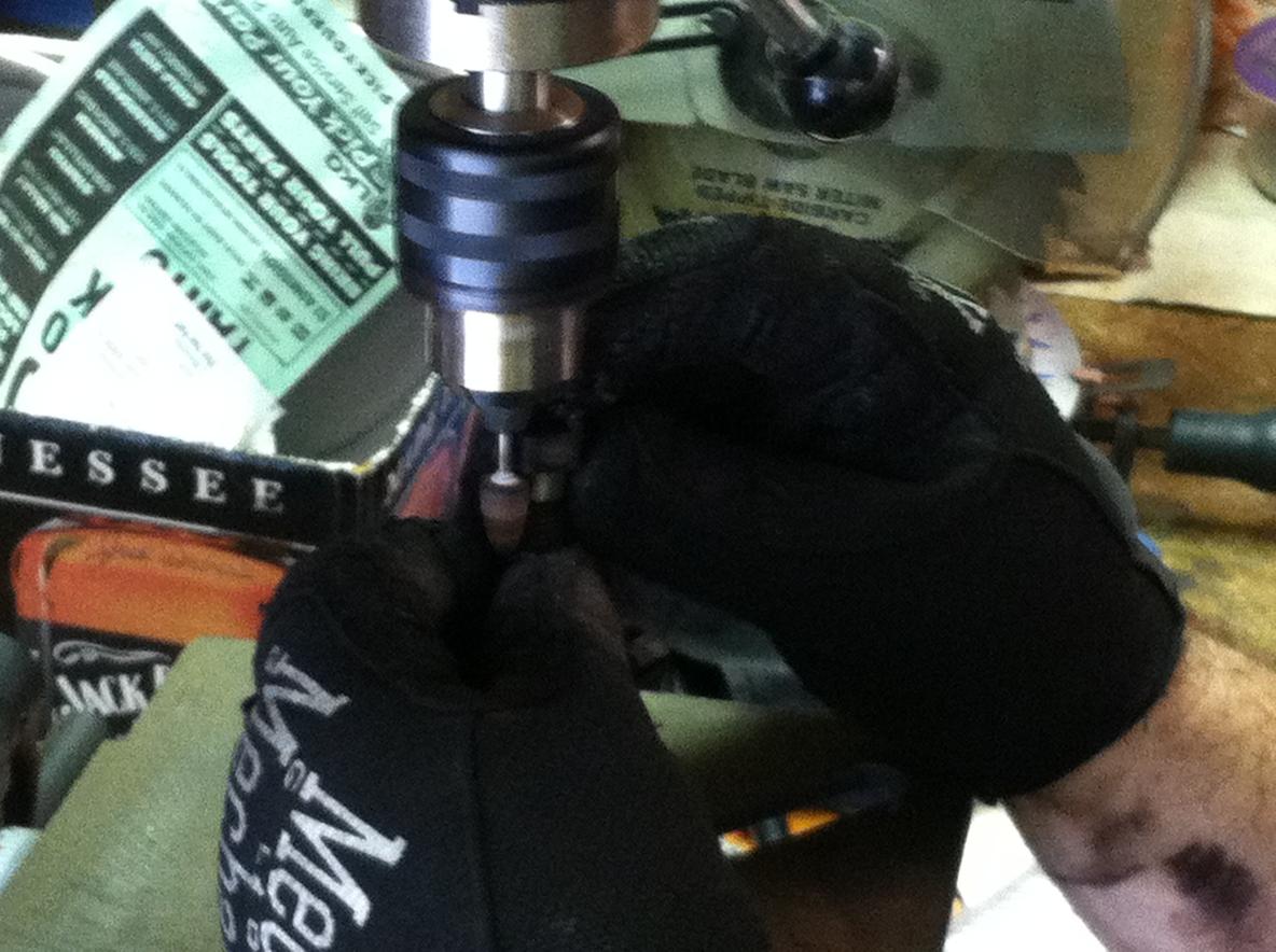

Factory ones are technically bolts (have a bolt head) but are splined so they are like studs and aren't removed. I knocked all of mine out and then simply ground off the splines to work more like bolts. Didn't feel like finding and paying for that many grade 8's. Having them removable is really nice.....made changing side oil seal or cv boots, much easier and faster.
I guess I'll find out if they're splined when I remove them tomorrow. If they are splined when I remove them can I put them back in without grinding down the splines. It's not a trail rig (yet) so I don't need a quick and easy trail method of removal.
I ground down the splines also(Thanks for the tip Hyde). I left a little on so they hold snugly but can still be pushed out by hand.
