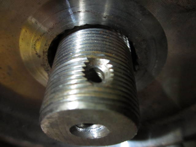

Has anyone ever tried chasing CV axle threads with a die?
I recently replaced upper ball joints on my 97'. I took the knuckle out to have a shop press old joints out and new ones in. I guess a hub spline damaged a portion of an axle thread when I was putting it back in and now the axle nut gets stuck at that point about halfway in. You can see the damaged part in the photo right above the cotter pin hole.
Well I tried prying the cv axle out but it just wouldn't budge. My mechanic quoted me $100 labor to come over to replace it. I was wondering if a cheap china-made eBay die and handle like this and this might do the trick. I wouldn't try to make new threads with it, but I figure I'm just chasing threads, but I don't know if the metal of the die is hard enough. Any suggestions will be appreciated.

It should come out. I just did mine today and use a pry bar. That snap ring inside can be a pain in the A. I think you will be ok if you get those. Keep in mind CV from a Auto Parts place is 55-70 (Core is 100)bucks. Toyota is like 300 new. This should not be hard to fix at all. Just take your time unless you would rather the mechanic do it.
Blue
Thanks, but just seems like a waste of a perfectly good axle, not to mention labor. I'm trying to get my mechanic to borrow a die to repair it for me. I thought about driving to a shop but guessing the axle will pull out when I turn.
OK, I'm feeling like a bit of an idiot but relieved. It turns out the axle nut was damaged. I got a new nut and it went right in. I thought I threaded the old nut all the way before getting stuck but now that I think about it, it was almost all the way through so I assumed it was the axle.
