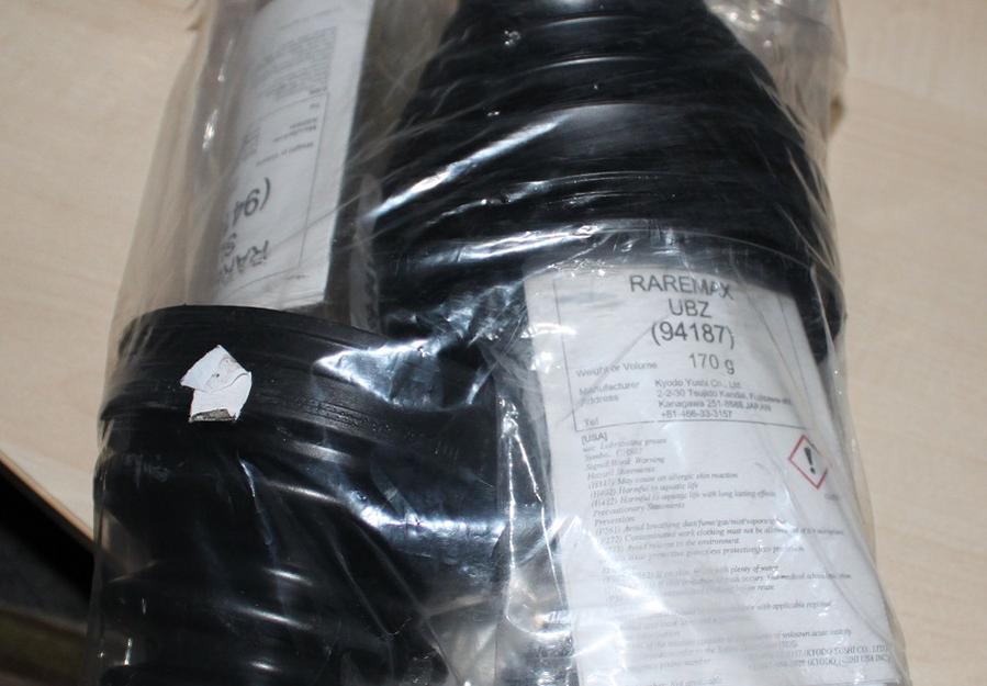

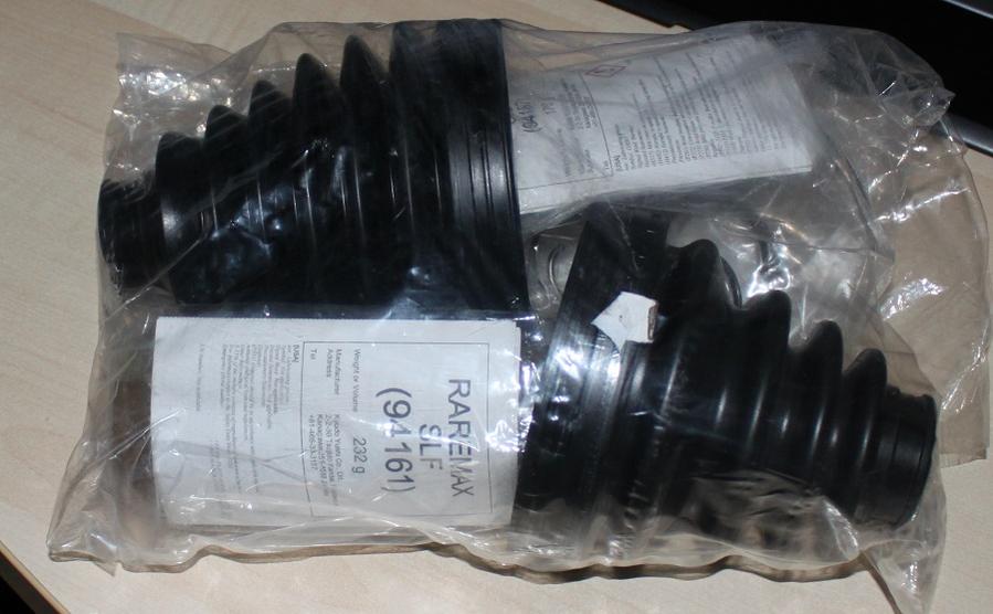

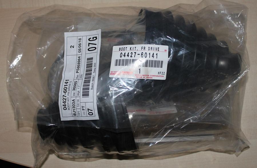

Same boat here.
Been putting off the CVs...I need to get with it.
I went the OEM/eBay route...$53each x2.
Boot kit, has all the grease and band clamps you need.
Sitting on the self...

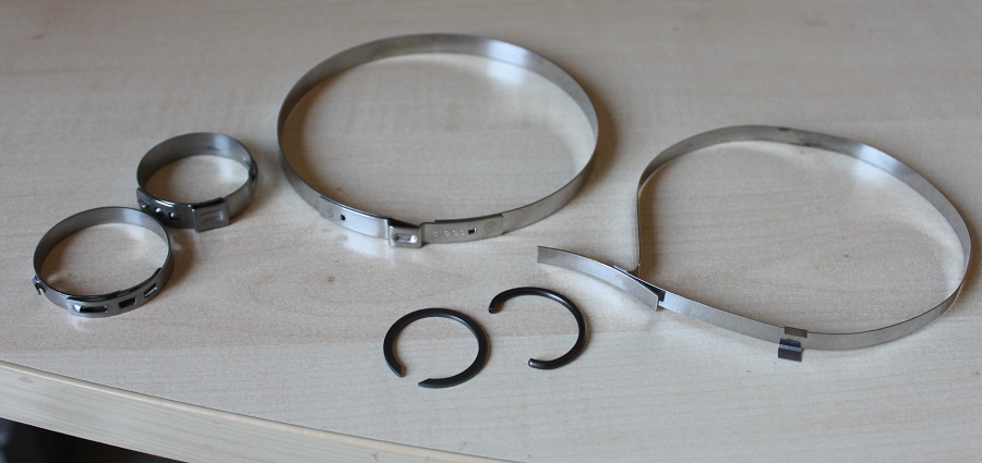

In regard to the band clamps.
In this kit each clamp is different.
Also has a flat C-clip and open C-clip thing-a-ma-jig.
