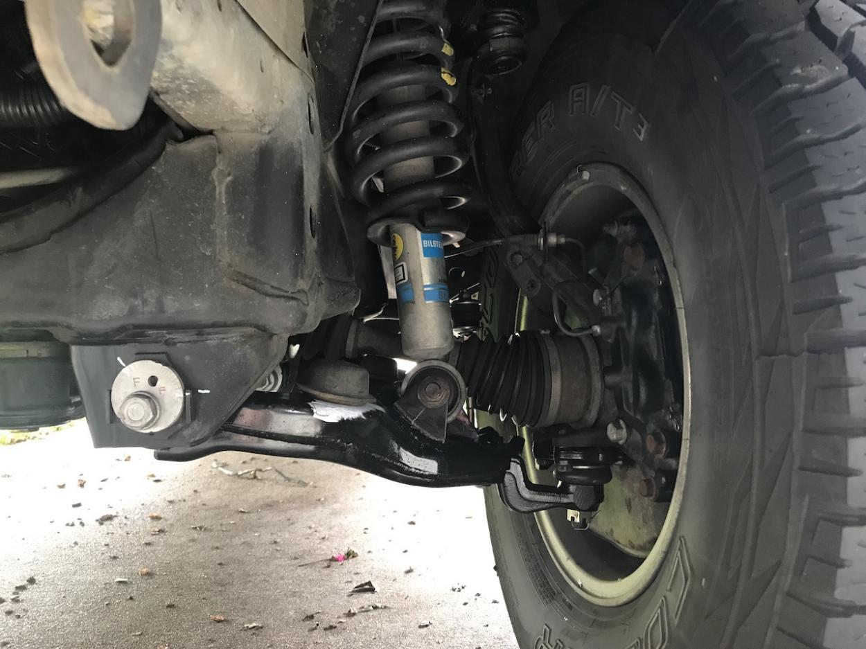

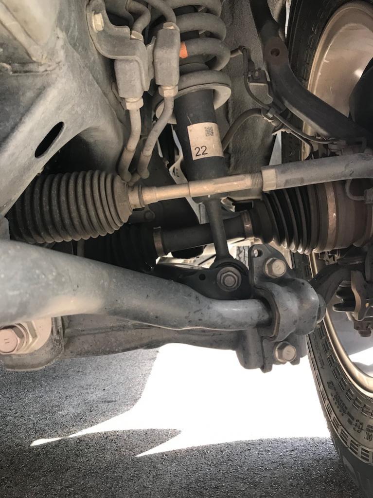

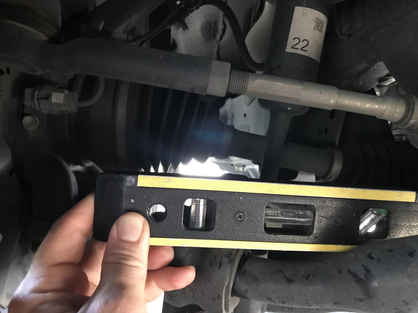

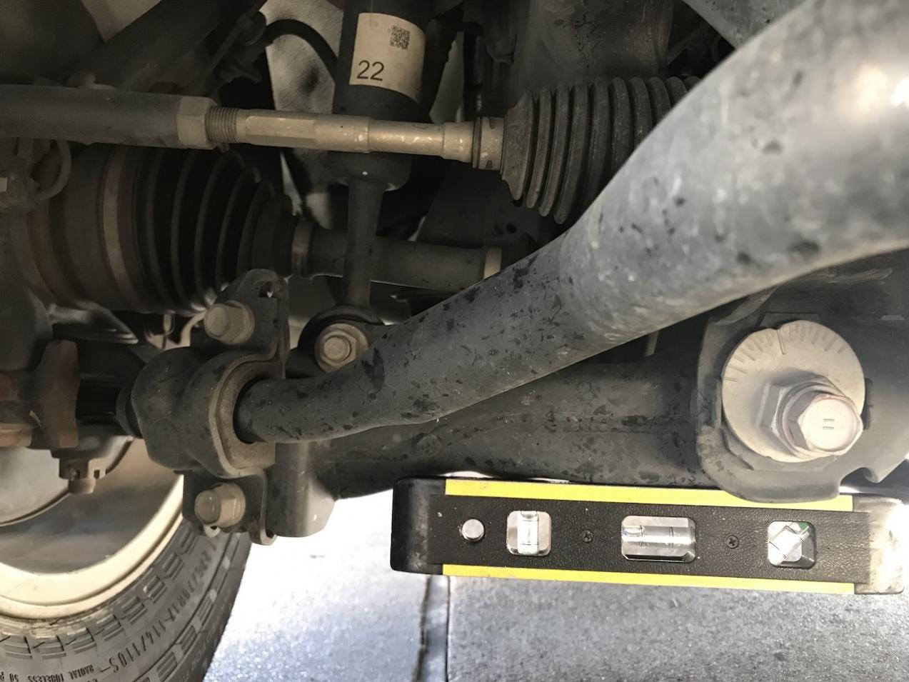

Was changing my oil last night at 50k and noticed that my CV axles angle up to the wheel hub rather than straight across or down as people often see with a lift. I've never noticed this before and wondering if this is normal? Are my springs shot already? Is this an alignment issue with the cam adjusters?
You can see from the pictures the LCA has very minimal up travel before making contact with bump stops.

This is my 3rd gen for comparison (having approx. 2" lift from stock).
Yep. I noticed the same thing a few years ago
It makes you feel better about having them flex the same amount downwar, afterward when you’re done lifting.
Those CV boots are tough
TO OP: yes, CV axles angle up on stock suspension. This has been the case since 4th gen of 4Runner (since 2003), so there is no problem with your truck...
2" lift makes CV axles almost parallel to the ground :laugh:
