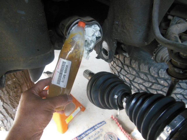

I got 2 sets of oem boots and I'm just going to reboot 2 oem shafts I found at the yard. Keep them as ready to go spares.

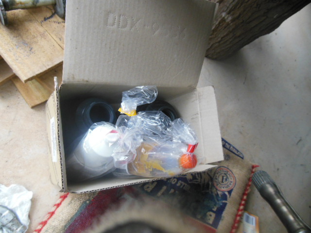

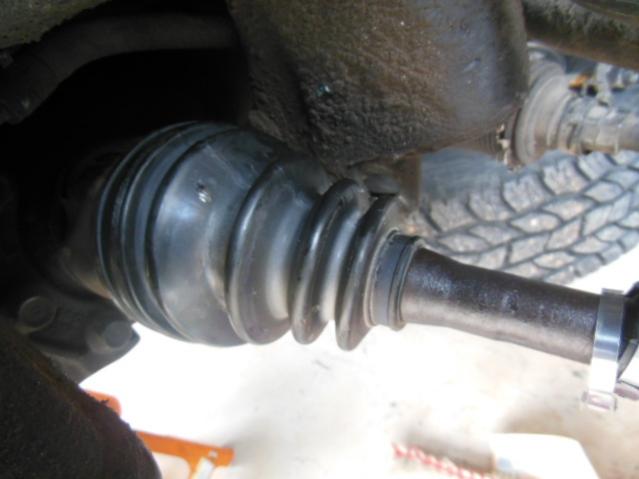

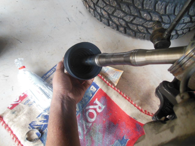

If you have OEM CV axles, just reboot those. Aftermarket CV's are weak and also unbalanced, hence pulsations and vibrations at high speeds.

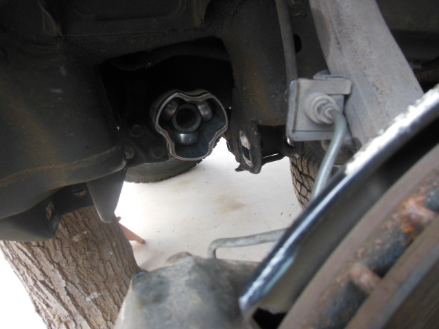

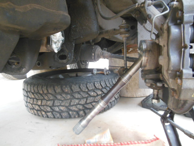

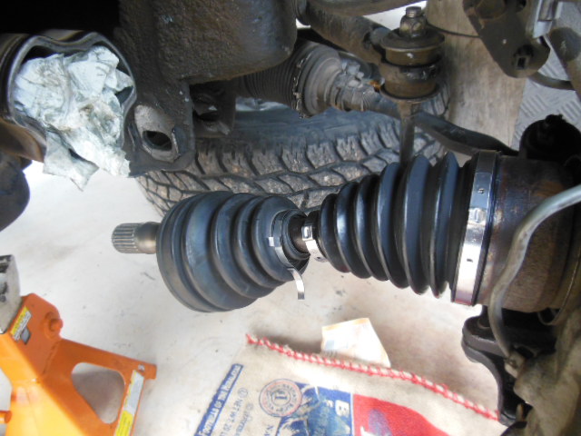

It's easy to replace CV boots. No need to remove the CV axle from the hub or from the diff.
1) Remove upper or lower ball joint (no need to remove LCA: I was installing bushings at the same time)
2) remove the clamp on inner and outer CV boots
3) Pull the boot off the inner joint
4) Remove C-clip and pull the tripod bearing
5) Remove both inner and outer CV boots off the shaft.
6) Slide the new outer boot on to the shaft, pack grease and install clamps
7) Slide the new inner boot and then tripod bearing, install the C-clip, pack with grease and install clamps.
8) Install the tripod bearing into inner joint and install clamps
That's it. I did it about a month ago and it was super easy.

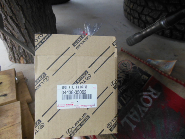

Buy OEM boots Toyota BOOT KIT FR DRIVE 04438-35062 : Same part number for both sides: Each kit comes with clamps, grease and two boots per side

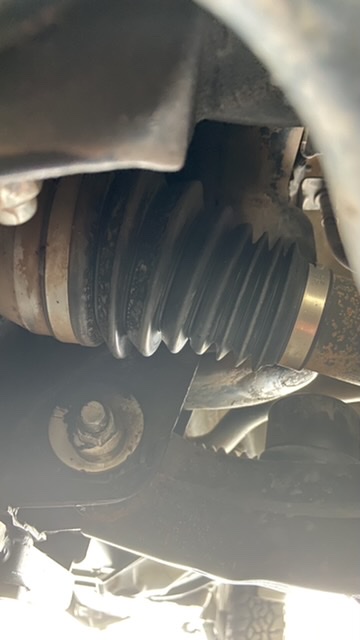

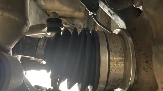

I have about 1000 miles on the Napa “lifted applications” set of CVs. The boots don’t seem to rub it all with a 2 inch suspension lift on 265/75s.
Napa part number is 94–1258. You’ll need to reuse your old CV nut though as the one that Napa ships with it does not fit the Toyota keeper well.
