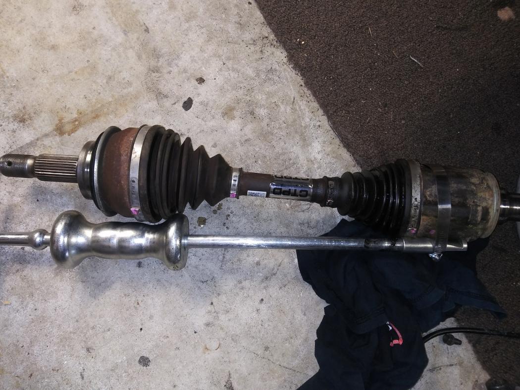

Ok, so we're back at the same point again - disassembly was easy and fast. I can't get the damn thing off...I'm applying pretty good force with the CV lasso (as evidenced by the rope actually getting wedged and stuck) and no joy.
https://i.imgur.com/jYxoxaQ.mp4
https://i.imgur.com/0kBrnyd.mp4
I literally get the biggest flathead I can find, wedge it on the lip that the lasso just missed, and apply pressure to the diff housing, not the seal and she pops right out. That or a cold chisel on the flat nubs on that inner cup with a HEAVY hammer, I personally have used a 4lb shorty sledge, and out she falls.

I got it pretty quickly after trying again with just turning and using LESS force to tap it out with the lasso.
