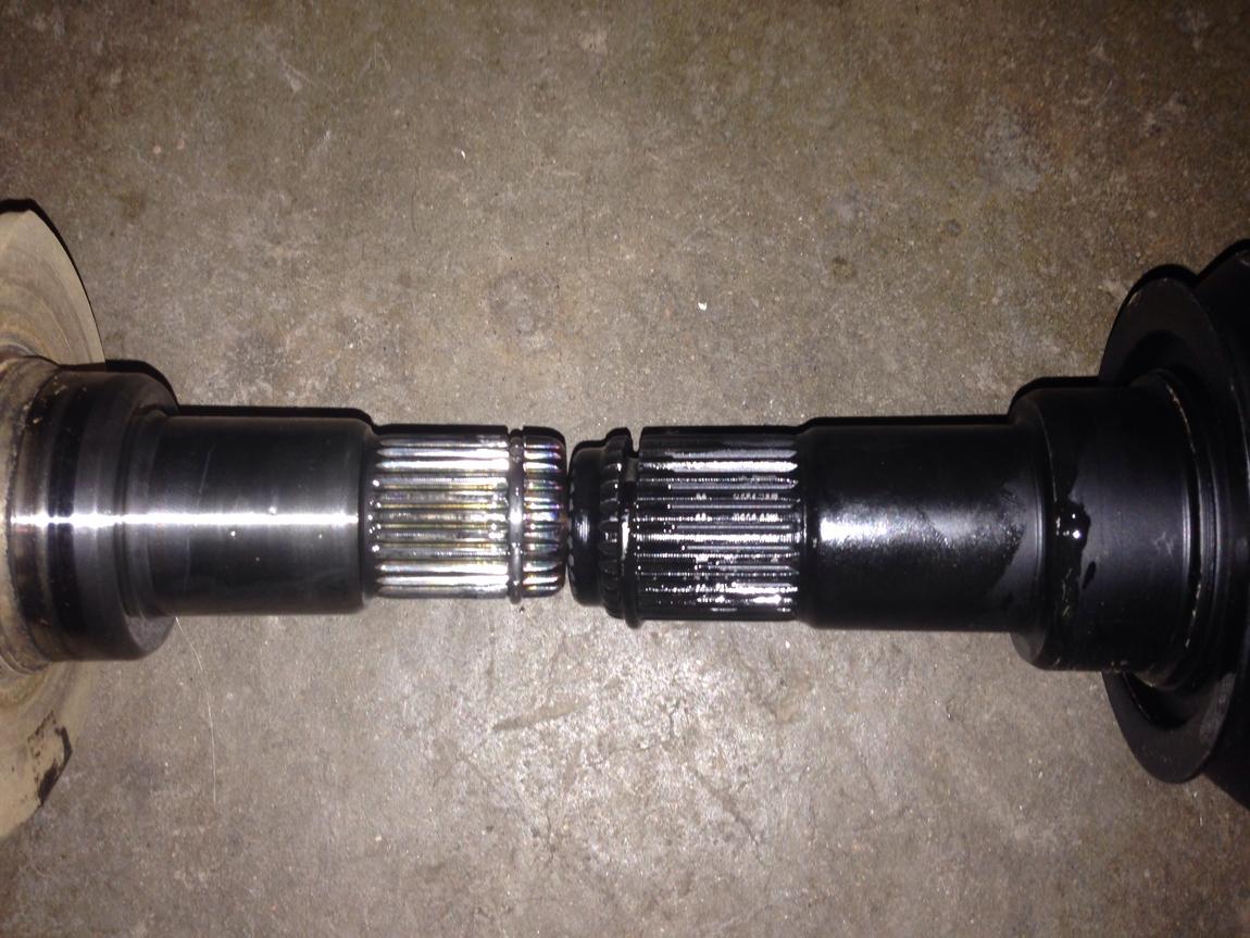

I bought some CVJ axles to replace my stock CVs. Popped one of the old ones out and tried to put the CVJ one in, but no luck. I pulled it out and compared the new vs old, and the diameter at the splines is bigger by several millimeters on the CVJ!
Has anyone had this issue? I'll call them in the morning but for now I guess I have to put my old one back in...

Bummer man, are the axles the same length?
I haven't heard of this before, mine from CVJ were fine. I'm guessing they just screwed up when rebuilding and put the wrong inner on. The left one in your photo has flat splines to the end, and the right one (CVJ) has a bottle cap look, so something isn't right.

I didn't check the exact overall length, but they seemed similar if not the same. But on the inner, you can kinda see in the pic, the whole inner is longer than stock, by close to a quarter inch. I'll see what they say in the morning I guess

Well I called them up and they said they shipped me the part number for an '03+ t4r. They're shipping correct ones out today.
Great customer service, I think he just misread my first email when I was asking for a quote.
