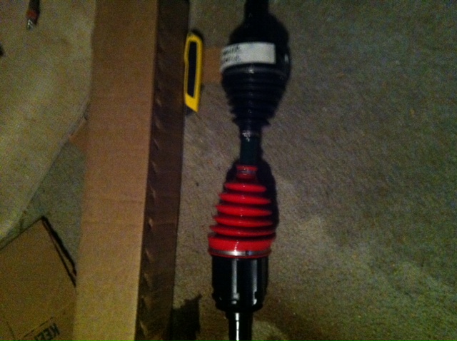

Just did mine from CVJ and they worked out perfect. They shipped with a section of PVC pipe around the end so the covers cant get bent in shipping. The extended travel boot upgrade is well worth it.
I'm torn b/w going with that upgrade too. Since its relatively expensive, extra $39 per side, I'm not 100% sold on it yet. From what they told me on the phone, it is much longer and leaves very little shaft exposed. I was also told that it has 3-4 times more bellows than the OEM boot...4 vs 8-12. Can you confirm this? Also, any pictures?
That is correct: Pic below shows the more like 3-4 more bellows but it's very worth the 40/side. That way any lift you have or may want to in the future it can accommodate. they just seemed more durable to me and I don't want to replace again. Hope it helps. Let me know what you decide. sorry for the crap pic. The red boot looks cool too.

Nice, thanks for the pictures. Those look pretty good. I'll definately be going with those boots whenever I order mine. Do you have any pictures of them on your truck? I'm just curious to see what they actually look like on a lifted truck in the neutral position.
