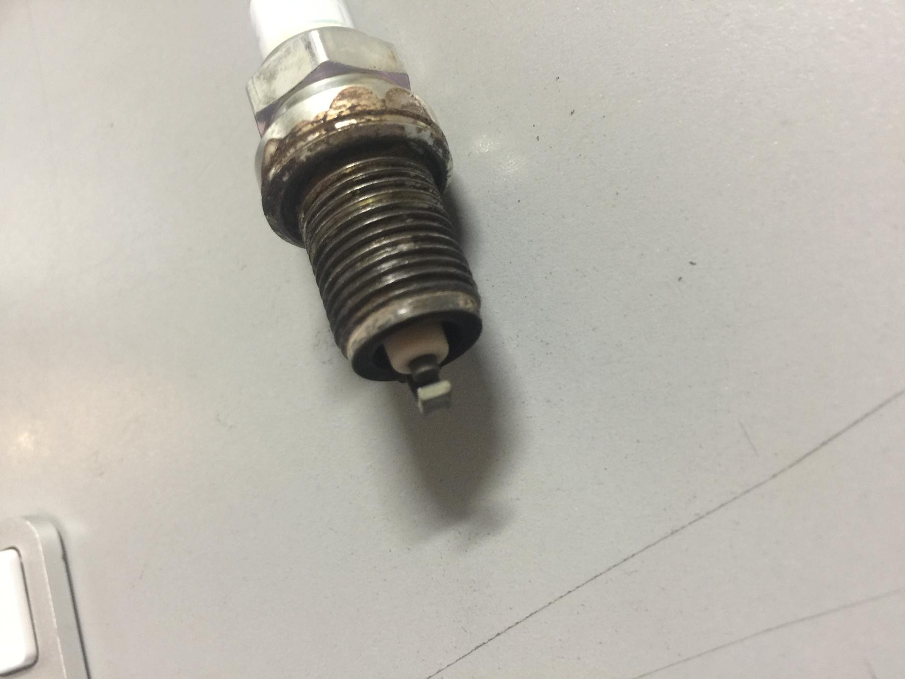

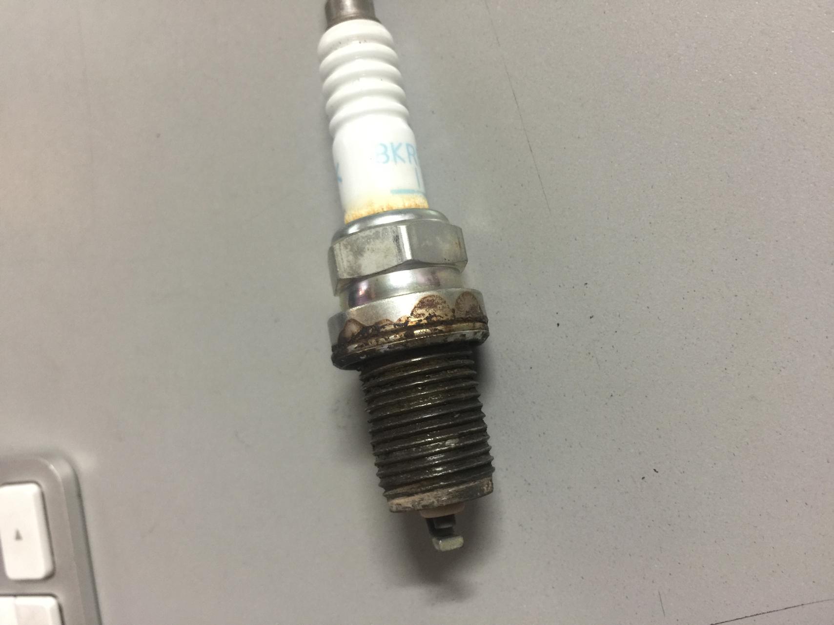

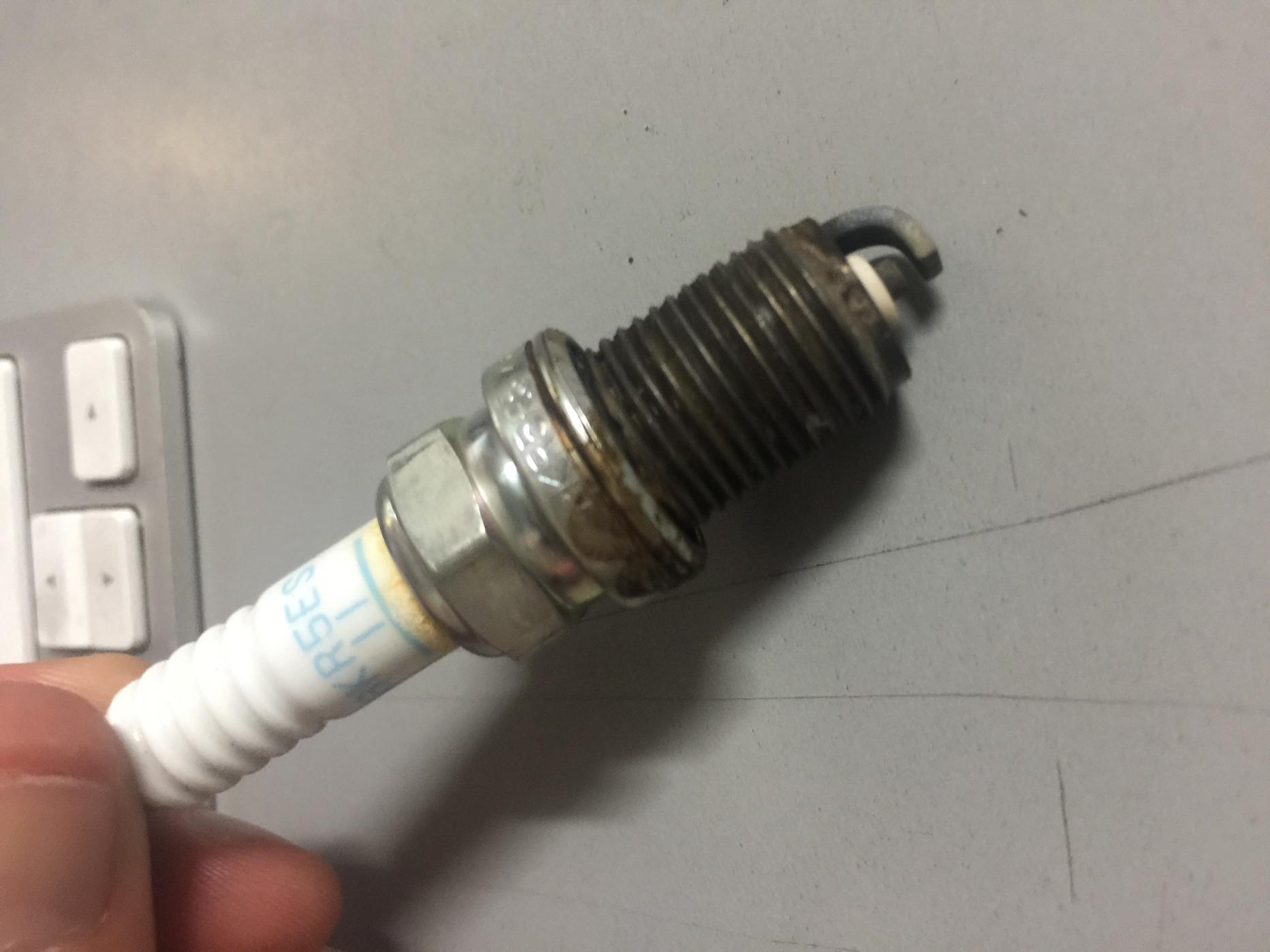

I have a 2000 4 cylinder and the #2 cylinder spark plugs keep failing. I get about 1500 miles out of the plug and then I get really bad hesitation around 2,000 RPM. I switch out the plug and it works fine after that. Only happens in the one cylinder. Any ideas? I have replaced the seals around the plug tubes and still have the issue.

I will take a picture when I get home tonight.

It still looks like you have some kind of leak from the spark plug tubes since there is burnt oil on the body of the plug. I'm not convinced that would make the plug go bad though. One of my plugs is covered in oil all the time (my valve covers are leaking in multiple areas) and my plugs are fine and it runs perfect.

The plug tip and electrode look decent, but based on the fouling and staining on the threads and hex I'd say it was possibly cross threaded and re-tapped at some point in it's life? Or wasn't tightened down enough and is leaking. Do you use antisieze on the plug threads?
