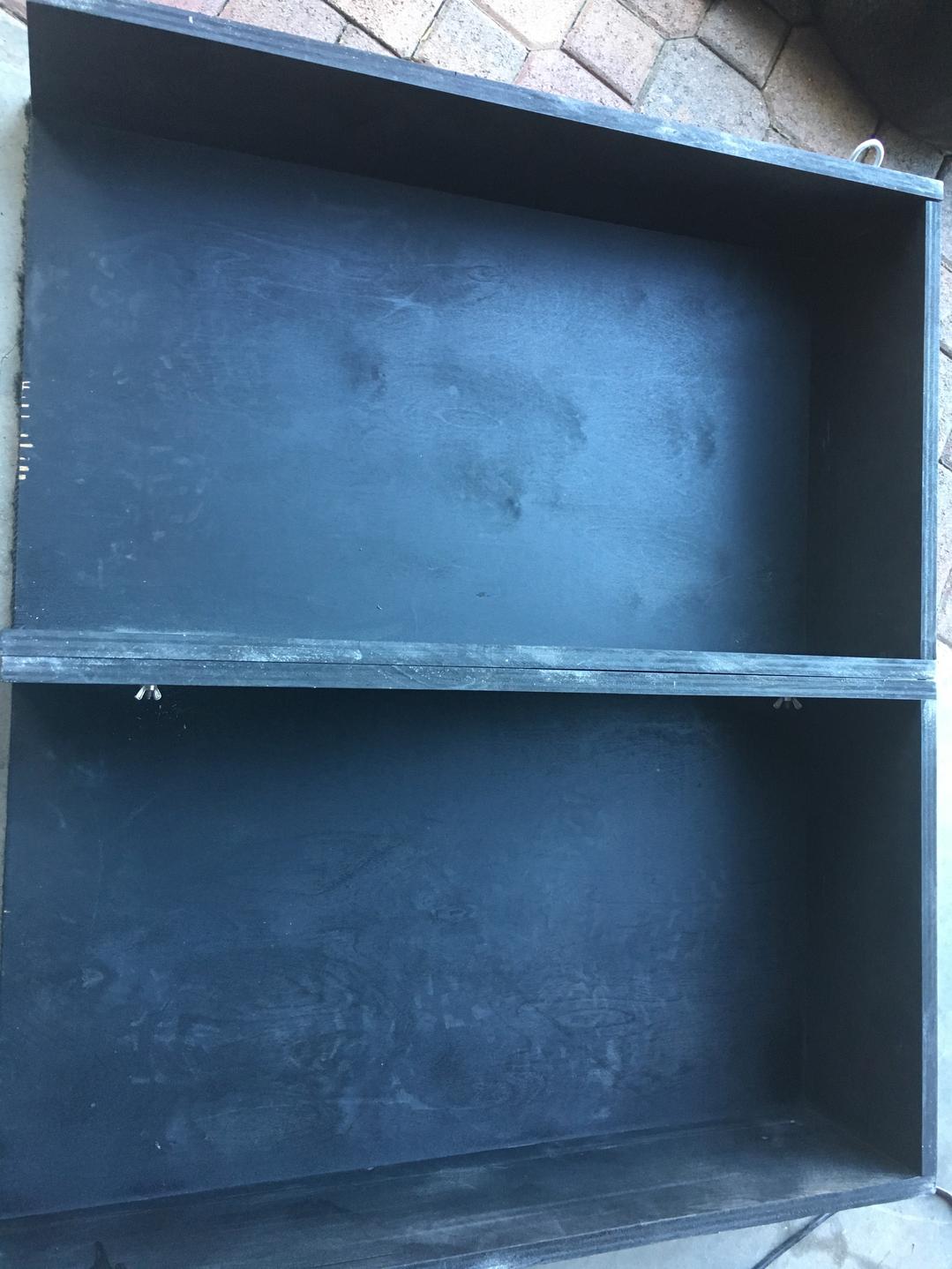

August 2017: Storage System Build

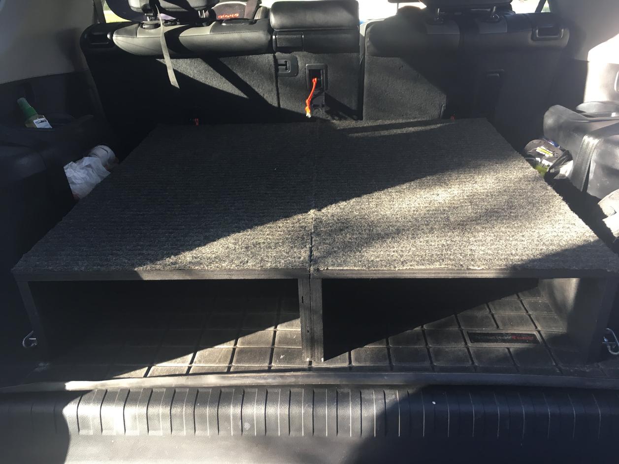

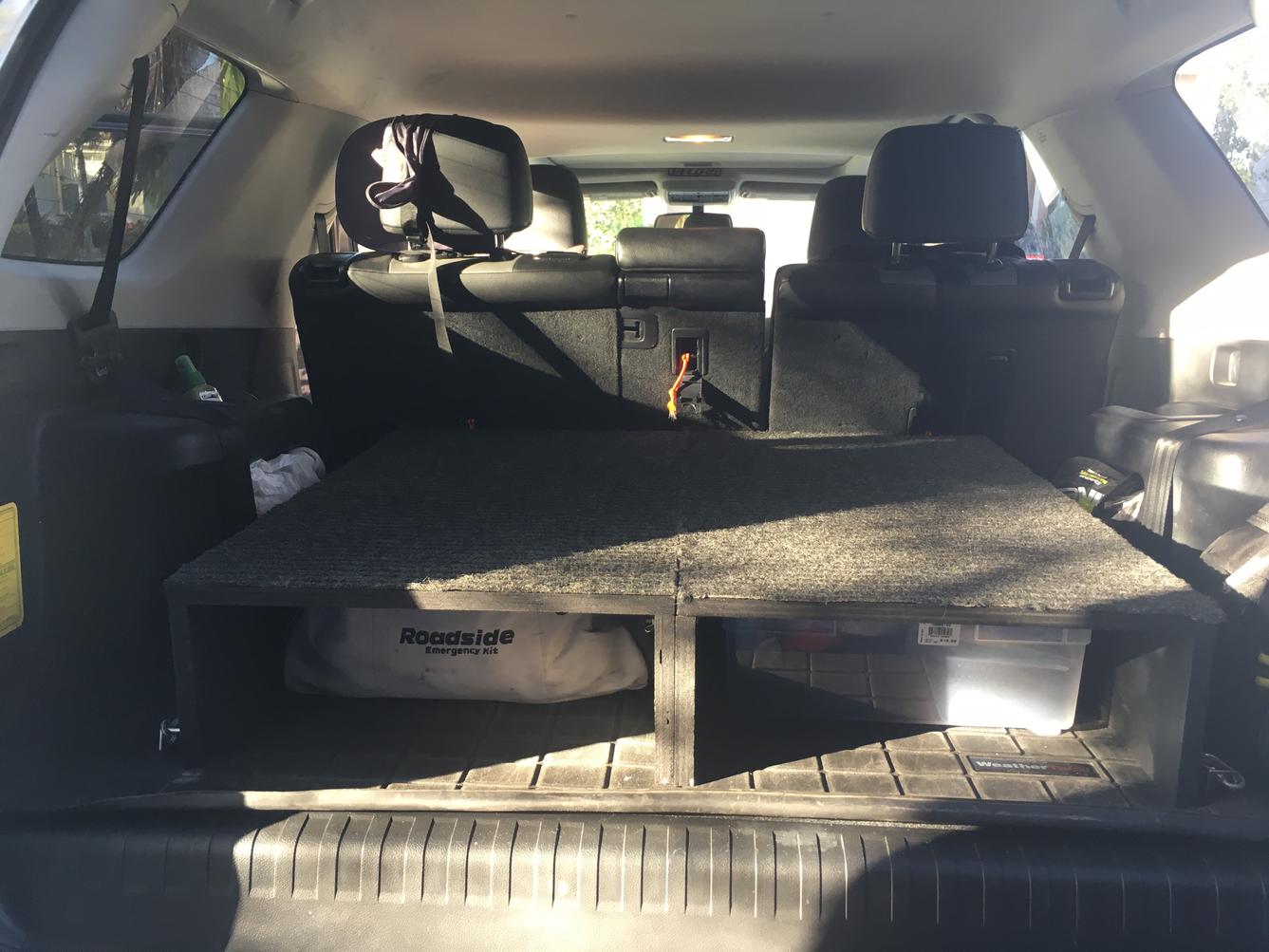

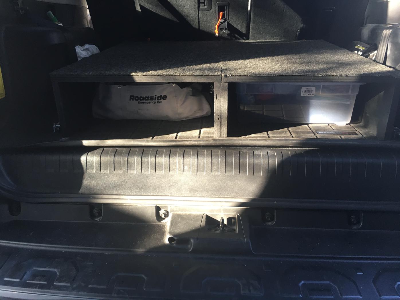

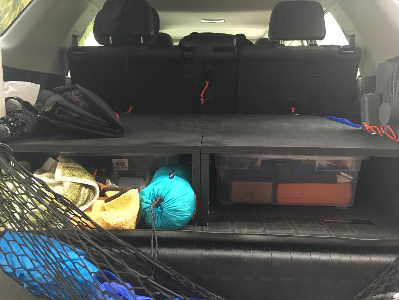

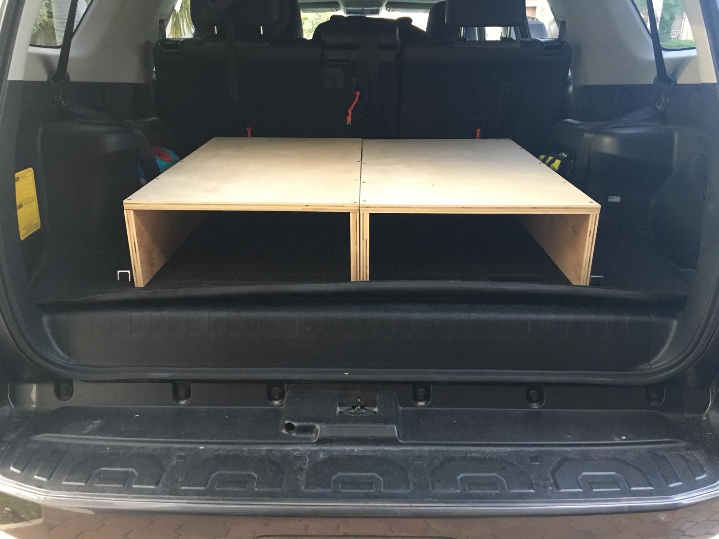

One thing that I’ve been researching and trying to figure out for a while is a better storage system for the back of the 4runner. When camping/exploring we’ve just been using storage bins. I like the practicality of just loading up the bins of equipment that we need but it does make it a pain when they are stacked and lashed to get what we want out quickly without the whole cargo area turning into a mess. So after looking through many threads and ideas this is what I came up with for now based on the following requirements.
1) Low enough height to be able to still put the dog crate, cooler and travel bins/suitcases on top. I lose about 6” already with the 3rd row.
2) Modularity: I needed the storage to be easily removable, and to be split so that we could put one 3rd row seat up at a time, and even potentially stack the storage boxes.
3) Secure attachment points.
Materials:
- 2 x 4x8x3/4 Birch Hardwood Plywood:
Tops: 2x 18.5"W x 32"L
Sides: 4x 6.5"H x 32"L
Backs: 2x 6.5"H x 17"W
- Wood Glue
- 1.5" Wood Screws
- 2x 2" Bolts (I used extra that I have for our hurricane shutters) with wing nuts.
- 4x 1.5" Wire Rings https://www.homedepot.com/p/Keeper-1-1-2-in-Wire-Ring-2-Pack-04521/203294978?cm_mmc=Shopping%7CTHD%7Cgoogle%7C&mid=shFwgTTzb%7Cdc_mtid_8903tb925190_pcrid_111415246385_pkw__pmt__product_203294978_slid_&gclid=Cj0KCQiAkZHTBRCBARIsAMbXLhHJEWoP_4lSFHGaO4kmdUA1HLCqtlkTTwODpRzMo0_o2_vmwJMxxTEaAvvaEALw_wcB Used to attach to factory tie-downs.
- 4x twist lock carabiner https://www.homedepot.com/p/Everbilt-3-16-in-Zinc-Plated-Quick-Link-42714/205887919 To attach the wire rings to the factory tie-downs.
As of now we are using under-the-bed storage bins from the container store that fit snugly in each section with about 6” of space to be able to put things that I want to easily access (towels, diaper changer, picnic blanket, etc.). One bin is filled with my paired down recovery equipment, emergency kit and tools. The other is filled with basic camping supplies, lights/flashlights.
The two storage sections are attached to the factory hooks with d-rings and then attached to each other with bolts and wingnuts, which allow it to work as one solid piece. To split them so we can use one of the 3rd row I just unhook one of the sides and unscrew it from the other section. I can take the system in and out of the truck or change it into the ½ section in less than 10 minutes.
Final step was I cut and attached an old Indoor/Outdoor carpet we had at our back door to create a softer surface on top of the wood boxes.

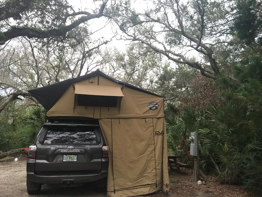

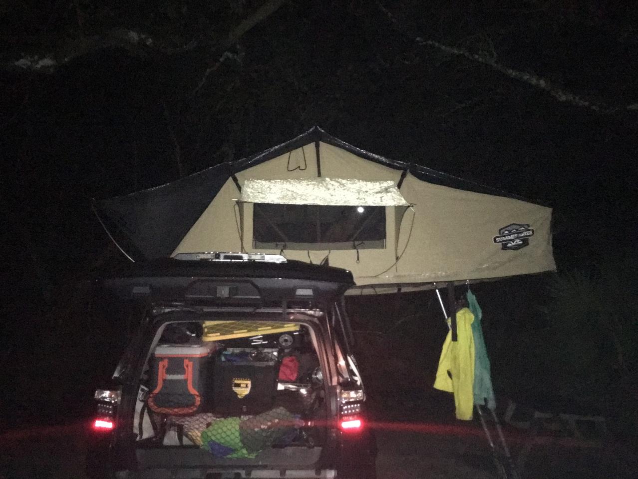

Our first RTT Adventure St. Augustine Labor Day Weekend 9/1/17 -9/4/17

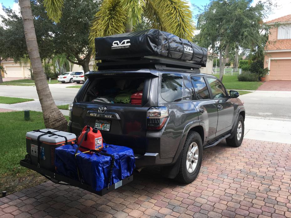

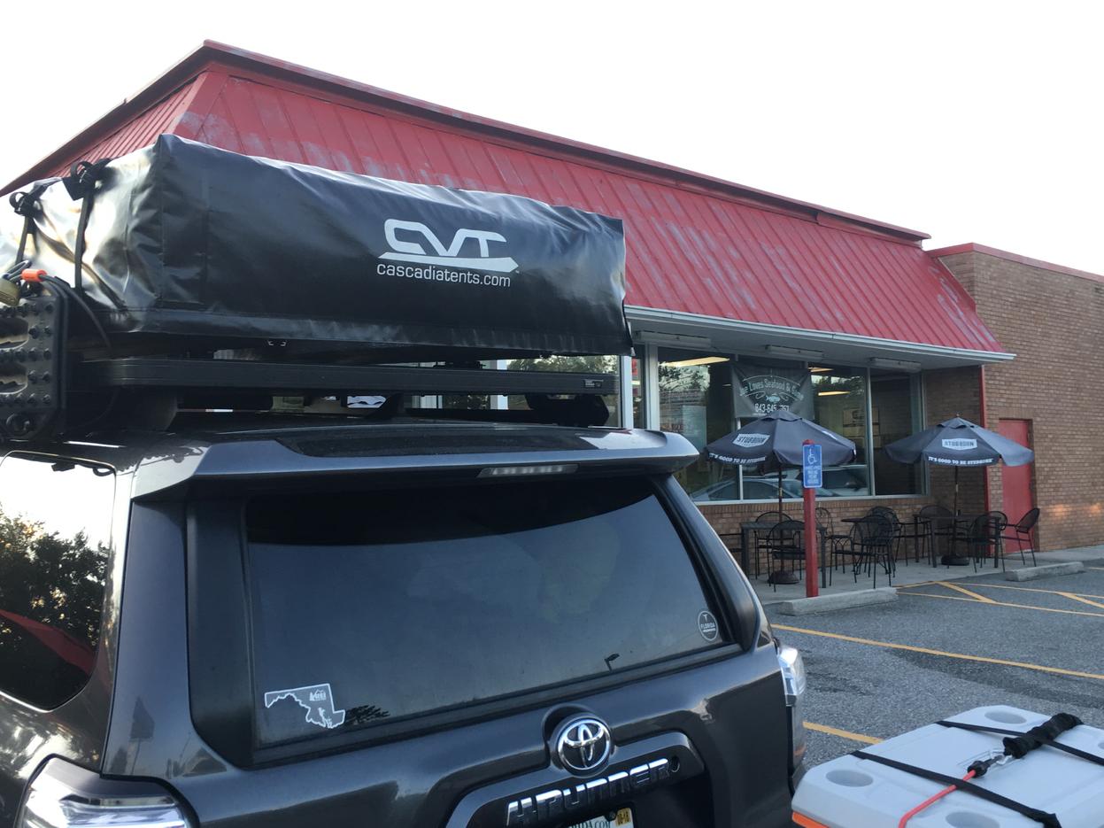

The driving experience with the RTT on the rack really isn’t any different then when we traveled before with a fully loaded skybox. I could feel a little more weight on the roof, but the gas mileage hit was actually a lot less then I expected (only about 1 mpg) as we still averaged just under 17 mpg for the trip. We arrived at our Campsite just north of St. Augustine (North Beach Camp Resort) just after 11pm in the middle of a thunderstorm. Both kids were asleep, so we decided to just make a go of it and see if this RTT set-up was really worth it. Honestly for our first time we were efficient, got the tent open in less than 5 minutes in the pouring rain, my wife jumped up in the tent and finished interior set-up in another 5 minutes (hung portable fans, which is a must in 80 degree night with high humidity) as we pre-packed all of the sleeping bags and pillows in the tent before the trip. I got everything else we needed for the night ready under the rear hatch of the truck during this time. We transferred the kids up to the tent and they were out for the night. We climbed up, found the best arrangement for where we should sleep and went to bed.
All in all this is why we now have a RTT to camp in Florida. The airflow is so much better off the ground, we set up in about 10 minutes during a thunderstorm in the dead of night without getting absurdly wet and keeping all of our bedding clean and dry. The mattress was comfortable, and it was the best nighnight of sleep I’ve had camping in years. The tent held up well in the rain, not a leak or drip of water inside (as to be expected with a summit series tent) and the condensation mat kept the mattress dry as a bone.
The one negative to the RTT as everyone will note is the having to pack it up every time you need to drive out of camp. This is a pain but not a deal breaker. It does have us thinking that the next big purchase will likely be some sort of trailer to put it on…really liking the price point, versatility and weight of the Space Trailers.

How much did that RTT effect your fuel econ?
About 1 mpg when traveling on highway, averaging about 70-75 mph. On the trip up to Hilton Head the speed limit on highway is mostly 70mph. We’ve been averaging between 16.5 - 17 mg fully loaded on our trips with it, actually about the same as with our trips with the fully loaded Skybox and Sportube as you see in the pics above. I’m actually surprised as I thought it would effect the gas mileage more than it has. You can feel the weight of it up top, on turns and breaking but no more than when we load up the rack with other stuff. I’m also running stock suspension, so upgraded shocks and springs would likely help in that regard. It hasn’t been an issue but it is something I try to be mindful of, leaving more space for breaking and taking sharp curves more conservatively.
