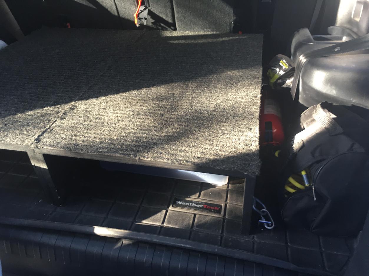

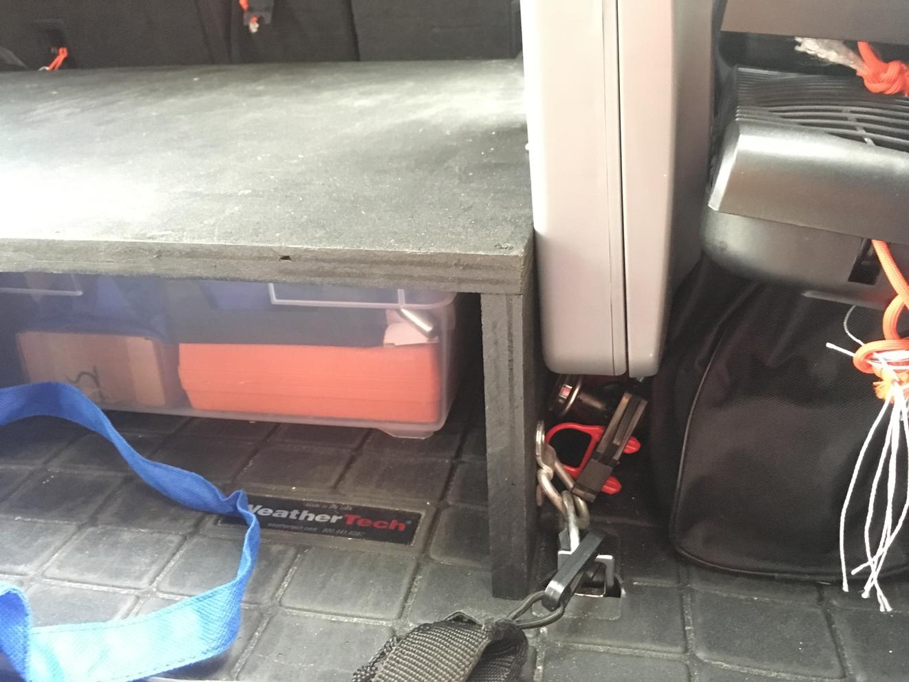

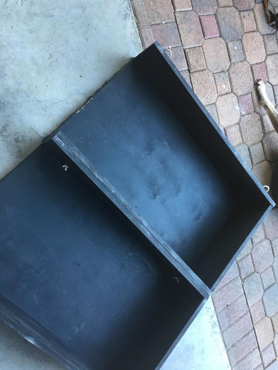

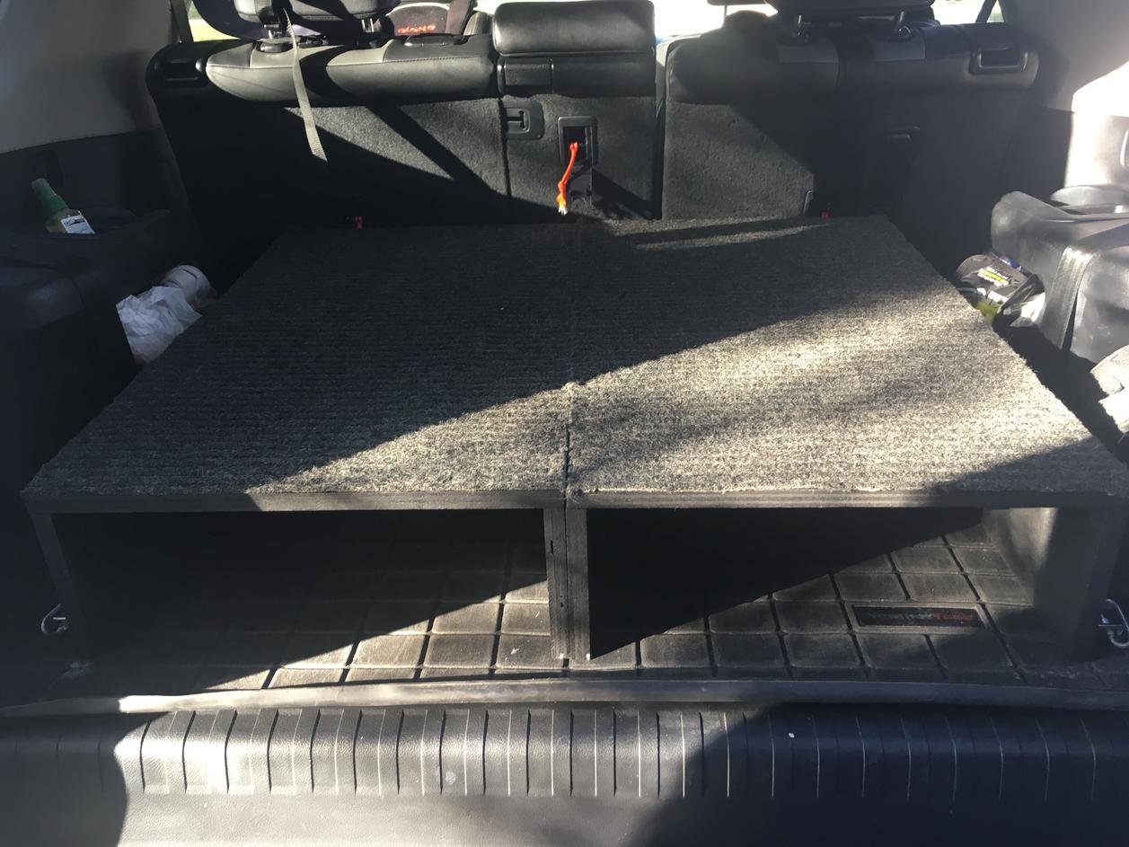

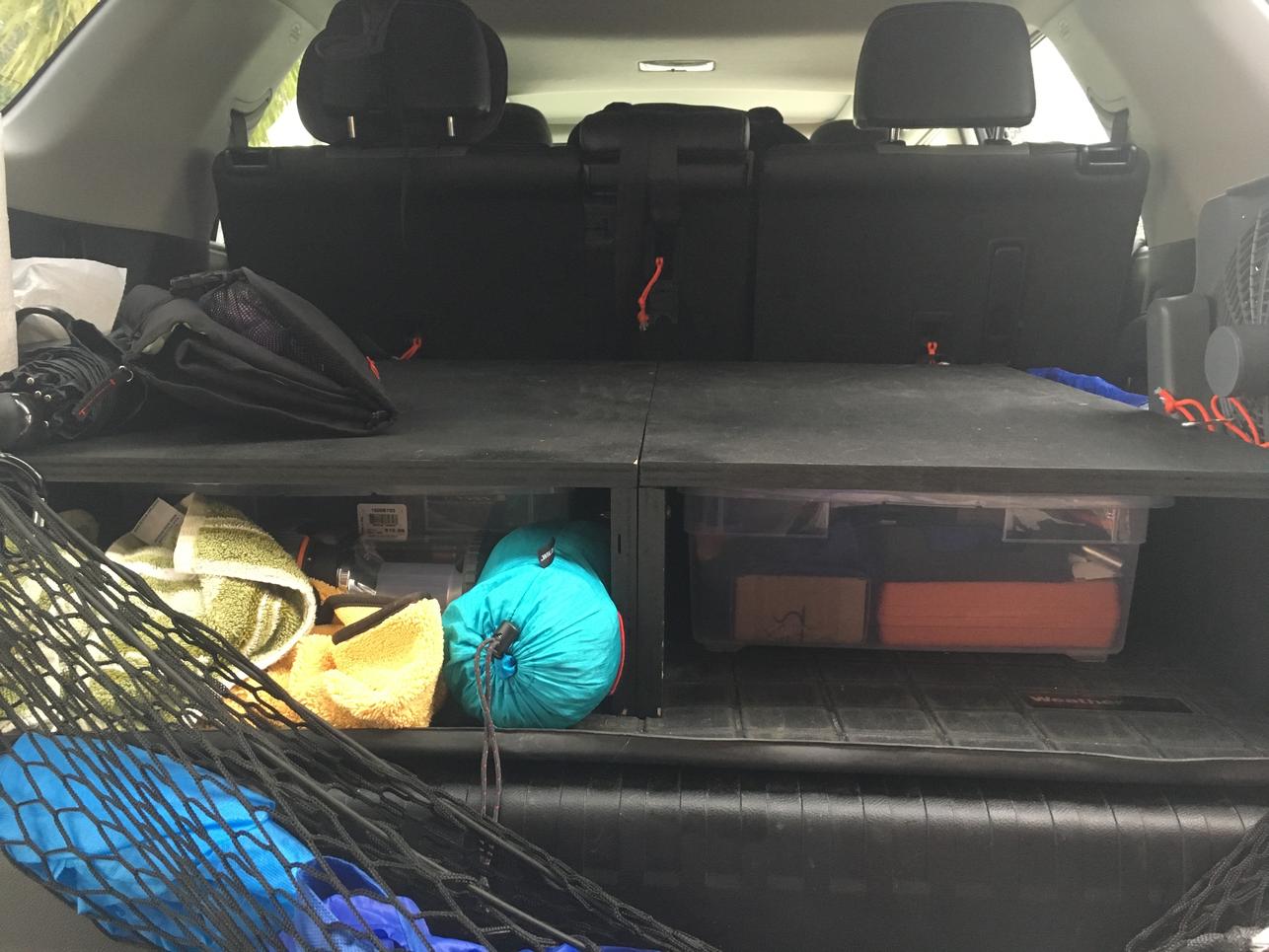

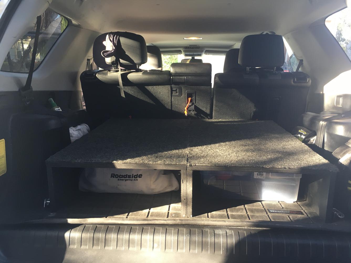

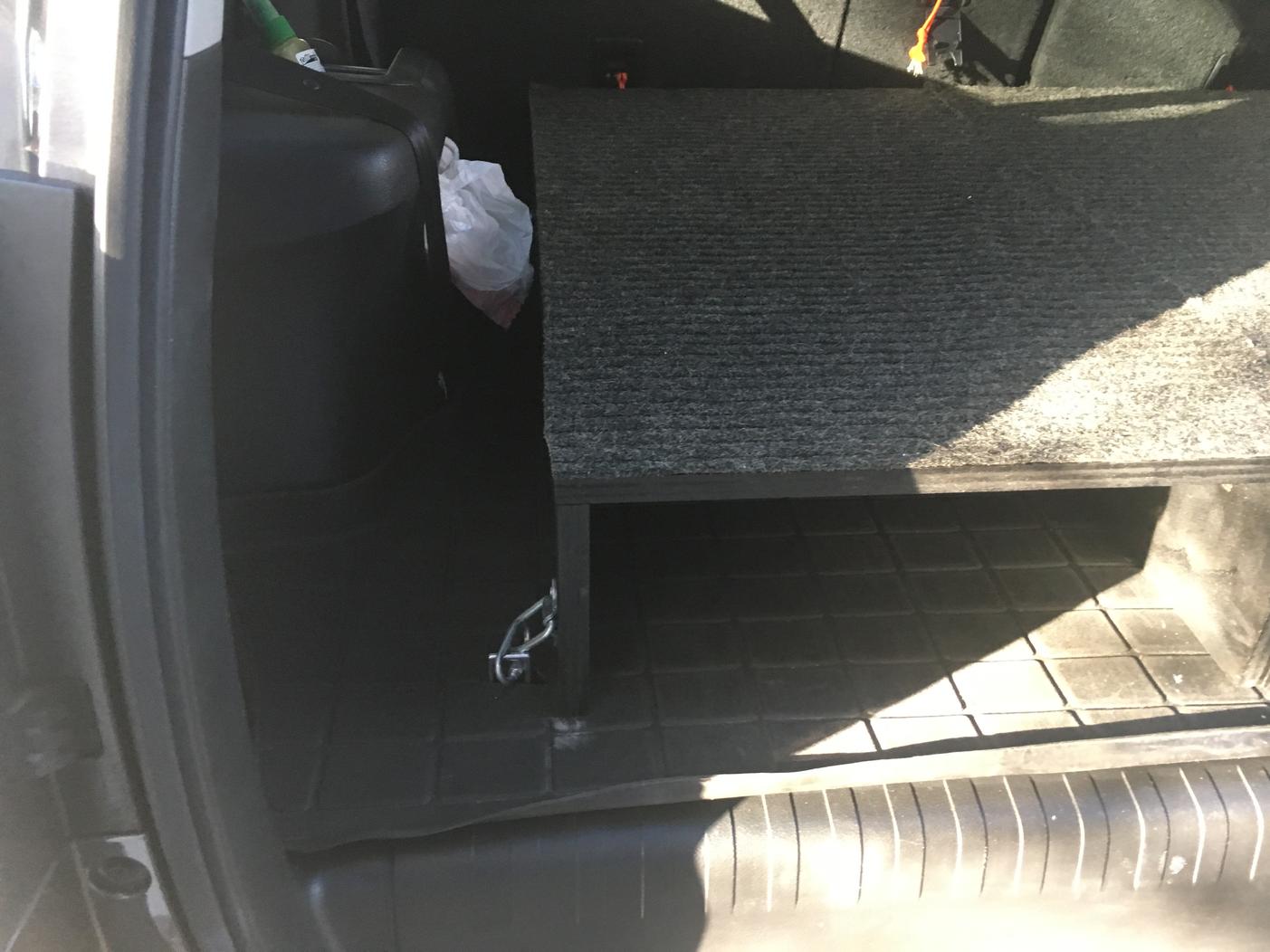

One thing that I’ve been researching and trying to figure out for a while is a better storage system for the back of the 4runner. When camping/exploring we’ve just been using storage bins. I like the practicality of just loading up the bins of equipment that we need but it does make it a pain when they are stacked and lashed to get what we want out quickly without the whole cargo area turning into a mess. So after looking through many threads and ideas this is what I came up with for now based on the following requirements.
1) Low enough height to be able to still put the dog crate, cooler and travel bins/suitcases on top. I lose about 6” already with the 3rd row.
2) Modularity: I needed the storage to be easily removable, and to be split so that we could put one 3rd row seat up at a time, and even potentially stack the storage boxes.
3) Secure attachment points.
As of now we are using under-the-bed storage bins from the container store that fit snugly in each section with about 6” of space to be able to put things that I want to easily access (towels, diaper changer, picnic blanket, etc.). One bin is filled with my paired down recovery equipment, emergency kit and tools. The other is filled with basic camping supplies, lights/flashlights.
The two storage sections are attached to the factory hooks with d-rings and then attached to each other with bolts and wingnuts, which allow it to work as one solid piece. To split them so we can use one of the 3rd row I just unhook one of the sides and unscrew it from the other section. I can take the system in and out of the truck or change it into the ½ section in less than 10 minutes.
Final step was I cut and attached an old Indoor/Outdoor carpet we had at our back door to create a softer surface on top of the wood boxes.
Pics:
This is exactly what I'm looking for to add in 4runner! I like the simplicity of this build as I experience the same issue when moving constantly (as military) and taking long trips especially with kids. This will be my project before my next trip in the summer. If you don't mind, can you share dimensions, materials, tools used?
I’ll get the measurements and other materials list to you and posted ASAP.
No rush, thanks!
Here is the materials list. I also posted as an edit in the original post. The length and width of the boxes are pretty close to the max size you can do if you want them to be matching sizes, match the third row so that you can use one side at a time if needed and still use the factory tie downs. The height can be adjusted/cut to meet whatever storage needs you want underneath. Honestly it was hard to find bins that fit under this, best to look for under-bed storage bins. The container store ones we found were 6.25"H x 27"L x 16"W. I went with the 6.5" tall sides as it left the total height of the storage unit to just under 7.5" tall. This gives enough room for our dog crate on top if needed and also for our cooler, or potentially an ARB 50qt refrigerator or other travel fridge in the future. If you have any other questions or need additional pics, let me know.
Materials:
- 2 x 4x8x3/4 Birch Hardwood Plywood:
Tops: 2x 18.5"W x 32"L
Sides: 4x 6.5"H x 32"L
Backs: 2x 6.5"H x 17"W
- Wood Glue
- 1.5" Wood Screws
- 2x 2" Bolts (I used extra that I have for our hurricane shutters) with wing nuts.
- 4x 1.5" Wire Rings https://www.homedepot.com/p/Keeper-1-1-2-in-Wire-Ring-2-Pack-04521/203294978?cm_mmc=Shopping%7CTHD%7Cgoogle%7C&mid=shFwgTTzb%7Cdc_mtid_8903tb925190_pcrid_111415246385_pkw__pmt__product_203294978_slid_&gclid=Cj0KCQiAkZHTBRCBARIsAMbXLhHJEWoP_4lSFHGaO4kmdUA1HLCqtlkTTwODpRzMo0_o2_vmwJMxxTEaAvvaEALw_wcB Used to attach to factory tie-downs.
- 4x twist lock carabiner https://www.homedepot.com/p/Everbilt-3-16-in-Zinc-Plated-Quick-Link-42714/205887919 To attach the wire rings to the factory tie-downs.

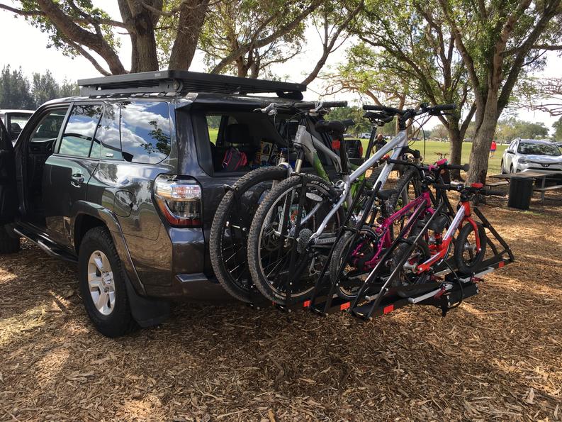

1-Up USA
1-Up USA Bike Rack

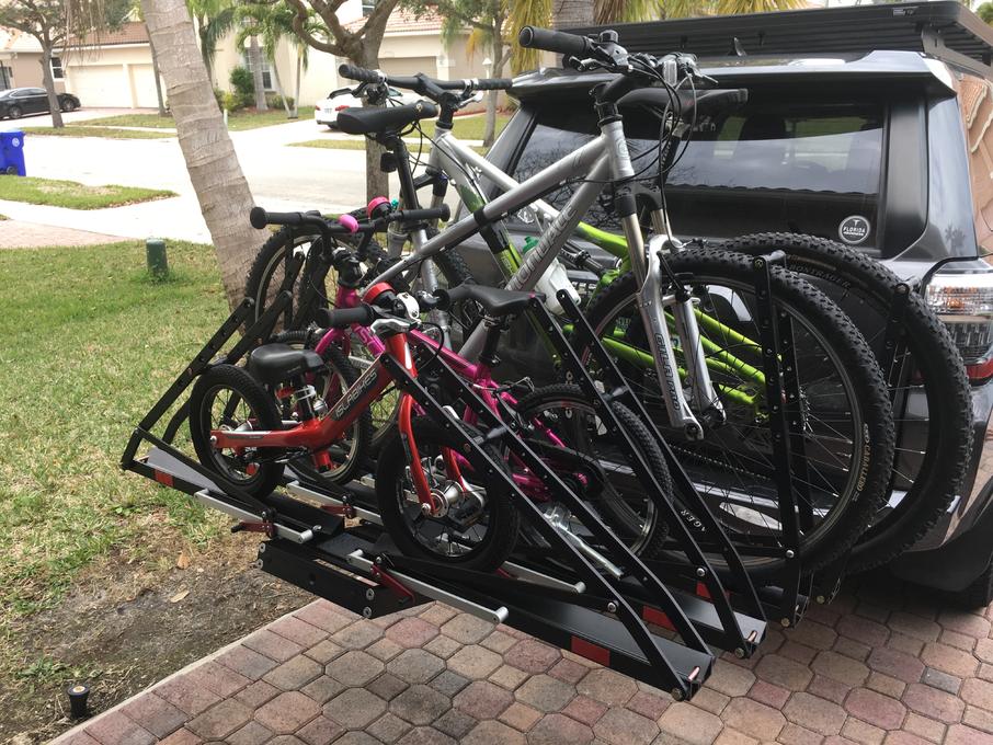

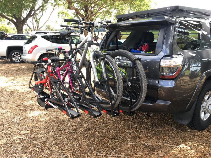

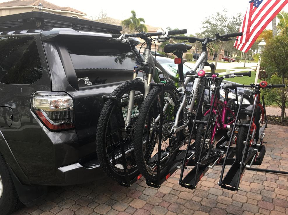

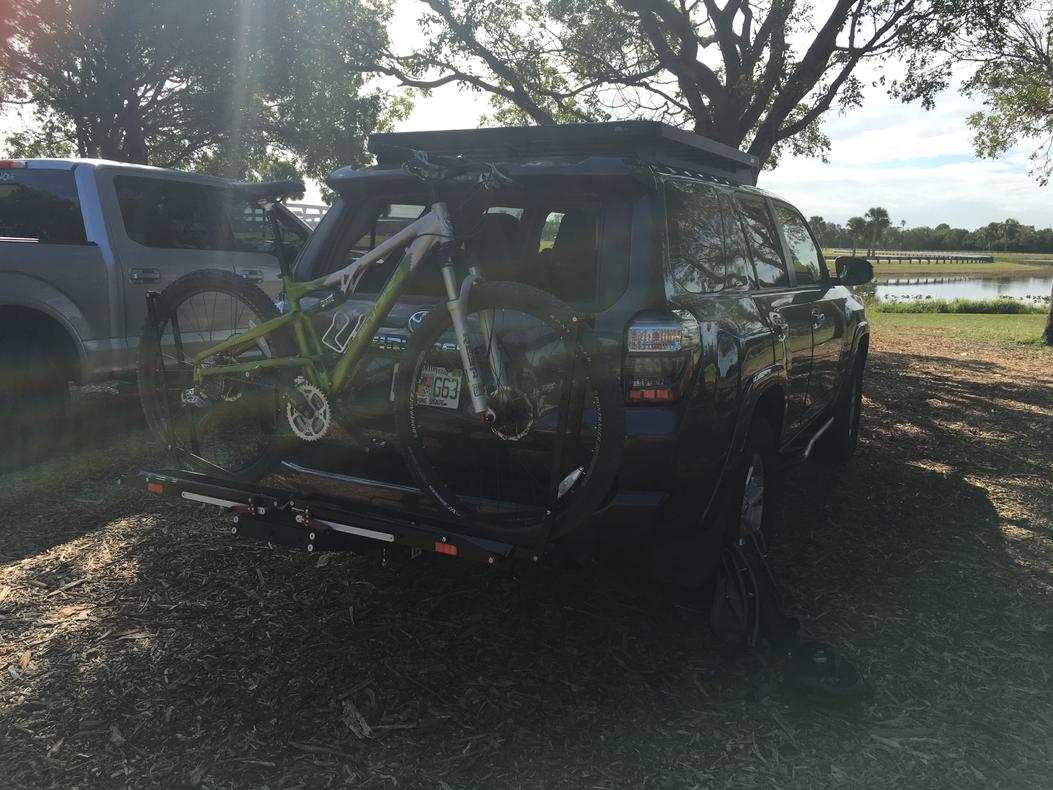

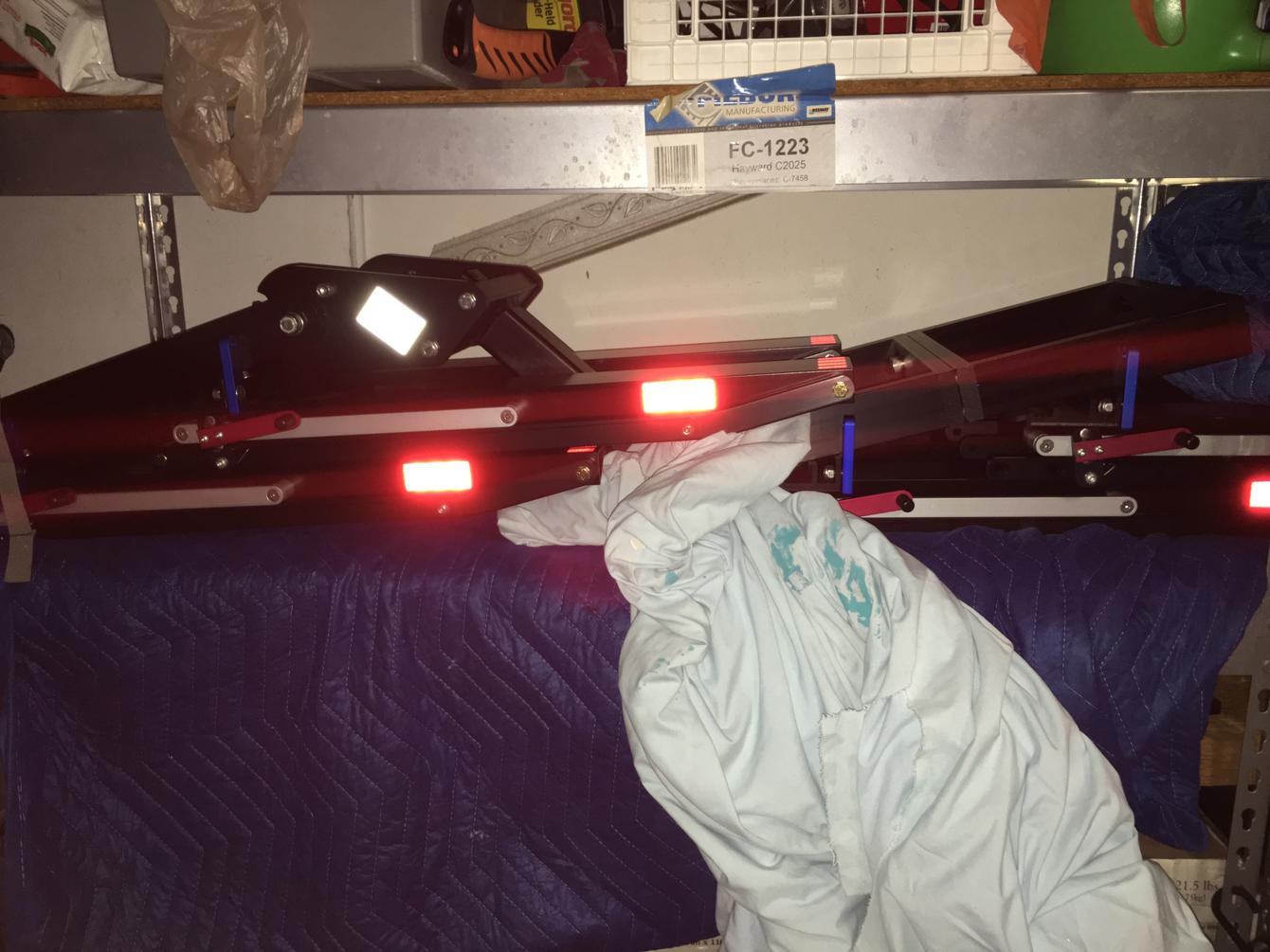

I’ve been researching for a long time and squirreling away $ deciding on what type of hitch mounted bike rack to get for our 4runner. I almost pulled the trigger this fall, but that was when an announcement came from the designer of the original 1-up USA quick rack came out that he had made a new rack that was cheaper, lighter and improved upon his original design (called the Quick Rack Mach II). I decided to wait a couple of months to see what it was like and to get some initial reviews as it was supposed to be released in December. By January the release kept getting pushed off and the first orders now were supposedly going to be coming out in April. I couldn’t wait any longer. I decided to go the buy once cry once option and get the tried and true 1-up USA heavy-duty rack with two add-ons in black.
Why 1-Up for me:
I really liked the new Thule Pro and Kuat NV2, and they could have saved me a couple hundred dollars (especially with the REI member 20% coupons), but they didn’t check off as many of the boxes of what I wanted out of my rack as the 1-Up. Here were the main ones that they other companies couldn’t match.
· 1-Up could fit all of my family’s bike sizes. All of the other companies can fit bikes with 20” wheels or larger, but the 1-up can also be adjusted to 16” size, which I needed for my Daughter’s bike. I actually was able to adjust the rack in such a way to fit my Son’s 12” balance bike.
· Mounts in a 2, 3 and 4 bike layout. We go the heavy duty 2-bike rack that allows for up to two 1-bike add-ons to be attached. All other racks are only 2 bikes with a 2 bike add-ons for either a 2 or 4 bike configuration.
· Tiered trays to allow for better bike fitment and allows for better departure angles with the 4 bike tray. I don’t regularly travel out into the backcountry to bike (especially here in Florida) but I do want the ability to travel with the bikes for many of our adventures, on and off-road.
· Beefy, these racks are heavier then the competitors and are seriously overbuilt (this is not a bad thing in my opinion). They also lock into the hitch for a complete no-wobble attachment.
· All aluminum, no plastic for hopefully years and years of use without replacement.
· Compact storage. These racks fold up small and I can easily store them on one shelf in my garage.
Con’s (that I honestly new about when buying the rack)
· Locking system – There is no integrated locking system. I bought their hitch lock, which doesn’t allow a person access the anti-wobble screw so theoretically someone couldn’t remove the rack from the hitch. I also bought their add-on locks, which do the same thing for the two rack add-ons I purchased. In addition I got the bike wheel locks, which lock your bike to the rack through the spokes/wheel of the bikes. Due to quick release wheels on my wife and my bikes, this is only a deterrent, but should work for quick stops. I also will likely lock all bikes to the rack using conventional kryptonite cable and u-locks. Again this isn’t going to stop most bike thieves that have any amount of time, but will work as well as any of the other bike rack company’s integrated locks.
· Tilting mechanism - The 1-up USA tilting mechanism is under the rack, which is not as convenient as the competition’s and can be finicky. They do have a EZ-Pull mechanism that can be added to replicate the end pull mechanism found on the new Thule rack, and I’ll probably add that at least for the 4-bike configuration in the near future.
Final Thoughts:
We’ve only had the rack for about a month, but I couldn’t be happier with our decision. It is everything that I hoped the rack was going to be in terms of easy use, quick mounting and build quality. It also exceeded expectations in that I was even able to mount my Son’s 12” balance bike. We’ve been out riding a couple of times and it has worked perfectly. My kids actually got their first taste of real trail riding (I refuse to call it mountain biking in South Florida) as I took them out for their first off-road riding at a local Mountain Bike Park (they held their own on all of the green runs, about 2 miles, even my Son on his balance bike). Bought and definitely not crying on this 4runner addition.
