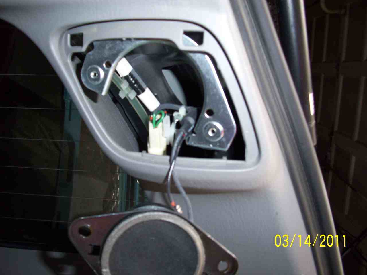

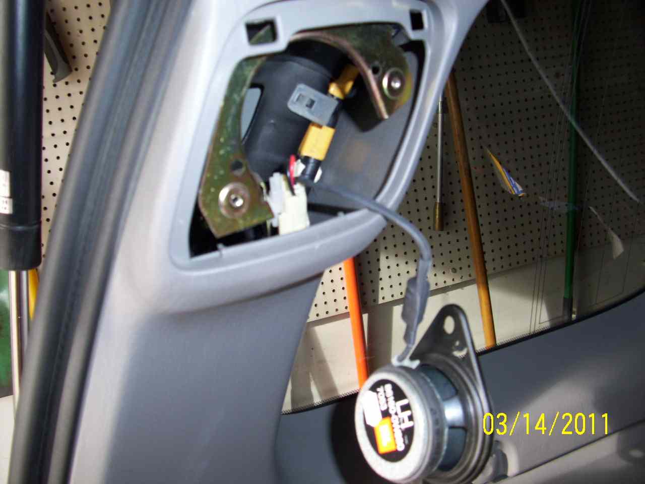

Here are some pics
Driver and passenger side pillar

They are actually the connectors for the speakers. I know your photo does not show that same connector on the passenger side pillar but it should be there. It may just be lower in the pillar as both side in my limited with the JBL system have the same connectors.
I looked further into the pass pilar and I still didnt see the adapter, but from your pic its clear that this is the speaker connect. Thanks for the info & pics. :thumb3:
