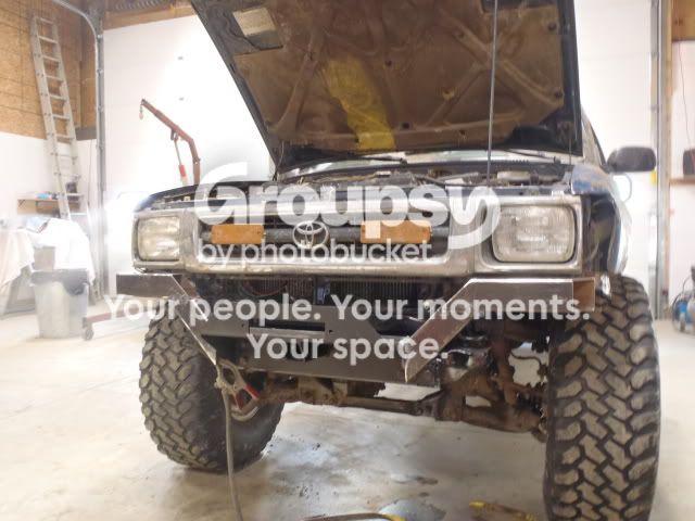

You can also make a bumper pretty cheap. Getting the TG winch mount then building off of it is an easy option.
P2230247.jpg~original
I guess you don't want to use the tow hook. But that is a place to put a dring mount instead.
The trail gear winch mount easily bolts to the frame. And provides a front receiver right in the center instead of being pull from the side or having to reach under the truck. And well it is a winch mount too. It has worked extremely well for me. But i've welded a reinforcement plate behind it. Chrome bumper is still there. Sort of. I like the stockish sleeper look.
