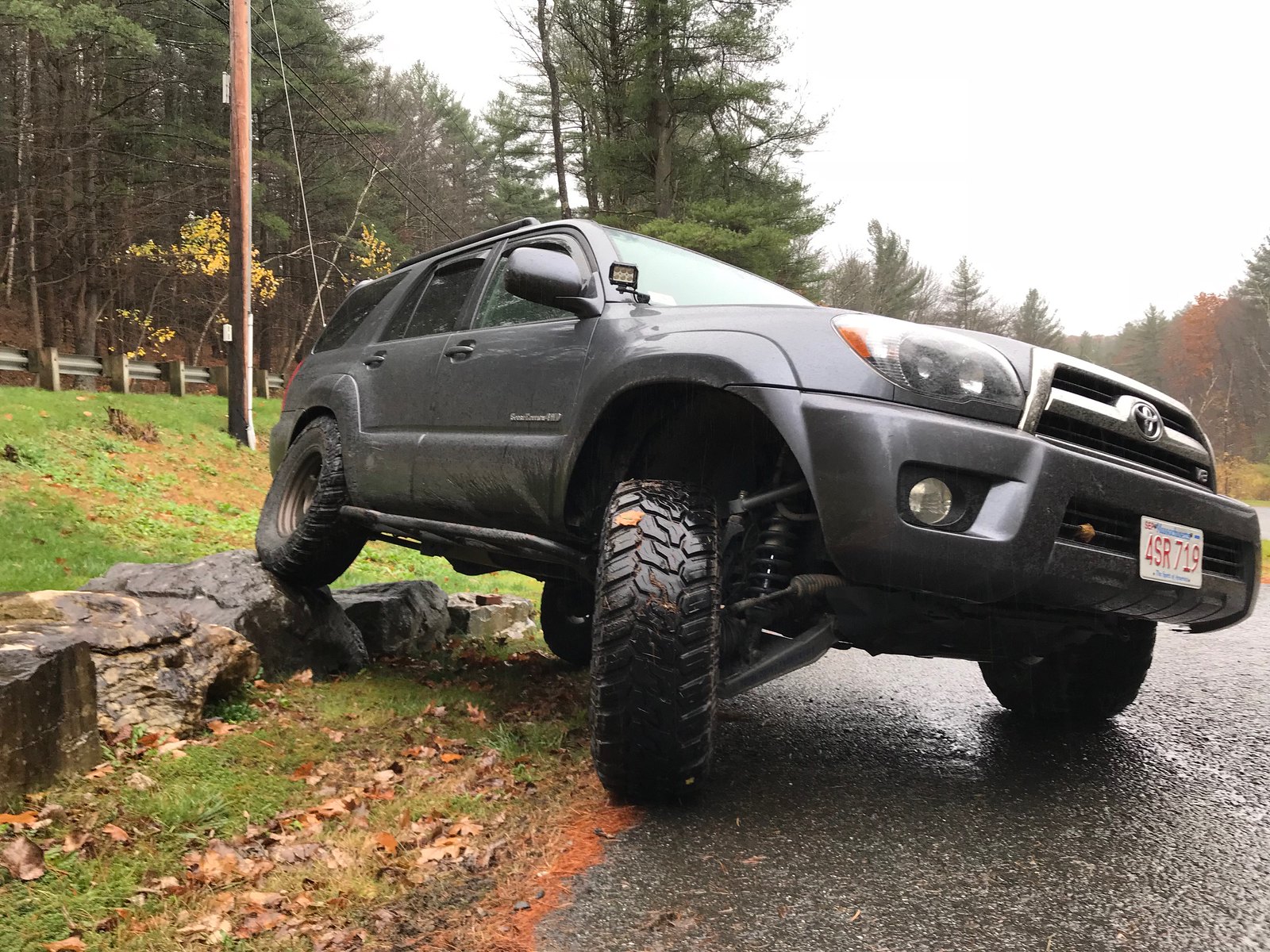

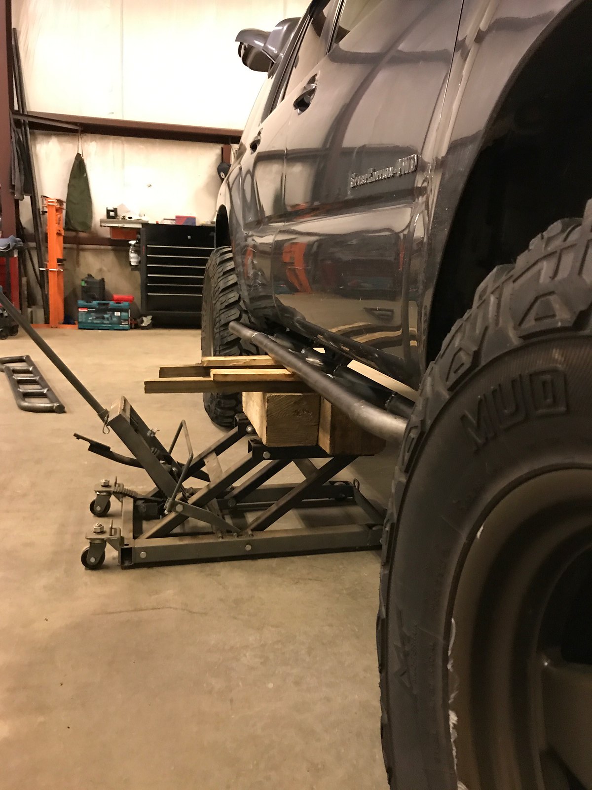

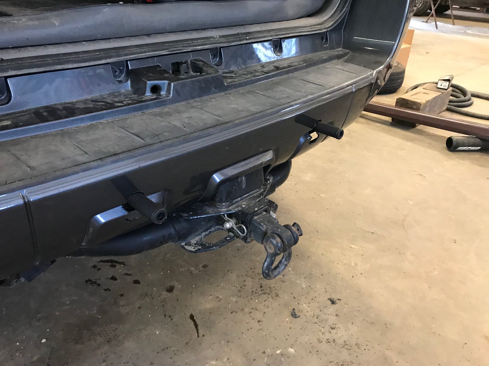

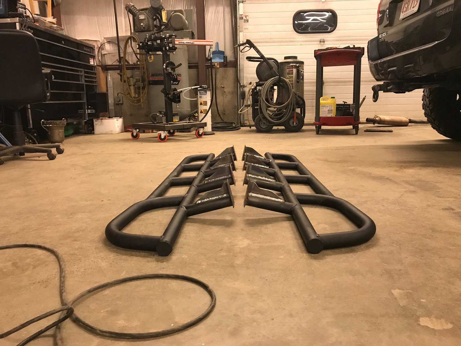

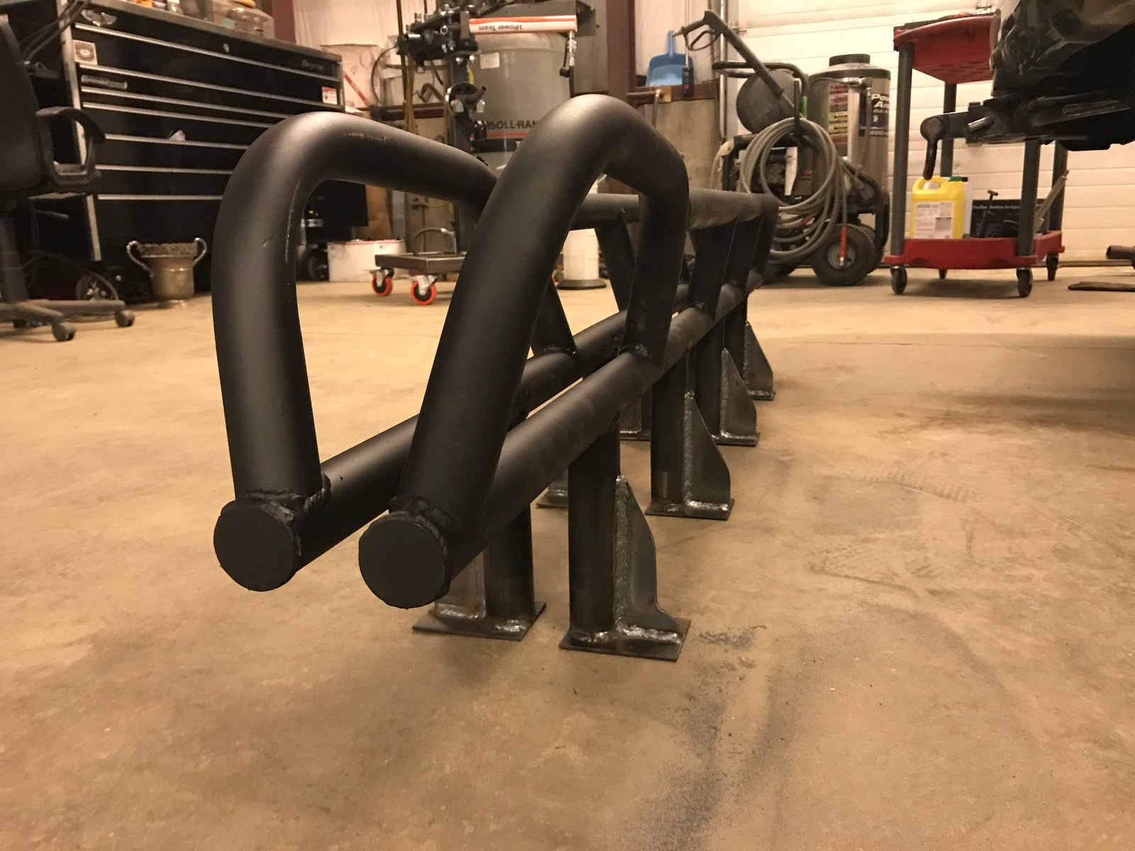

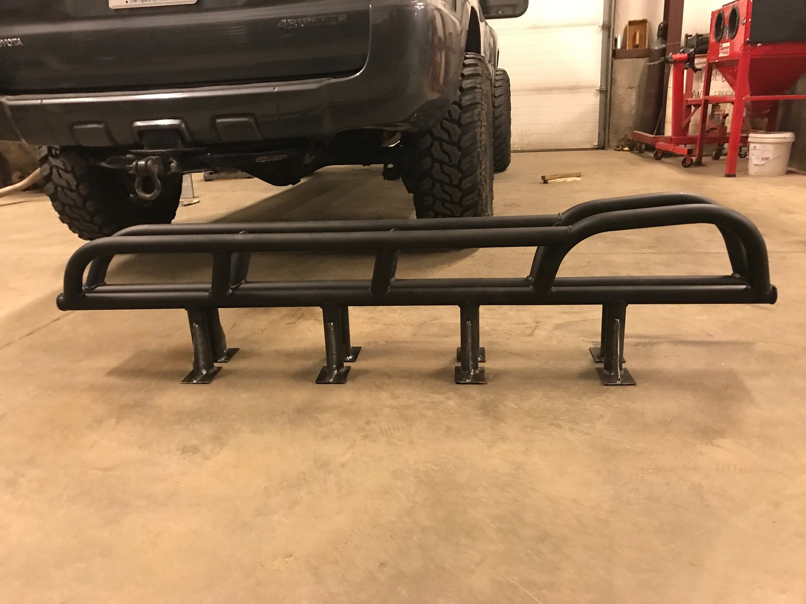

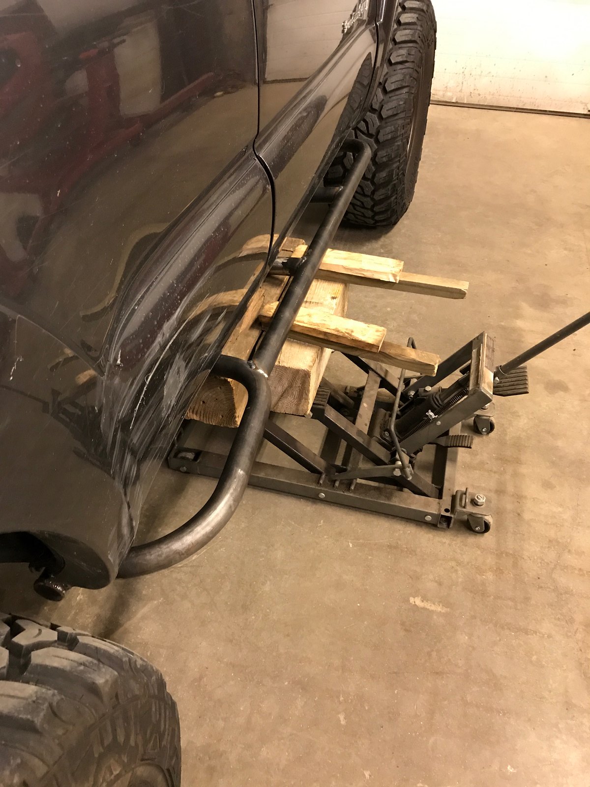

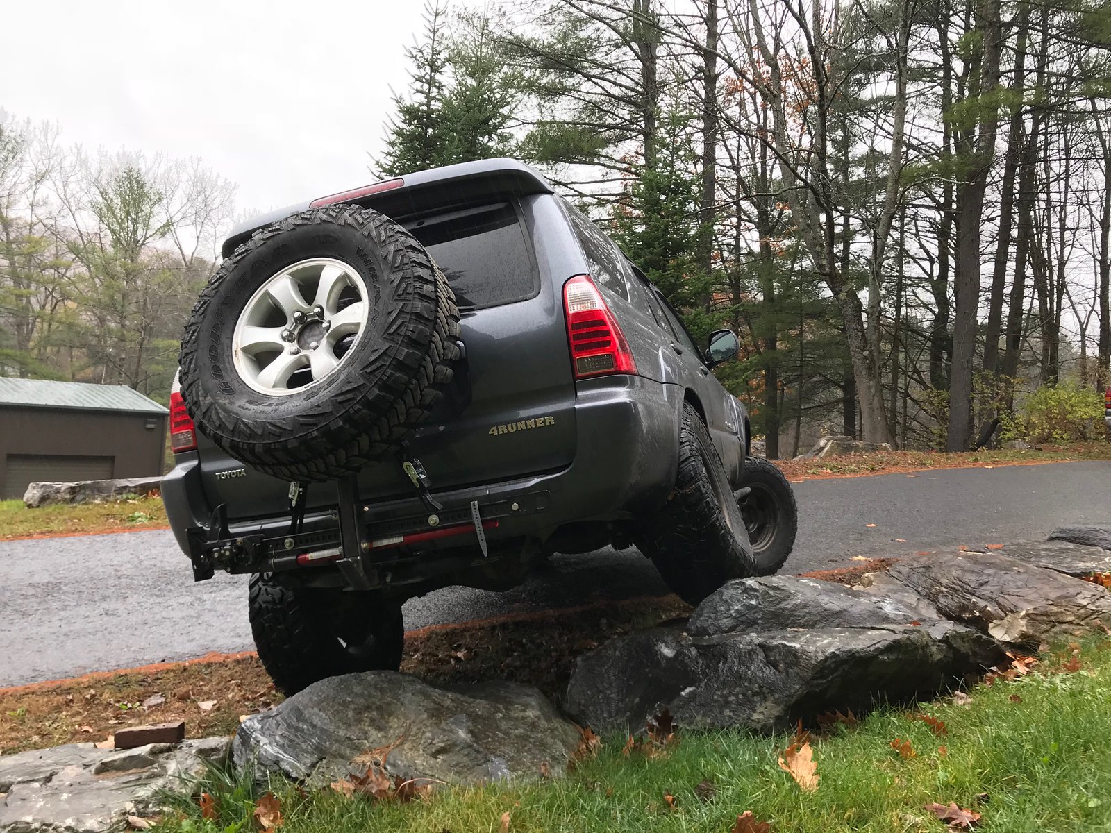

But I guess they're back up? anyway, made some rocksliders a while back.

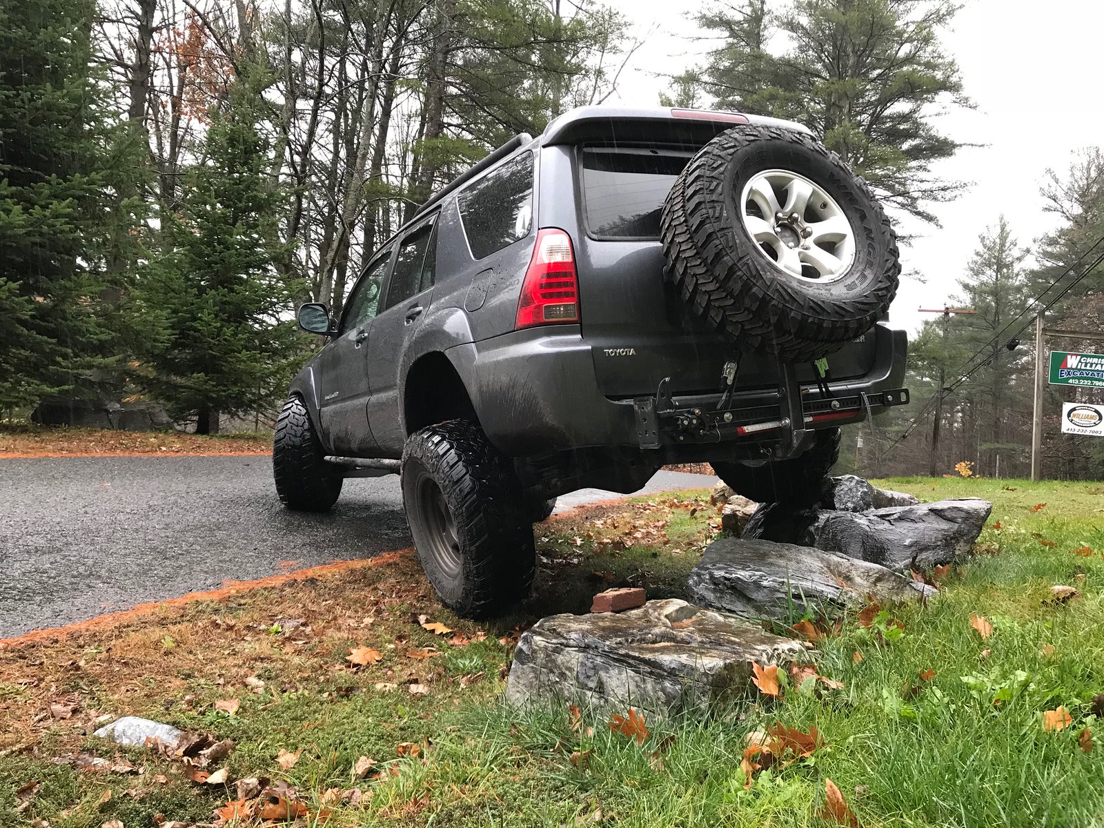

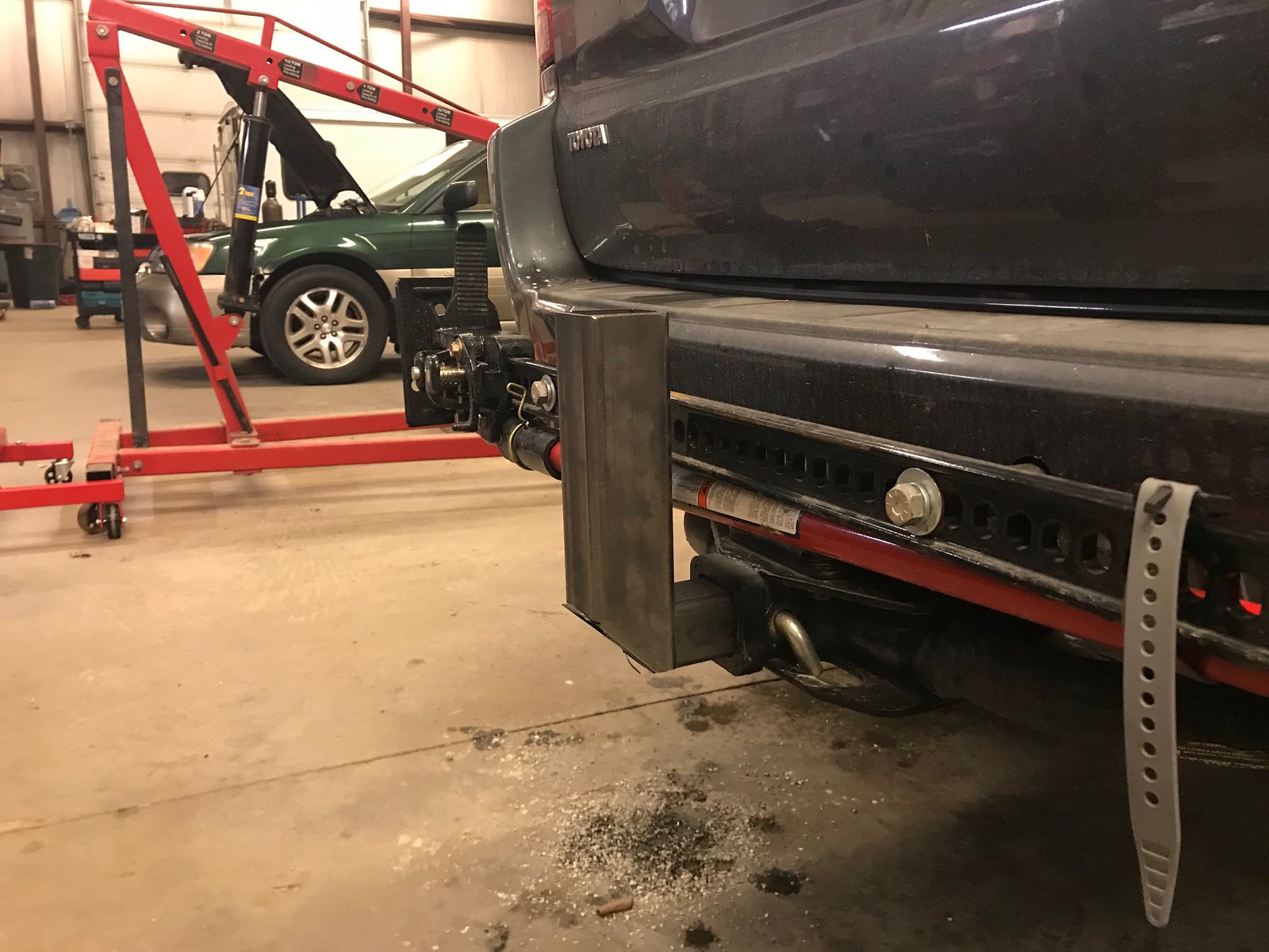

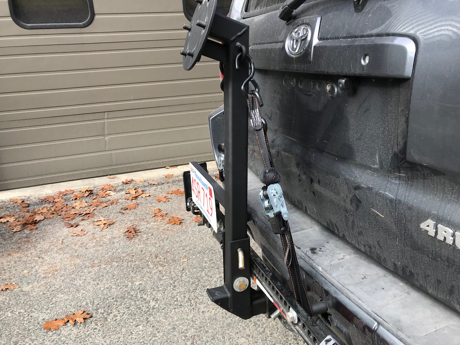

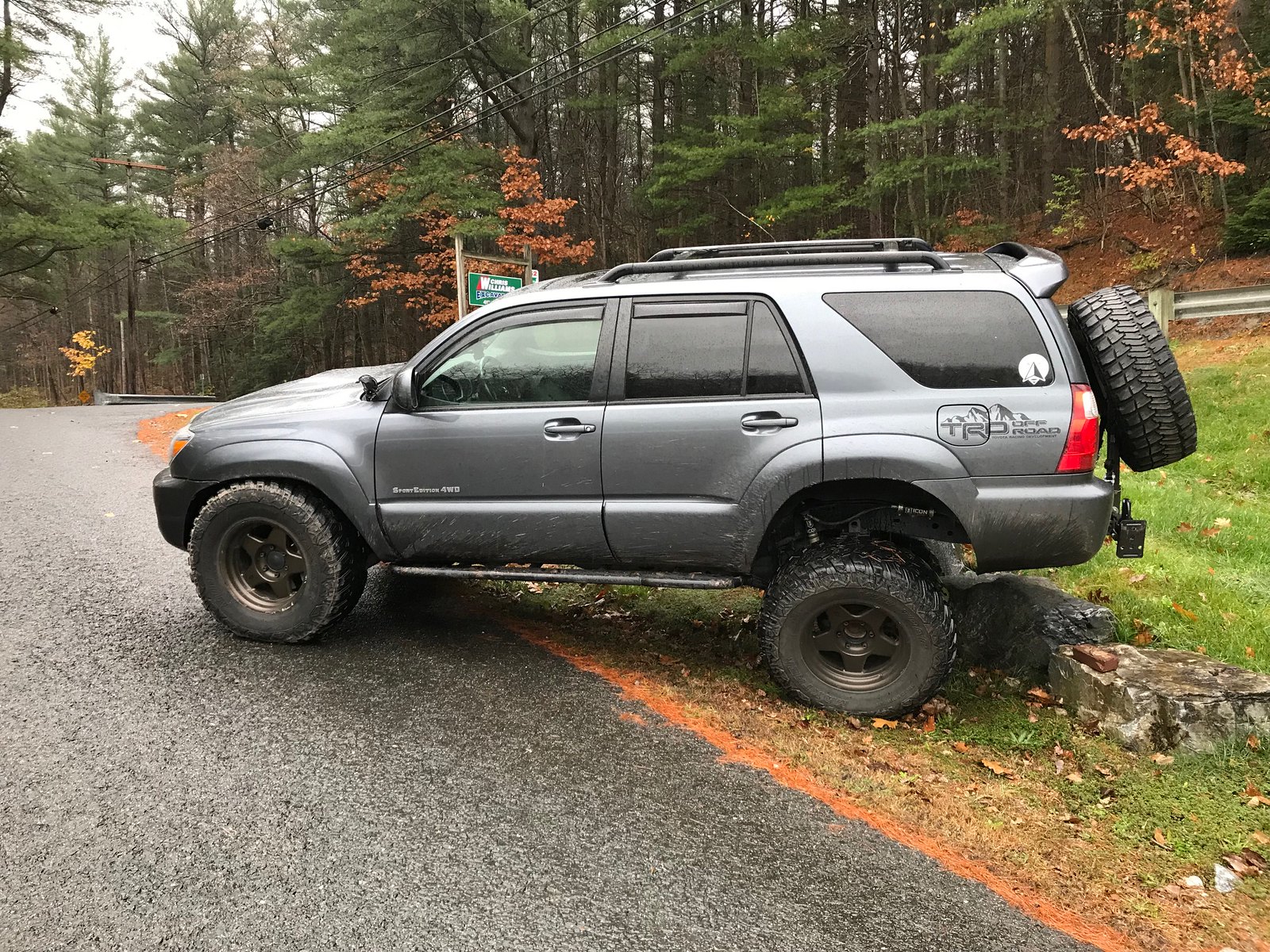

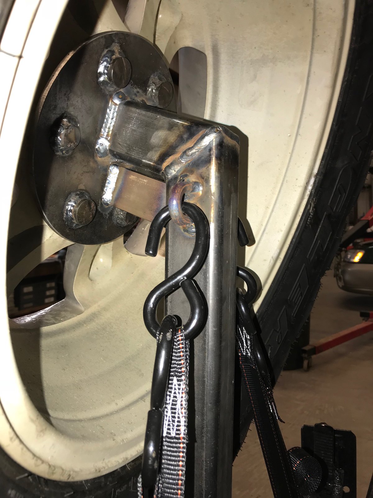

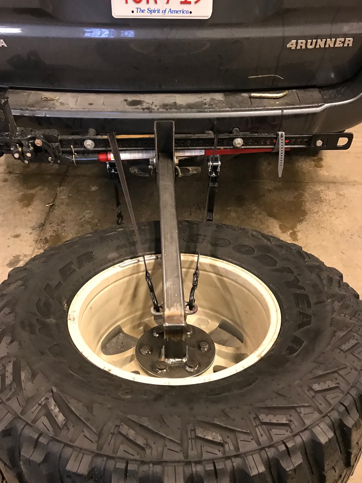

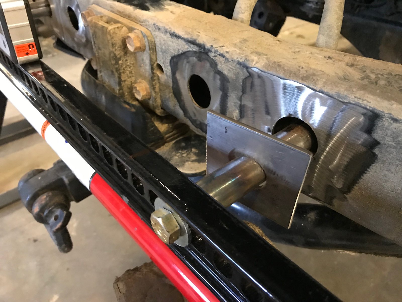

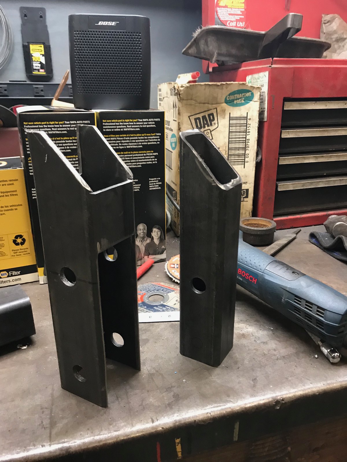

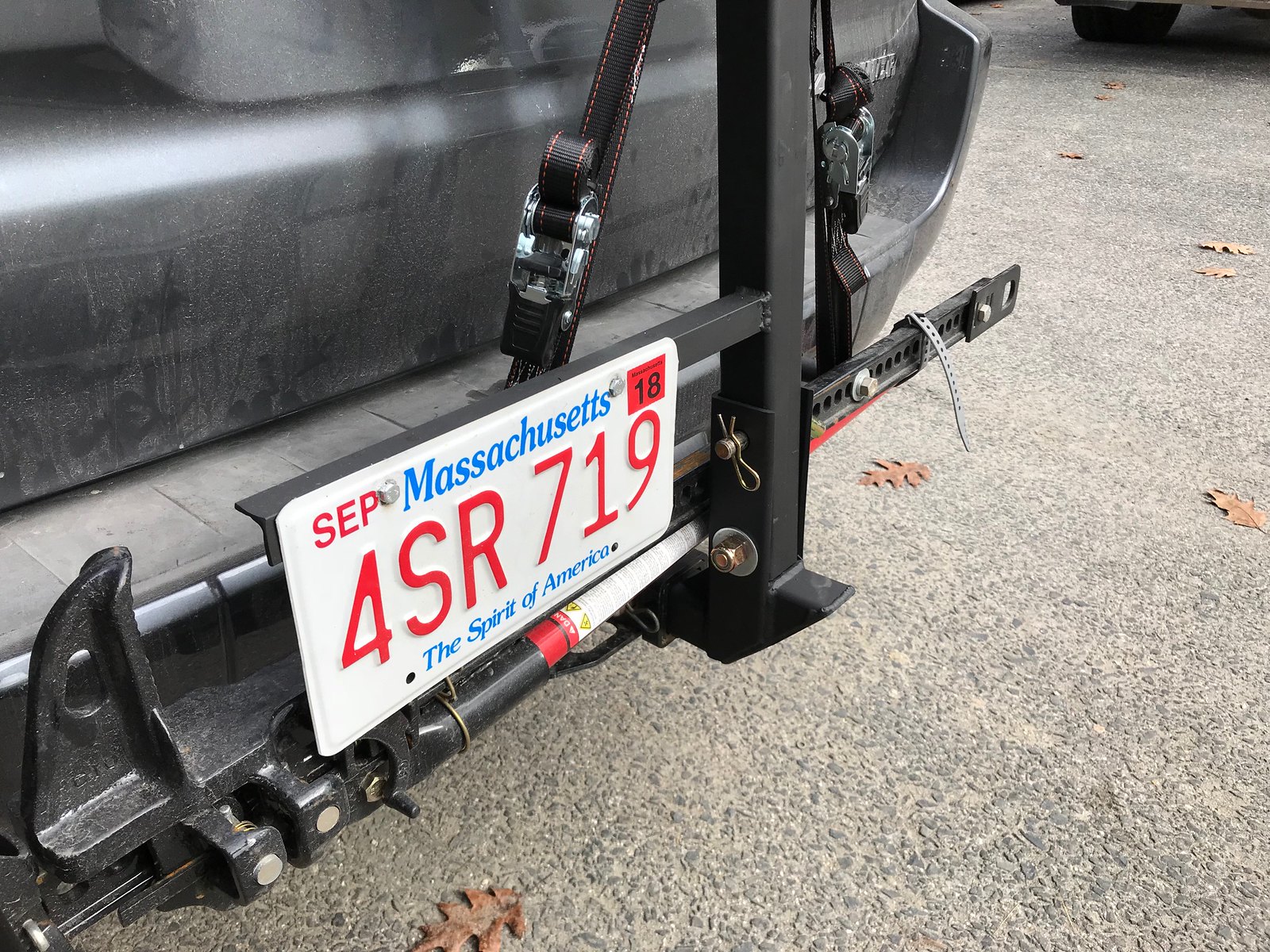

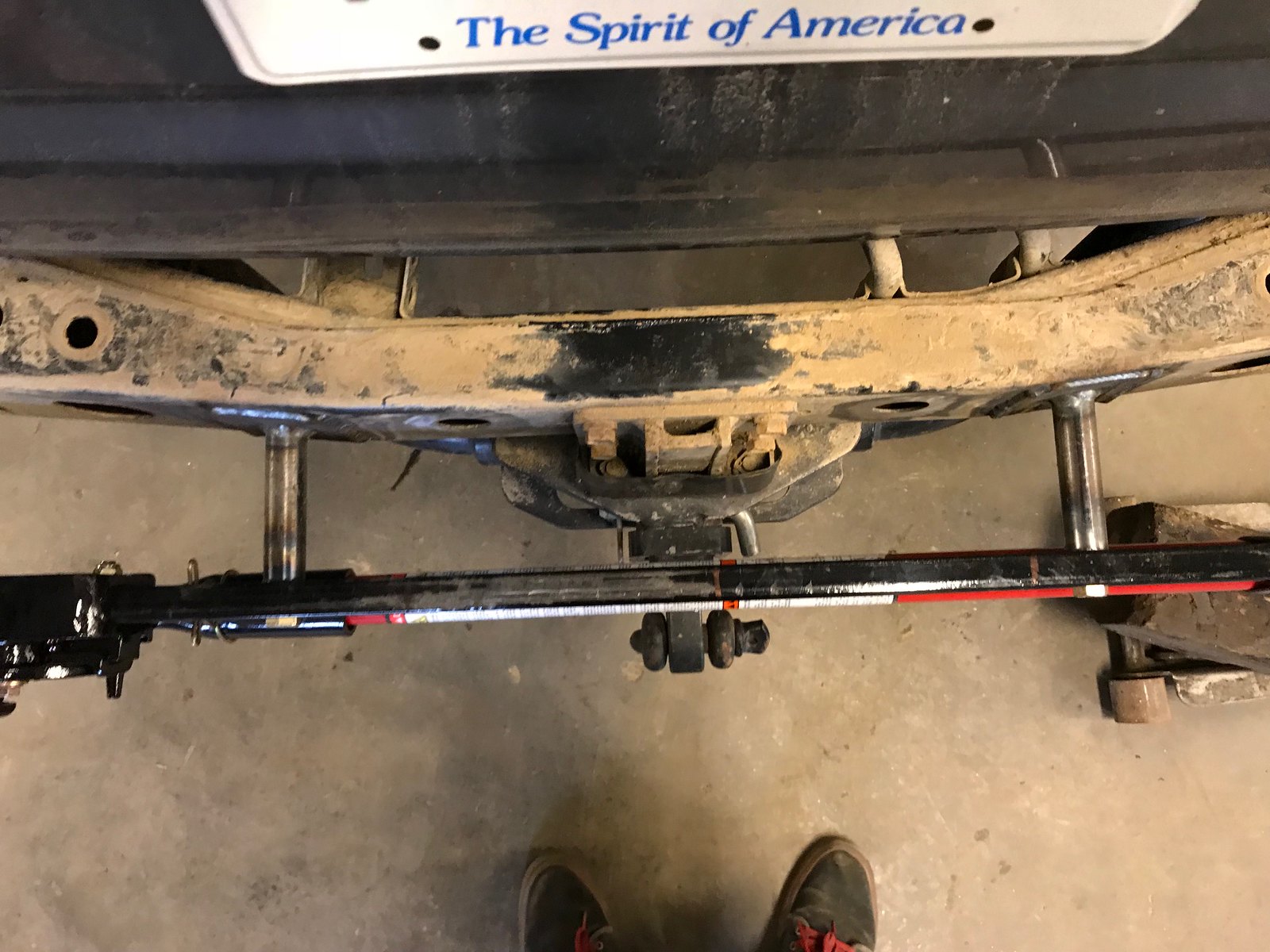

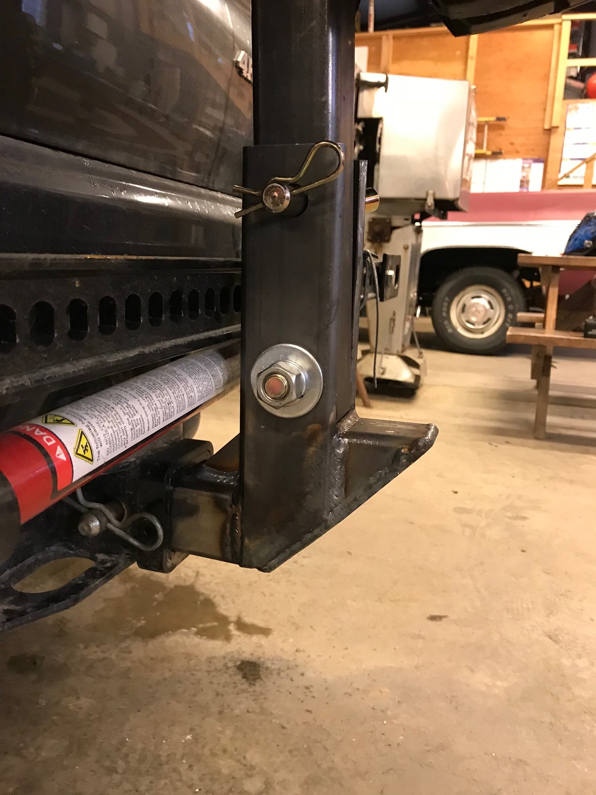

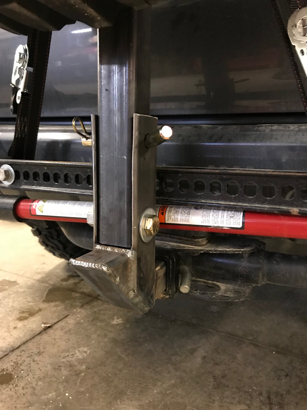

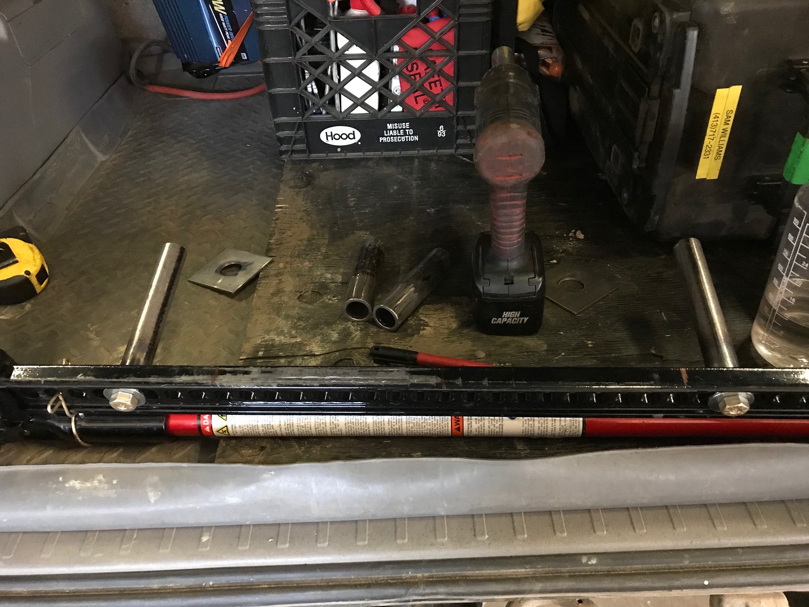

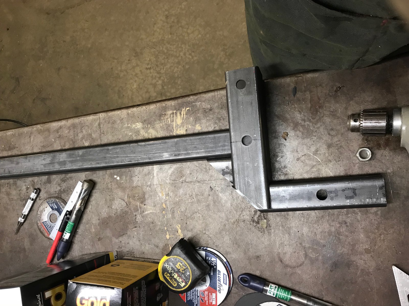

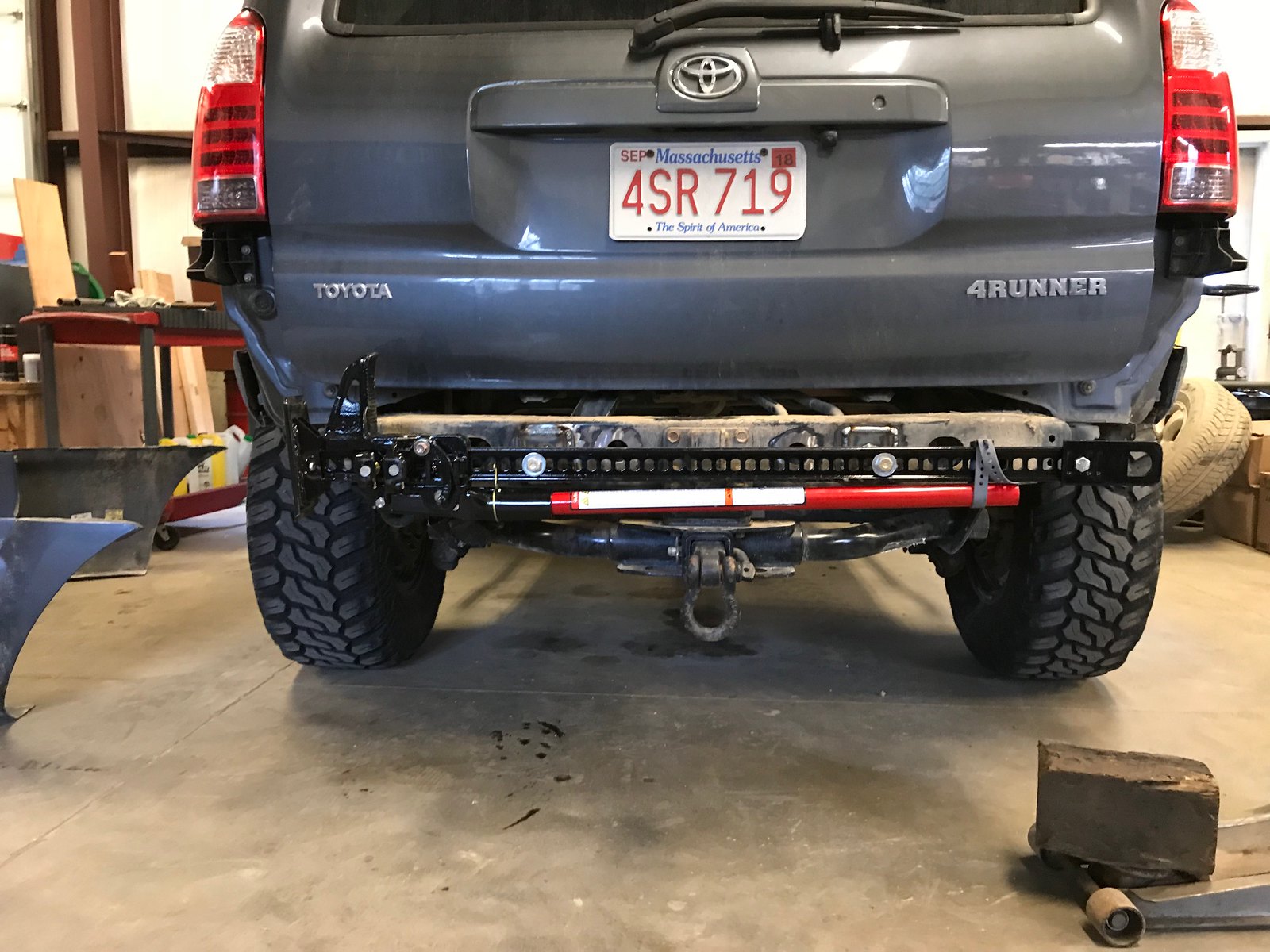

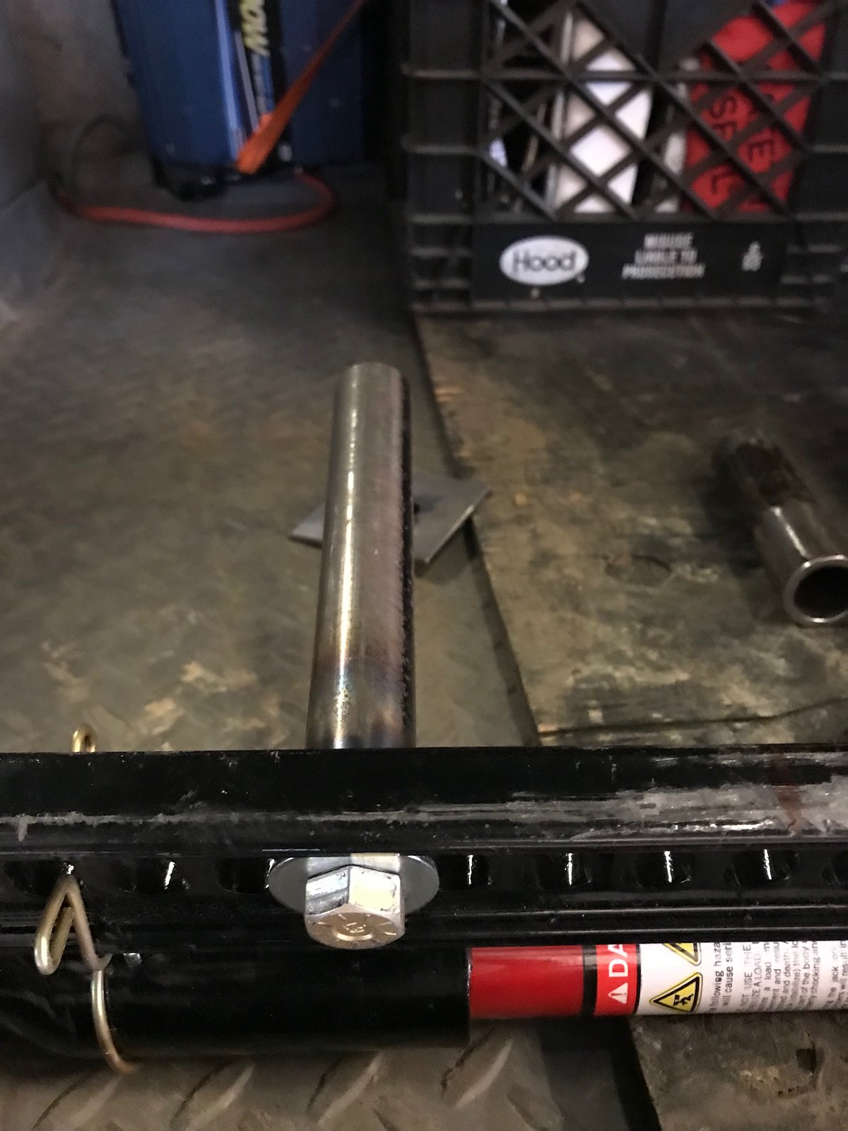

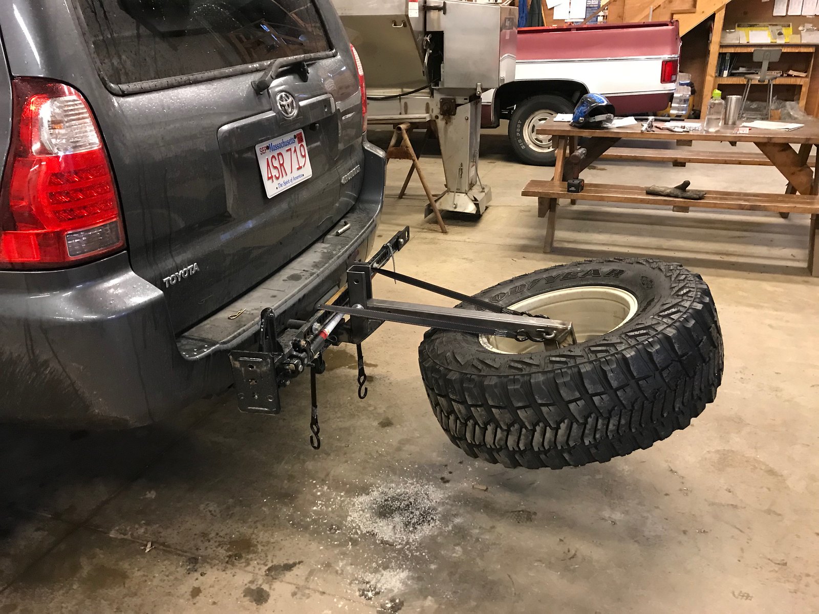

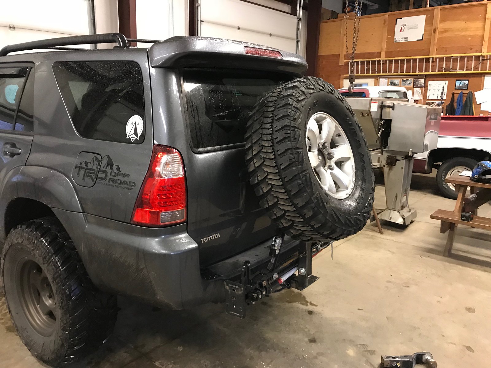

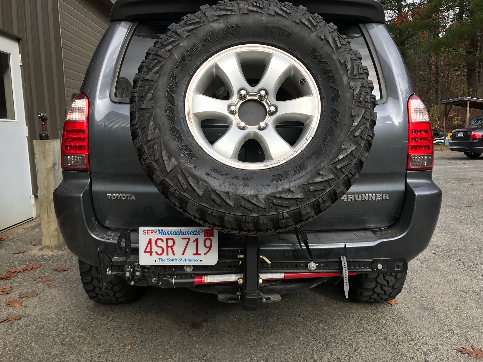

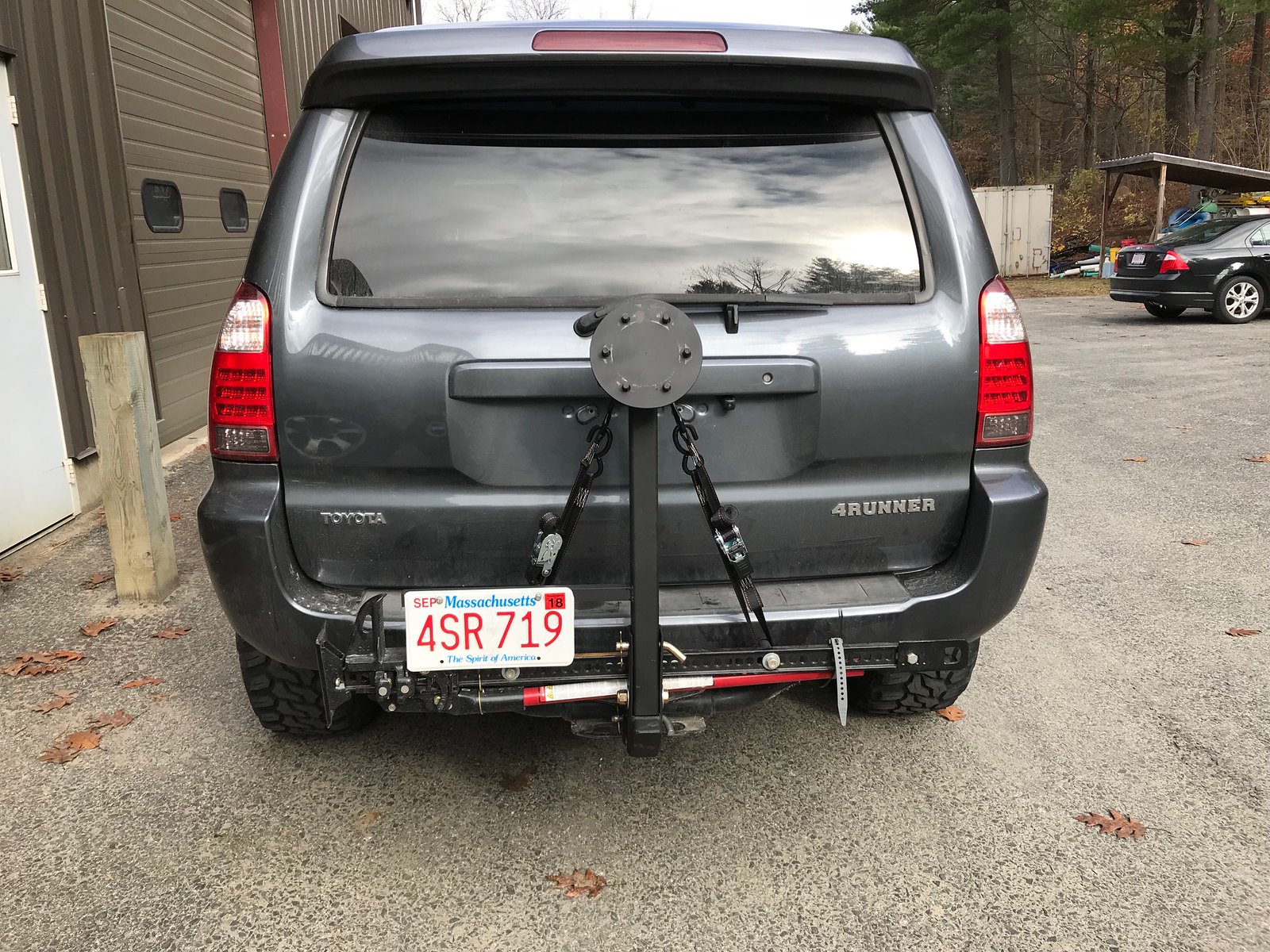

Finally got a full size spare, obviously wouldn't fit back underneath so heres a temp solution until I build a bumper:
Its very stable side to side, theres a small amount of flex fore and aft due to receiver hitch tolerances. I may weld a plate with a nut/bolt combo on the back side to further stablize.
