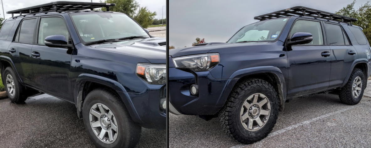

I replaced the stock tires with BFG KO2 275/70/17 tires today. These certainly help with that "off-road look".
There's a chance of a trip from Houston to South Carolina right after Christmas. I'm thinking of breaking in these tires on the Georgia Traverse. Let me know if you have any other suggestions for trails on the way to/from SC.

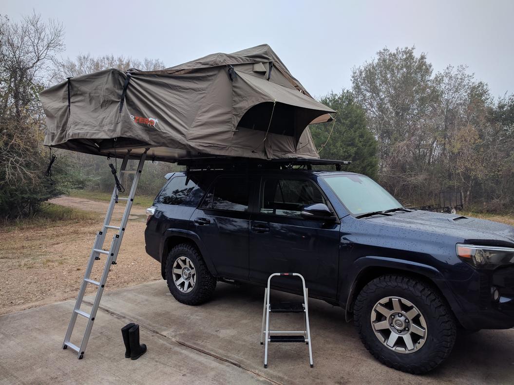

We got the tent installed ... and let me tell you that was no small feat. I guess I had the impression that removing and re-installing these tents was not a big deal. All of the hardware that came with the tent had nyloc nuts and while I would agree with using those for a permanent install, I really don't think that's the best choice for retaining the option to remove the tent when we're not planning to use it for a while. I already had a nyloc nut seize up on me when installing my Rago panels and had to cut the bolt in that case (heat didn't work).
So we took a trip to Home Depot to get some standard nuts and bolts with lock washers. Out of an entire aisle dedicated to nuts and bolts, only one set of drawers had metric sized hardware. And of those ~10 drawers, half of the bins were empty. I ended up trying some different imperial sizes and found a size that was close enough to fit in my rack's slots and in the tent's mounting rails. With these, I got some lock washers and we returned home to install the tent.
That's when we realized that even without a lift, the 4Runner is too tall for my wife to lift the tent. We ended up getting one end onto the rack and then I slid it up onto the rack from there.
Then the fun trying to access bolts started. In all the pictures, it looks super easy to turn wrenches on these bolts. But in practice, they're all blocked from the side you'd really like to access them and the space between the bottom of the tent and the top of the rack is really tight for my forearms. I guess I need to get some extra long box end ratchet wrenches for this next time.
Once we finally had it bolted down, my daughter and I packed in for a night to test it out. We just barely got in before a thunderstorm hit us and dropped several inches of water in about 30 minutes. I can attest that the tent kept us dry. I didn't really have the rain fly perfectly in place and I didn't know how to attach the extendable rain/snow rod, so we pooled water over the entry-way. But overall we figured it out. Now to plan a trip where we can test it in the field!

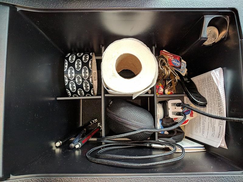

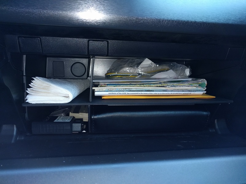

For two of my Christmas gifts, my wife read through my Google doc with my wish list for mods and gear and she bought me the Salex organizers for the center console and glove box. W00t!
I thought it was funny how the glove box organizer bag has "Organizer must be assembled inside vehicle center console" on the label. I think they meant inside the glove box ;)

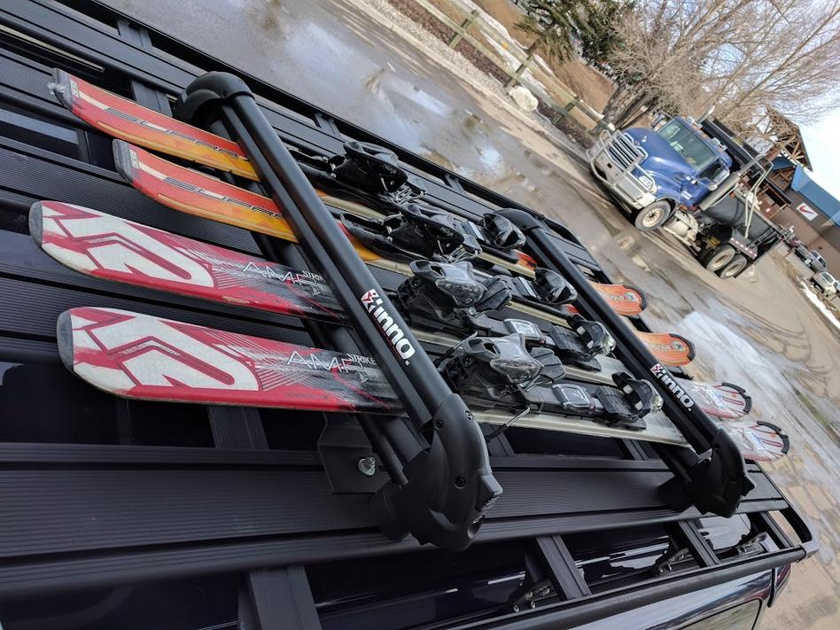

So for spring break, we packed up the 4Runner and drove 2 days to Silverthorne, Colorado. Considering we had 3 adults, a 10-year-old, and a 9-month-old, we did well to complete that drive in 2 days. From the cabin, we made day trips to 3 different ski resorts: Loveland, Arapahoe Basin, and Copper. We had a blast. It was about 2400 miles round trip.
In order to make use of the roof rack, I ended up buying a pair of these INNO racks. I had to use a grinder on the square plate base of each bolt since it was designed for a specific T-Slot style rack. After about an hour of grinding them down, they fit into the k9 slots just fine. I waited to attach these to the roof until we got into Silverthorne. Just the empty rack alone added a lot of wind noise and drag as we flew 80+ mph across Texas and NM. But I'd say it was still worth it. The racks made for easy ski storage out of the vehicle.
I'll also brag a bit for my daughter. 2 years ago we did the same trip and that was her first time skiing. This year she made her first blue square run and she only fell maybe 3 times throughout the 3 days of skiing. Woo!
I can't say we really tested out the 4Runner, though. The conditions were dry with little snow on the roads. I put it into 4wd in the parking lots just because of the sludgy mud and ice mix. But I'll have to plan another trip to really test out the 4wd since there wasn't much snow left by the time we got there.

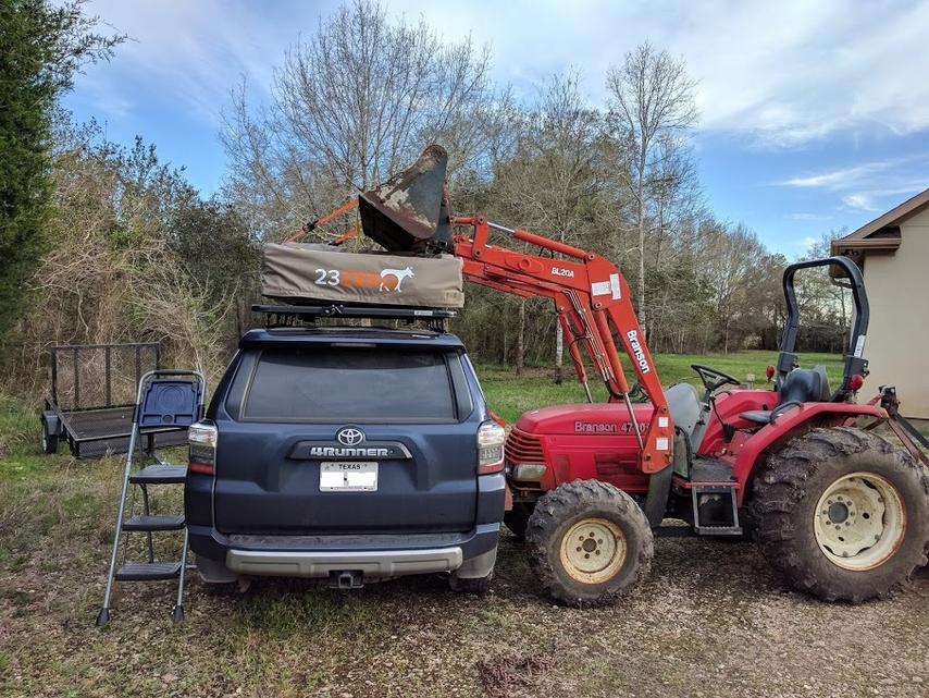

I forgot to share how we got the tent off the rack before our trip. I decided to try out the tractor. It allllmost works perfectly. Unfortunately the scoop doesn't quite reach over the mid-point of the tent, so when I pulled the hydraulics up, the tent swung sideways toward the tractor. It wasn't a big deal for removing the tent, but this will be an issue when trying to re-install the tent. I might have to build a little rig to fit over the scoop to provide longer arms reaching over the tent....
