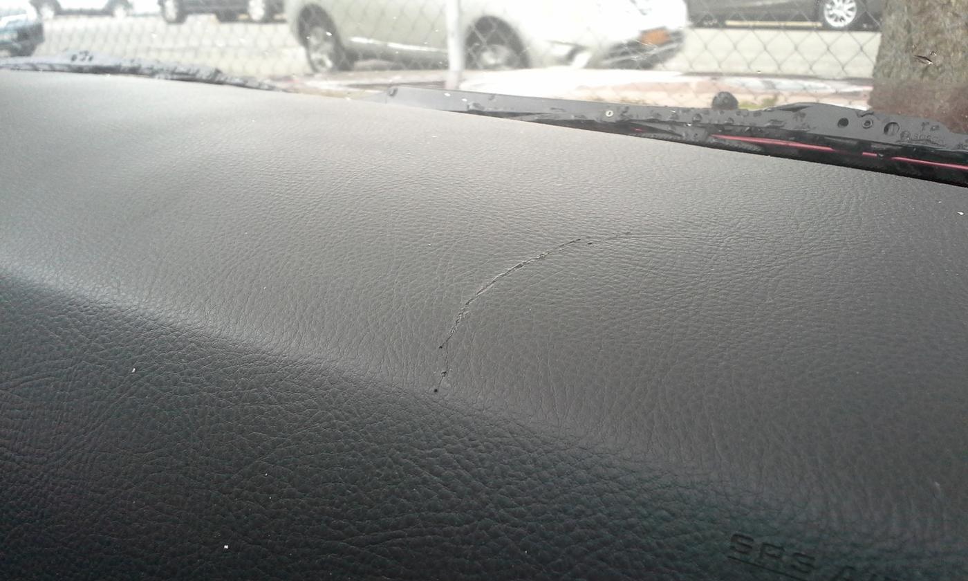

WTF? no other place has a crack just at the release points of the airbag, almost appears that pressure from the airbag caused it to begin to crack, I haven't heard of many 2005 4runners with the dash cracking
let me guess toyota will do nothing to rectify this as they care nothing about our resale values.

no that was my attempt to fix it, the small holes are to prevent or slow down the crack from spreading
it has cracked right along the half moon (crescent) shape that the airbag breaks free of the dash

Well, welcome to the club, my friend.... "The list is long, but distinguished".
Yeah Toyota really screwed up with the development of these dashboards. Mine has a crack running along the front edge from drivers side to passenger side. I'll be looking to buy a Coverlay very soon.
Not that I want to come off as callous but, but I haven't seen a cracked 4th gen dash yet in my years at the dealership. Seen some trashed 4th gens, but no cracked dashes yet.
My '04 lived in LA most of its life and sits in the sun all its life so far, so I'm not entirely sure what is causing it for you guys.
That is very unusual, I remember there were a few threads before where people talked about ArmorAll being a possible reason and so on. I also know some states like Arizona (and California) where its typically sunshine and sunshine year round tend to have these issues.
It sucks, but really Toyota isn't going to do much of anything about it as its not really a Safety issue and the vehicles are typically well out of warranty and production.
Best of luck and let us know what you end up doing. I still feel leary of dash covers as they seem to be glued ontop of the existing dash rather than a replacement.
Not to challenge you Blackworks, but there's a whole sticky with 26 pages worth of cracked dashes, mine included here. While I may have run mine well, I'd hardly consider it trashed and a bunch of others Im sure are in a similar position.
As for the OP, you're definitely not alone. The problem is that you can't just replace the cover either as it's integrated with the whole front. I'm definitely thinking about a Coverlay as well, but my money is going to other locations at the moment...

Mine has a 4 inch crack running diagonally about mid dash. Really odd place where it happened. It's not at the cut-out for the airbag or at a corner or edge. Happened about 8 months ago after a drive through a field, I didn't see it crack but I know it wasn't cracked before.
I've never used any special cleaning products, just abit of soap and water. Not sure about the first 9 years of its life tho.
EDIT: I'd ask my dealer how many they've seen but the 4th gens are pretty rare around these parts and I've never heard of any other Toyota's with this issue
EDIT 2: OP, how did the stop drill/hole work for containing the crack. Thinking of doing the same just worried about it not working then i'm stuck with a big crack and two holes

I just noticed mine having the same crack. Sucks because I have a dash cover and the sun never hits the dash. Heck, I even use mink oil on the dash to keep it from drying out.
I'm pretty sure it has nothing to do with direct sunlight, but heat. The material used under the vinyl is expanding and contracting as a result of heat, causing the vinyl to rip.
