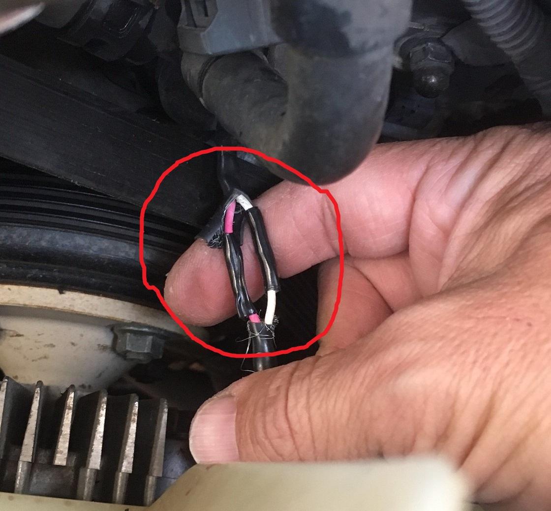

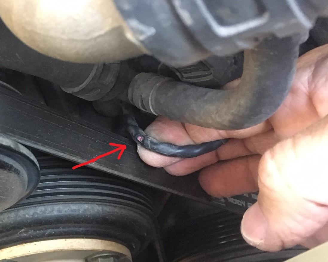

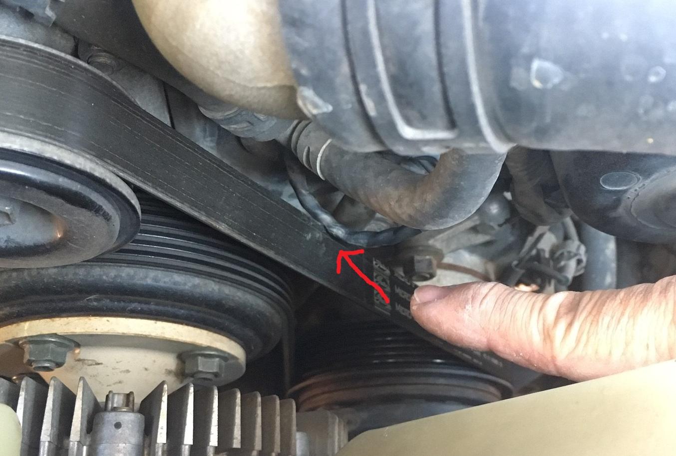

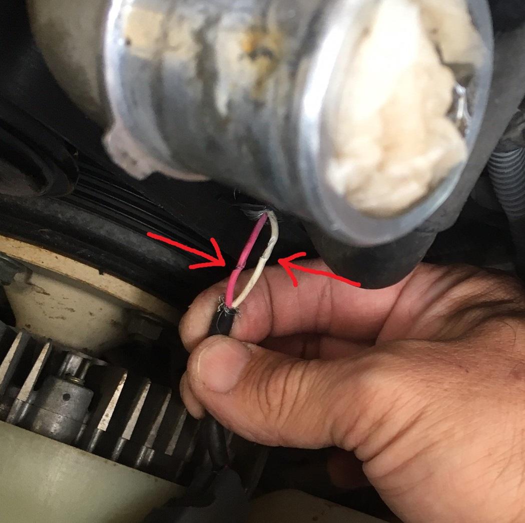

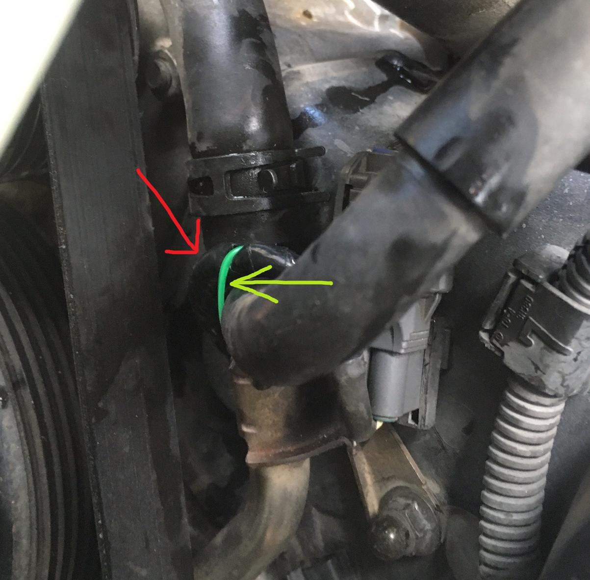

Here are some pics of the damage, and the fix. Pretty simple fix, and the only part I had to remove was the upper radiator hose (one side only).
The green arrow in pic #5 points out the green zip-tie I used to prevent the issue from repeating itself.
