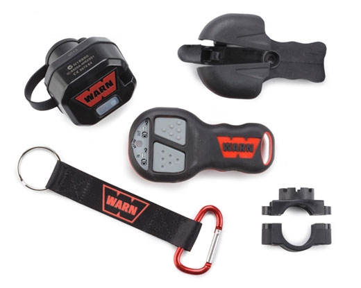

Assuming you have the new style Warn wireless remote like this
Try comparing with the wired remote, how short of a time you can engage the power in (bumping it to snug up to the fairlead).

Has anyone with this wireless controller found a place to mount the holster? I haven't found an exposed pipe to use, and I'm not sure there's a flat surface that I really want to drill into.
How often are you planning to use it? Mine lives loose in my toolbox.

Basically because the wireless remote came with a mounting bracket, I wanted to see if anyone had found a good spot to mount it. Based on what I've read, it sounds like tossing it in the glove box, or center console is the consensus, though.
