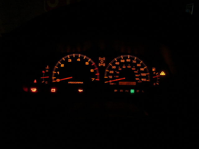

spot on thanks bran52191....finished up in about 30 minutes...i changed the backlight to an orange glow to match my sirius reciever.
heres the finished look. pretty easy to do. you have to really watch not to scratch the ignition plastic as well as the top of the steering wheel when removing the plastic piece.

Damn!!! that looks really good! I've been thinking about changing all of my LED's to white!
Which LED's did you use?
LOL! It was just a thought! Nobody has done white on a 3rd Gen. yet. I'm kind of curious on how it would look. I probably won't do it though...
just some cheapies from autozone...3 something for a pack of two. just remember to get two packs cause you'll need 3 bulbs. also once inside the cluster the bulbs you replace have green knobs.
man i wish my autozone sold colored 24 bulbs. i might have to go back and check so i can save the trouble of ordering offline.
