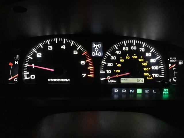

JOB COMPLETE!
Armed with my order from superbrightleds.com, a Phillips screwdriver, a 10mm socket driver and a child's knife from Ikea I was able to access and change all bulbs - thanks to the info and support to the members here [emoji106]
This is on 2/3 dimmed/lit
NdsBWI5isp82IiHNSP9fy5XDqWwFMu9GVQRNE131U6telD35-2wa7Q85z2w9TFTjv_ra14sIL_hssuFgzGz4iHgt6TNlq20j0k-McOLOIVpyjWR7vHshfue8LQYgAgDy75U9OF-Jd6gmmk8IucstP6U3_-wK90TMOD1lZUB0lB6BJ0-y78TSXGotUtjeKzVm3cksuZ5E-aV1WhdIMs1b8ni3Sx8XJQEn4-ElHIevnqPOoCYQ5cC1_IMuuOFRNRTDnIkwlEu_cGnqm6zHpf21Cf7-_aCbHioTsLZR4Voi8Y1u7X-6pJT3NJimUw6f5n5eqKIlaV46eu7MZ29QfVkrpkpGddOuvtIRp_nuBZP3CPlzI1xaXFC5wOQp5peNLaOBgiETYzkC4xDAiaZEFLu2W5tRERuAlKrj6LWfllj1V3r_THzHGz5eMsT5qLazPXcZgoTpBF7r_QfA5jbliO_BoWYGKrGk2WHk7ajxZEEIOlbpY7j7U7jUTZSVXq0t8PeSedkgNaRb1jBqR5CpchbAn-M34YtMFr49CT7c-qcuEcJOkolqZUqUEmyJfSQkIW8rdNWibK_E9o9-Ob3NyQ9L24ziYIXv5fjy=w999-h679-no
Sadly my clock didn't make it to the proverbial summit with me, it won't power on with straight 12v, so I ordered a replacement.
One thing worth noting, the LEDs are polarity sensitive, so I had to trial-and-error about 50% - the ones tach and speedo 3 being the most cumbersome and laborious; but I managed it with patience and a methodical approach to not break or scratch anything.
This handy pic from Yodatech helped me, and although I didn't have the guts to remove the actual circuit board, I was able to swap #22 bulb under the board by removing all the screws and working carefully under it with a hemostat - I always have one handy in the toolkit :)
