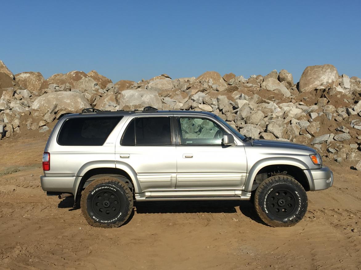

This is a pic of mine with OME 891 rear, Kings coilovers front. Hub to fender in rear is about 22.75”
