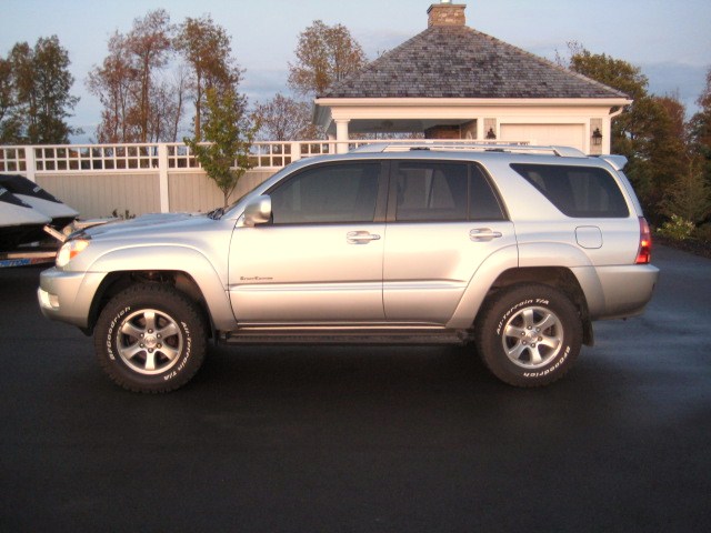

I had this kit installed today. Although I haven't taken any measurements yet, it appears that I got roughly 2" of lift. The truck is leveled out nicely.
The tech that installed the kit said that I shouldn't have any problems with compression, but only time will tell.
Overall, I'm very satisfied with the results.
That looks great!
Do you have rear lifted as well?
Is it a stock size tires?
