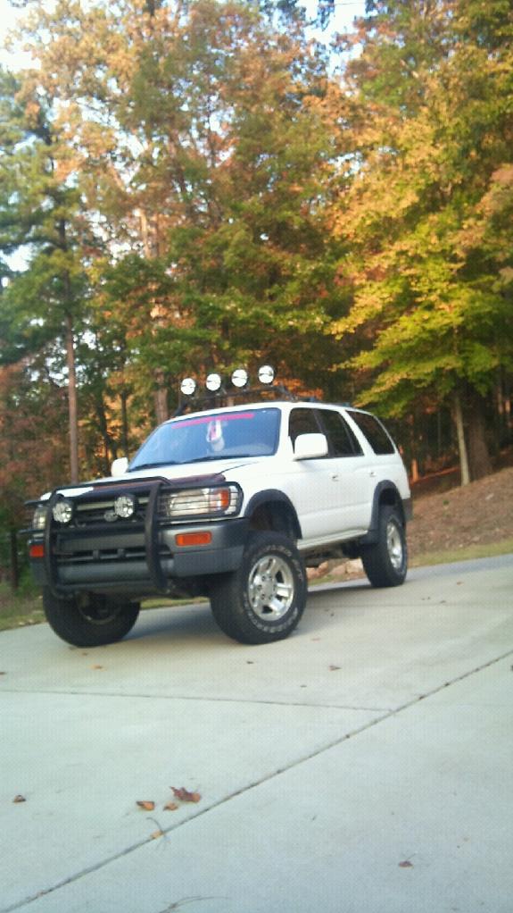

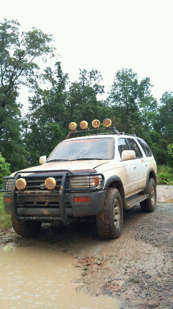

yes it i worth it lifted mine last week with it, noticable lift and it drives just as smooth as it did without ill post before and after pic for you in a bit.
The pic with the mud is before, and the pic clean is after the 2.5 daystar lift. note i did take off the running boards with the lift.
