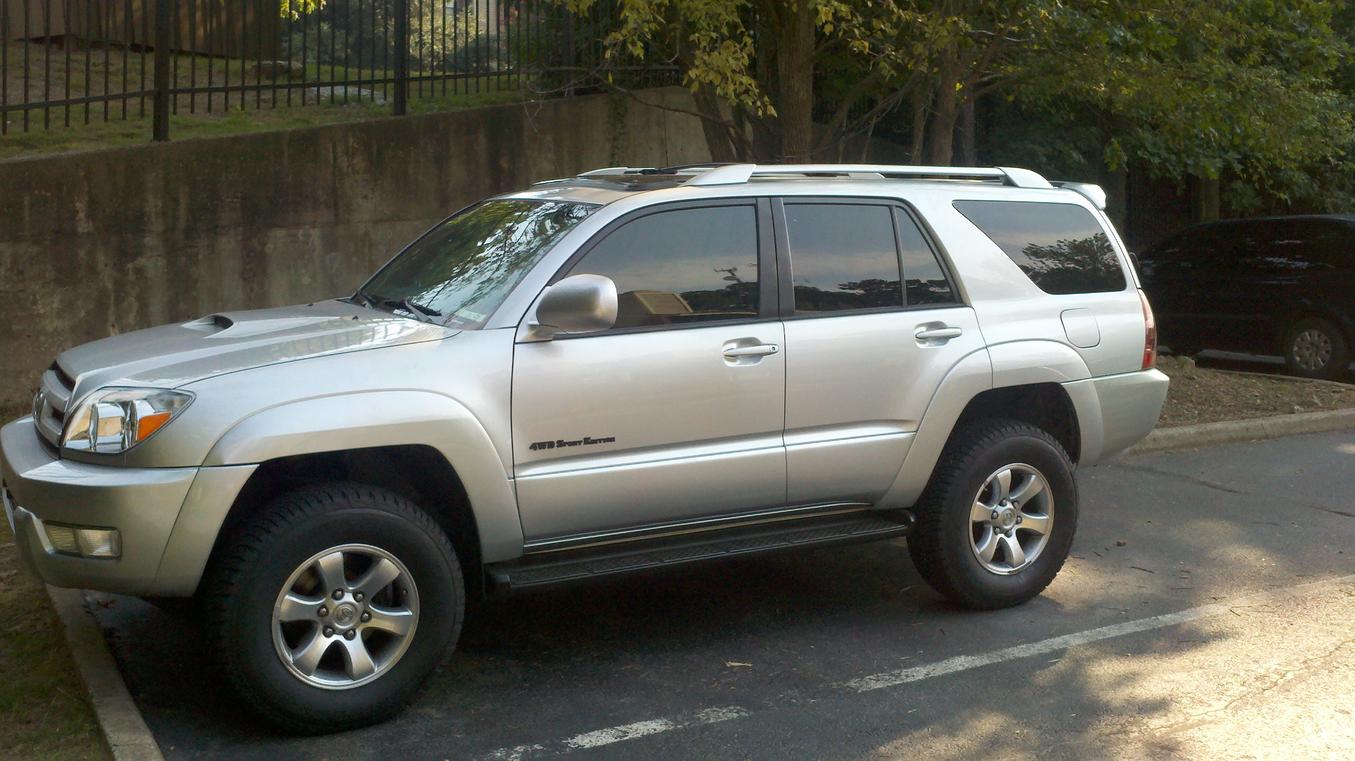

Finally got her all done and aligned.
Unbolted both sides, then bolted one and worked the other through, as in hammered the bolt through the hole and crossed our fingers not to screw up the threads.
Looks nice! Glad it all worked out. I basically did the same thing to the rear as well. Nothing beats some good sledge hammer action :)
