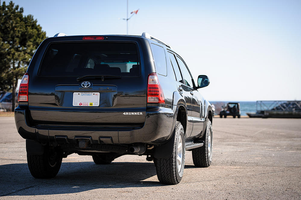

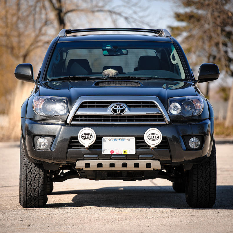

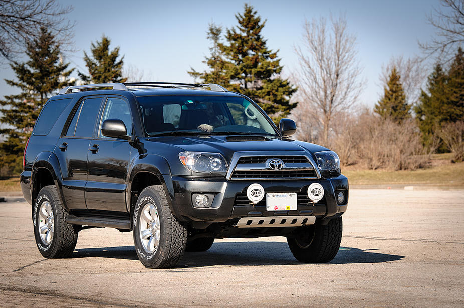

Redid my alignment, checked all the bolts (all tight and no xreas leaks) and inflated the tires to 35psi. Drives much better. Stuff done:
Daystar spacer kit, spidertrax wheel spacers, p265/70R17 revo 2s and blacked-out headlights.

btw, is it sport edition? I know that all SE has tube roof rack and tube step as standard but your car doesn't. However, it does have the hood scoop.
Nice! I've got the same skidplate on mine. Pretty sure it's the Tacoma skid, but I could be wrong. Fits on my 05 Limited, V8.
that skid plate is OEM.
Canadian version of the 2008 4runner sport didn't have tubular rack + step rails ...from what I know no Canadian 4th gen 4runners had those.
Yep, this is true, nor did they come with rear spoilers, only the Limited did.
Looks nice! What daystar lift did you put on and does it
rub at all?
Daystar KT09115BK Comfort Ride 2.5" front, 1.5" rear. It was rubbing because of the wheel spacers.
Today I've moved the inner fender liner forward and trimmed the bumper (bumper wasn't rubbing but it was close). I've use a utility knife for the bumper mod - I was surprised how easily it cuts through the plastic! No need for power tools:)
