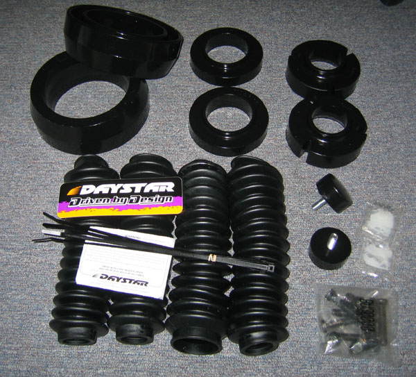

The kit is fairly complete. It looks like it has bump stops too.

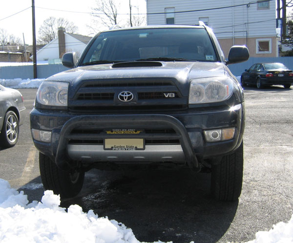

Ok. Here's a front shot. I could definitely tell it's lifted.

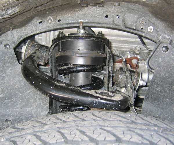

Bulldog - Here you can kinda see what I'm talking about. There's 2 pieces for the front that sandwiches the top strut plate. There's a bushing below the strut plate that is supposed to be replaced with the provided Daystar bushing. I had to cut the inner rubber sleeve so both would fit.
