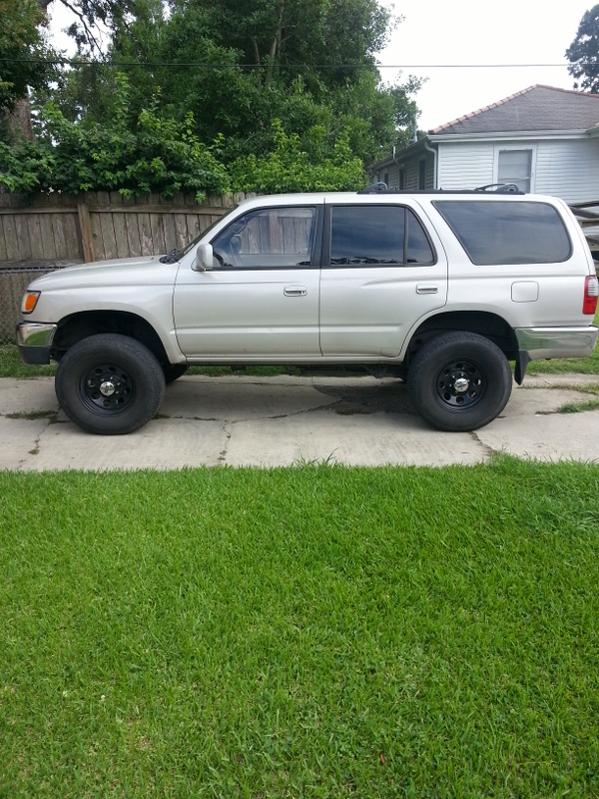

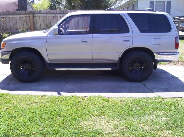

2.5" Daystar Spacer lift with KYB struts/shocks
KYB Gas-a-Just Shocks
Part Numbers:
KG9025 Front End
KG54317 Rear
I'm running 265/75/16 tires.
Before and After Pictures....

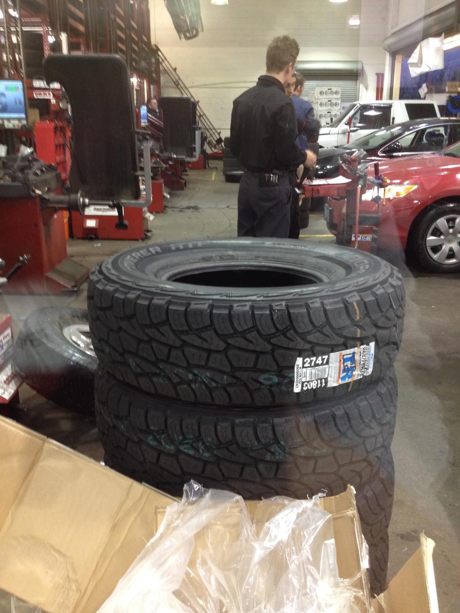

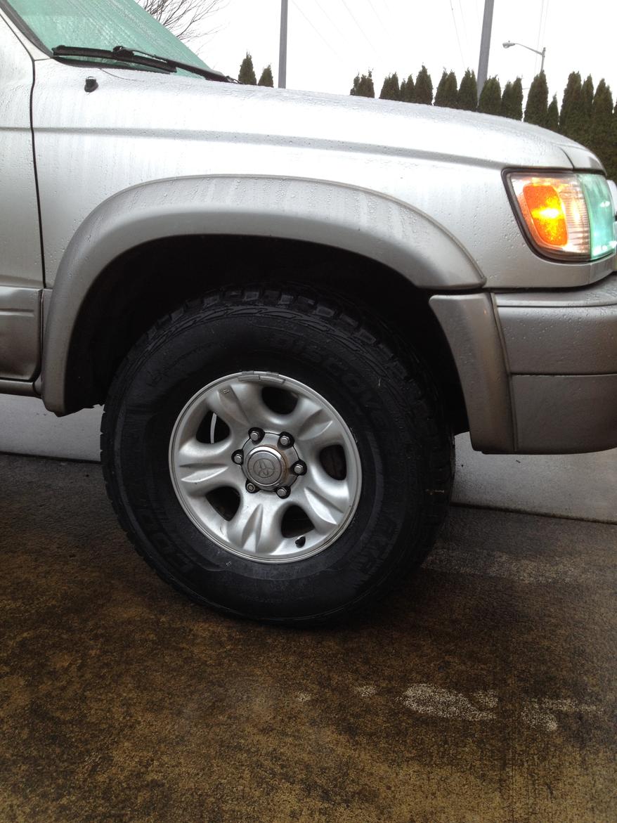

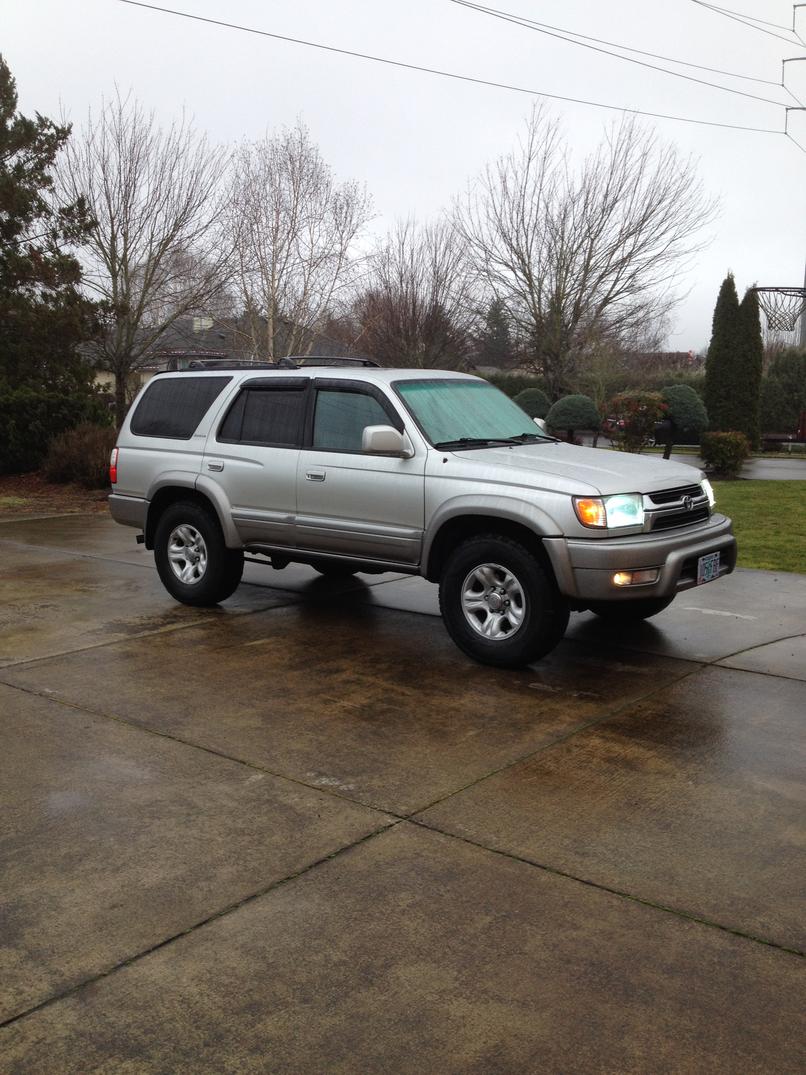

almost ready to put lift on slapped some new rubber on 265/75r16
