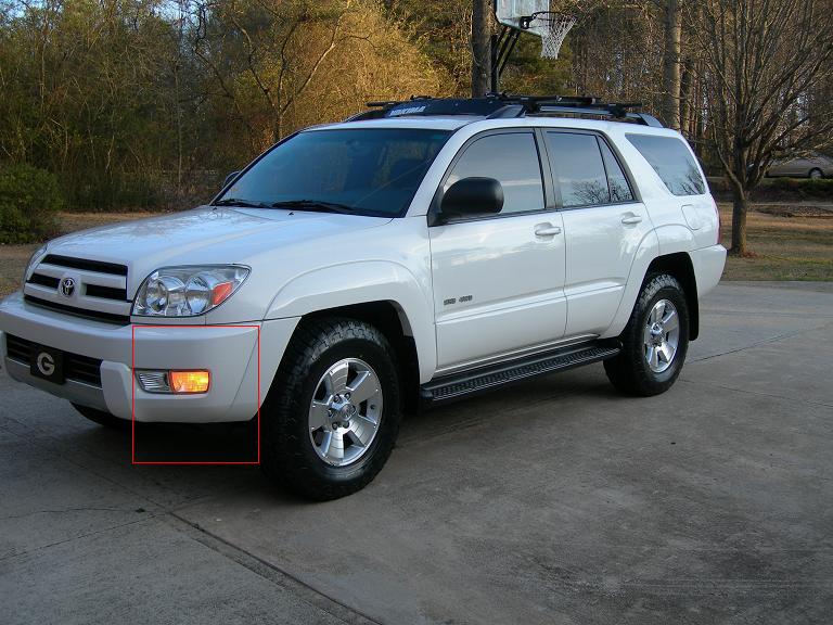

It not my actual headlights it these,
Yes. It's not the actual headlights that are the DRLs on the 4Runner. I think on the 3rd Gen it was the headlights (on a low intensity) but we've got the turn signals as our DRLs. ;)
